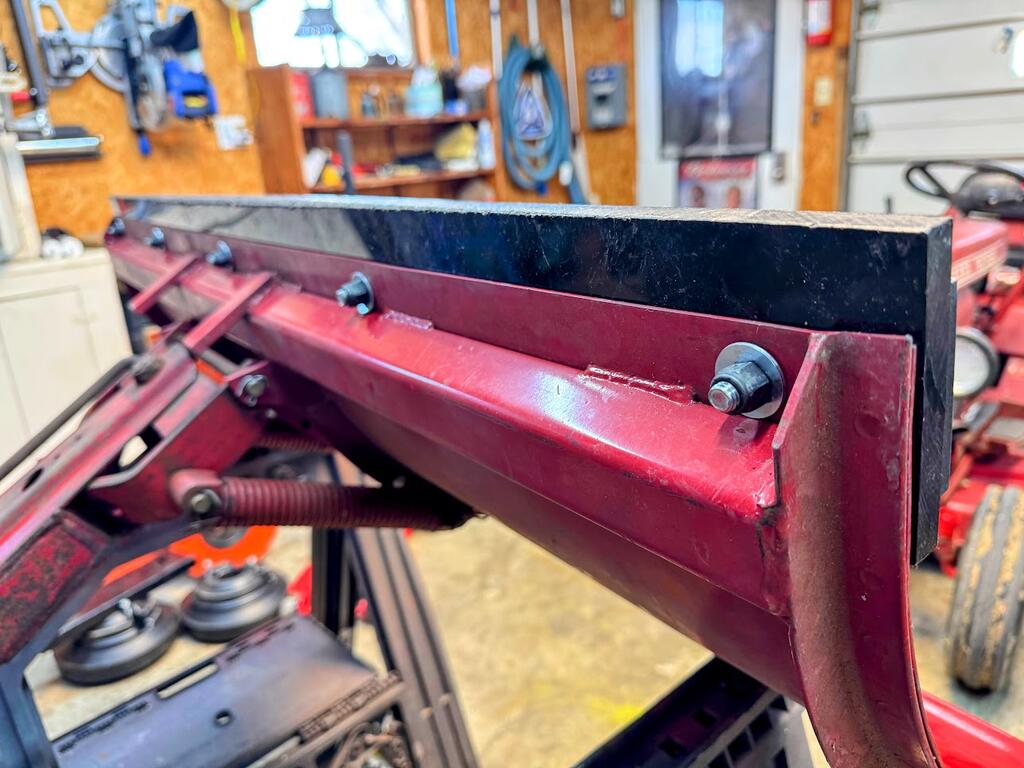

Bar Nuthin 3,645 #153 Posted December 21, 2024 (edited) I had a partial sheet of HDPE plastic, so I cut a strip and put it behind my wear bar - intention is to preserve my blacktop driveway. I gave it a test run scraping off a bazillion ornamental fruit pears (more like berries) off of my drive. It became apparent that my old drive is not very flat, with all sorts of dips and low spots. While it should be fine for plowing snow, once it wears out, I'll replace it with a strip of rubber. Luckily, there are plenty of used horse mats available around here for cheap. Edited December 21, 2024 by Bar Nuthin 1 2 Share this post Link to post Share on other sites

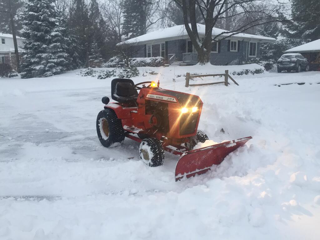

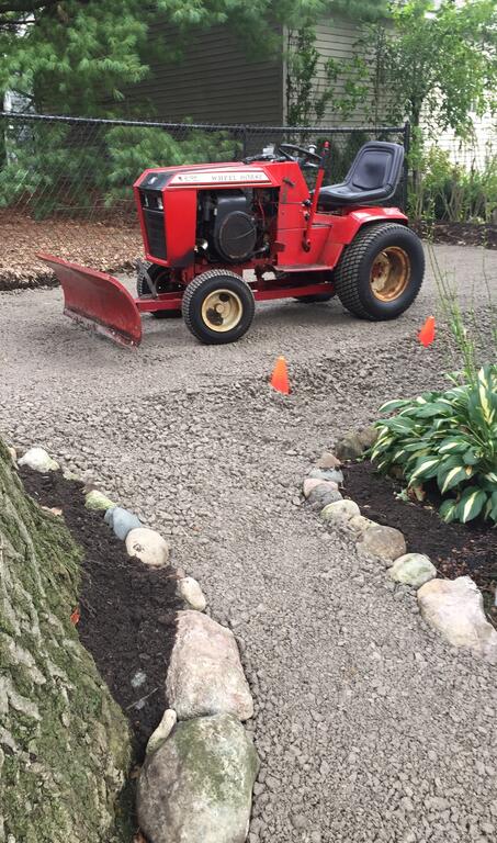

SylvanLakeWH 32,921 #154 Posted December 21, 2024 (edited) 1 hour ago, Alrashid2 said: So just to confirm, bottom hole, which would make the plow the most vertical, is the right way for an uneven driveway No. You want the bottom hole so the top of the plow is leaning away from the tractor, with the bottom closer to the tractor... that way the blade is dragging not digging... less vertical. Like this Edited December 21, 2024 by SylvanLakeWH 2 2 Share this post Link to post Share on other sites

Alrashid2 476 #158 Posted December 22, 2024 4 hours ago, SylvanLakeWH said: No. You want the bottom hole so the top of the plow is leaning away from the tractor, with the bottom closer to the tractor... that way the blade is dragging not digging... less vertical. Like this Ahhh I see now! Not sure why my mind was having a hard time picturing it Thanks for the photos! 2 Share this post Link to post Share on other sites

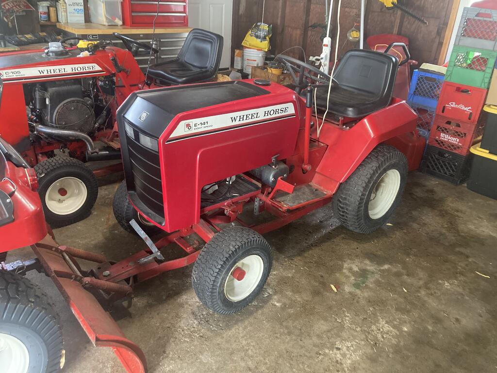

Ed Kennell 47,946 #159 Posted December 22, 2024 14 hours ago, SylvanLakeWH said: I just noticed the blade angle pin puller. Cool idea. Brings back memories of the a plow I had on a 4 wheeler with the same arrangement. 1 1 Share this post Link to post Share on other sites
SylvanLakeWH 32,921 #160 Posted December 22, 2024 41 minutes ago, Ed Kennell said: I just noticed the blade angle pin puller. Cool idea. Brings back memories of the a plow I had on a 4 wheeler with the same arrangement. Thanks Ed. Blade came with no cable, triangle pivot or handle and it was pretty rough. Went with what we had in the "supply room"... Required getting off the tractor to change but it worked... also encouraged me to develop a Zamboni pattern to plowing so I didn't need to get off the tractor too often... Sent that blade along with the E-141's... probably will get a bit less use down in the St. Louis area... 1 1 Share this post Link to post Share on other sites
Ed Kennell 47,946 #161 Posted December 22, 2024 4 minutes ago, SylvanLakeWH said: Required getting off the tractor to change Oh, I thought it was like mine where the lever contacted the frame pulling the pin if the the plow was raised to the max. 1 Share this post Link to post Share on other sites
SylvanLakeWH 32,921 #162 Posted December 22, 2024 1 hour ago, Ed Kennell said: Oh, I thought it was like mine where the lever contacted the frame pulling the pin if the the plow was raised to the max. Nope, but cool idea! 1 Share this post Link to post Share on other sites
