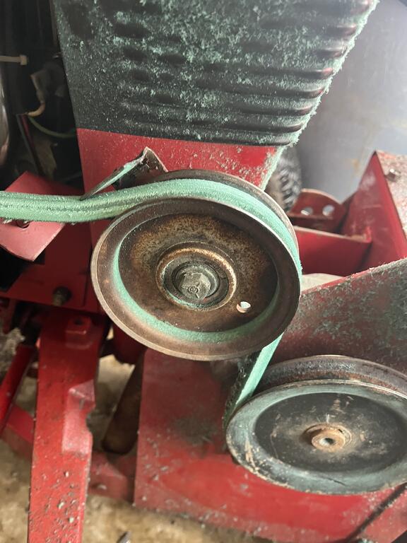

Rockcrawler69 15 #1 Posted December 9, 2024 (edited) Finally got everything together. 1996 520 H with 2 stage snow thrower. For 10 mins I was impressed at how far this thing was throwing slushy snow. Then all of a sudden, it all went to crap🤪 Blower wasn’t lifting anymore and then I looked at my nice new $45 green Gates belt from Napa just turning to powder🤬 Shut the blower down, Got it back to the garage, realized the mid mount fell out, somehow, and my idler pulley decided to somehow allow the belt guide (90* piece of steel) attached to it and start eating my belt.🤬🤬🤬 My question, do I need that little piece of steel on there or can I cut it off? Before I started the day that piece was on the bottom side of the pulley completely out of the way. Not sure if coming out of the mid mount had anything to do with this or not. I’ll put up a couple of other pix. Edited December 9, 2024 by Rockcrawler69 Spelling error Share this post Link to post Share on other sites

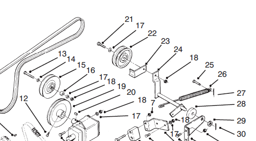

Rockcrawler69 15 #2 Posted December 9, 2024 Picture showing the steal 90 “belt guide” hitting top and bottom of the belt Share this post Link to post Share on other sites
WHX?? 58,388 #3 Posted December 9, 2024 No do not cut it off. They did not put it there because it looks good. It needs to be facing forward I believe. It is held on and in position by the pulley mounting bolt. If the blower dropped out of it's mid bracket all hell could break loose. Finding out why it dropped out might be a bigger concern. On the belt we like to use TSC Huskee belts. Half the price and just as good. NAPA belts and filters are just too dang expensive these days. Share this post Link to post Share on other sites
Rockcrawler69 15 #4 Posted December 9, 2024 Good to know. Thanks WHX. I’ll put the bracket in the forward position and see what’s going on in the mid mount. 2 Share this post Link to post Share on other sites
ebinmaine 81,282 #5 Posted December 9, 2024 6 hours ago, Rockcrawler69 said: see what’s going on in the mid mount Check to see if there's a hole for a locking pin. Share this post Link to post Share on other sites
Red-Bovine 337 #6 Posted December 9, 2024 Yes, that part should be pointing forward. 2 Share this post Link to post Share on other sites

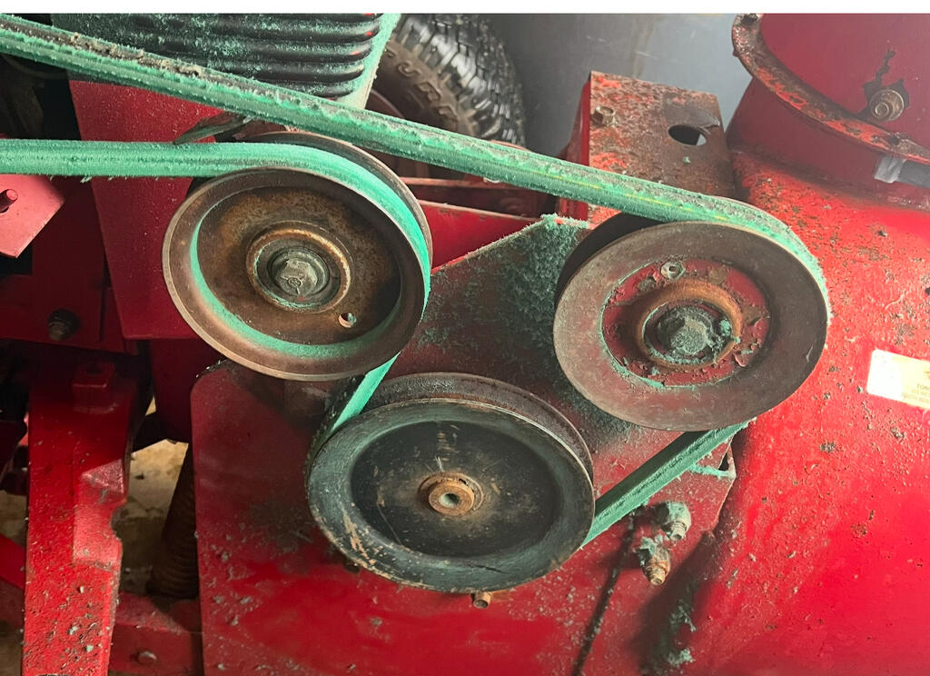

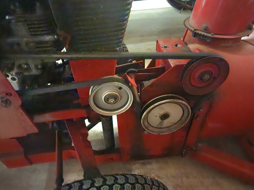

Red-Bovine 337 #7 Posted December 9, 2024 Here are som epics of correct belt route and part from both sides. 2 Share this post Link to post Share on other sites

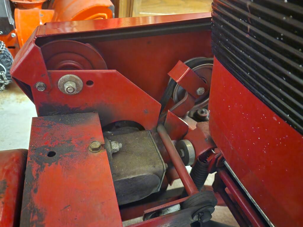

Red-Bovine 337 #8 Posted December 9, 2024 Back side. 3 Share this post Link to post Share on other sites

peter lena 10,125 #10 Posted December 9, 2024 @Rockcrawler69 done a lot of experimentation on W/H belt driven anything , number one is bearing lubrication failure , that belt fraying , is showing you the poor rotational function resistance , personally have cleaned out and re greased , any idler type pulley I had also you can make up a duplicate , with a larger bearing , insert at tractor supply . the difference in any movement detailing , is amazing , smooth , quiet , easy moving . bet your PTO LEVER ENGAGEMENT is also anything but quiet , smooth easy . since doing that to my horses , belt driven anything is my first change out, this basic also refers to mower deck bearings , same lubrication failure . my PTO belt drive , down to unit , moves easily by hand , thats your failure area , showing itself , with rough belt fraying resistance . wide rubber bearing grease shields , are easily removed , cleaned out , lucas green chassis grease , 550 deg flash point , as said my drive belt , moves by hand , no squealing . screaming , resistance , bet the bearings are shot / rough . pete 1 Share this post Link to post Share on other sites
WHX?? 58,388 #11 Posted December 9, 2024 In case you have not met Pete Crawler there is not a door in his house that squeaks... 1 3 Share this post Link to post Share on other sites
Rockcrawler69 15 #12 Posted December 10, 2024 20 hours ago, ebinmaine said: Check to see if there's a hole for a locking pin. There is. I remembered taking the mower deck off and there was one on there. I'll definitely be putting that back in! Thanks! 1 Share this post Link to post Share on other sites
Rockcrawler69 15 #13 Posted December 10, 2024 14 hours ago, peter lena said: @Rockcrawler69 done a lot of experimentation on W/H belt driven anything , number one is bearing lubrication failure , that belt fraying , is showing you the poor rotational function resistance , personally have cleaned out and re greased , any idler type pulley I had also you can make up a duplicate , with a larger bearing , insert at tractor supply . the difference in any movement detailing , is amazing , smooth , quiet , easy moving . bet your PTO LEVER ENGAGEMENT is also anything but quiet , smooth easy . since doing that to my horses , belt driven anything is my first change out, this basic also refers to mower deck bearings , same lubrication failure . my PTO belt drive , down to unit , moves easily by hand , thats your failure area , showing itself , with rough belt fraying resistance . wide rubber bearing grease shields , are easily removed , cleaned out , lucas green chassis grease , 550 deg flash point , as said my drive belt , moves by hand , no squealing . screaming , resistance , bet the bearings are shot / rough . pete Thank you Pete. I'll tear into this weekend! 1 Share this post Link to post Share on other sites
