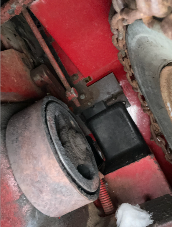

Glenn_K 3 #1 Posted December 7, 2024 Hello and thank you for accepting me to the forum. I've been using this Wheel Horse for a couple years to clear snow, it runs like a tank but a transmission issue just developed over the last few days. The part shown in the below picture (the part is just inside the left rear wheel) has been overheating very badly and creating a burning smell. This seems to only happen when i'm driving the tractor; it doesn't happen if the tractor is not moving w the PTO engaged. The transmission looks like it needs an oil change (the oil is milky looking). Could a transmission oil change be the solution or is the problem possibly something else? -- Glenn tractor hot spot.HEIC Share this post Link to post Share on other sites
Glenn_K 3 #2 Posted December 7, 2024 Inline picture of the overheating part Share this post Link to post Share on other sites
ri702bill 11,340 #3 Posted December 7, 2024 Glenn - Welcome!!. The oart shown is the brake assembly; the rotating drum and the fixed band. A mis-adjusted brake band will drag and create excess friction - and the burning smell. Share this post Link to post Share on other sites
Ed Kennell 44,986 #4 Posted December 7, 2024 (edited) to the As Bill said, the brake band probably needs adjusted or replaced. The milky transmission fluid indicates it contains water and should be changed ASAP. Edited December 7, 2024 by Ed Kennell wrong tranny 1 1 Share this post Link to post Share on other sites

Brockport Bill 2,226 #8 Posted December 7, 2024 milky tranny oil suggests either condensation inside or a bad shift handle boot and rain water getting in? Suggest you flush the tranny once first before you put in new oil - use kerosene or deisel for flush if its a gear tranny 3 Share this post Link to post Share on other sites

Lee1977 7,564 #11 Posted December 8, 2024 If the brake band is getting hot it is adjusted too tight need to be loosened up. It could need a new lining. The adjustment looser or tighter on the drum does not effect brakeing it only moves the placement of the brake pedal. It should be adjusted so it's loose enough to not get hot and that the parking brake still works. Too tight the parking brake won't lock in . Share this post Link to post Share on other sites
oliver2-44 11,248 #12 Posted December 8, 2024 When you drain the transmission oil jack the front of the tractor up as high as you safely can. The transmission has a hun in thee bottom center of it that prevents it from draining fully. 2 1 Share this post Link to post Share on other sites
Glenn_K 3 #13 Posted December 9, 2024 (edited) Thank you all for the warm welcome and for the information, as said, it was a brake issue -- the parking brake handle was stuck in a slightly engaged position and all that was needed was to unstick and then the tractor ran fine. There a small engine fixit guy in the family who is going to help me change the transmission oil. -- Glenn Edited December 9, 2024 by Glenn_K 3 Share this post Link to post Share on other sites
