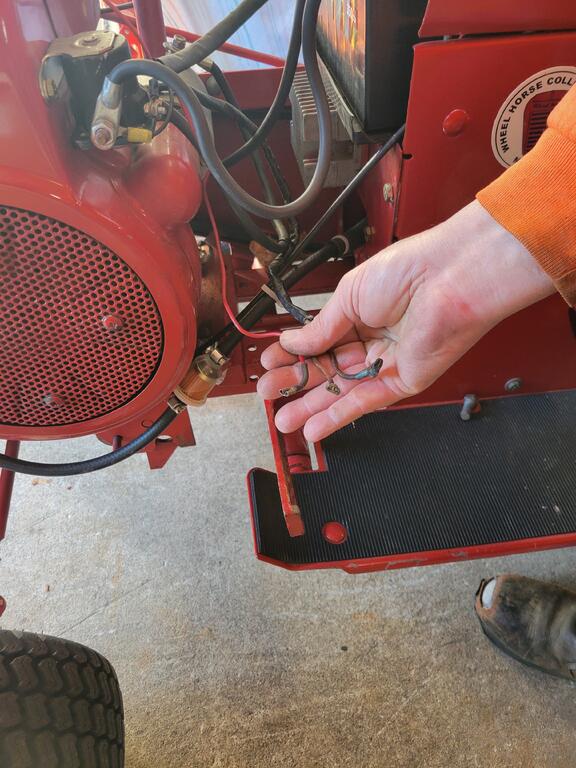

mrc 1,119 #1 Posted December 6, 2024 (edited) while servicing my SIL's C161 i found these 3 wires just dangling in midair. obviously they go to the regulator. which wire goes on what regulator terminal? i do not want to hook it up wrong and fry the regulator. is there a single plug i could get? thank you mike Edited December 6, 2024 by mrc pic Share this post Link to post Share on other sites

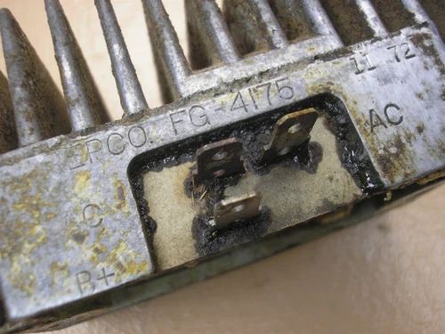

953 nut 69,380 #3 Posted December 6, 2024 Your voltage regulator will have two side by side terminals marked AC that will connect to the engine wires and one terminal marked DC that will go up to the ignition switch. If the connector are not good buy some Packard 56 connectors, NAPA or any GOOD auto parts store will stock therm. 2 Share this post Link to post Share on other sites
Ed Kennell 47,380 #4 Posted December 6, 2024 1 hour ago, 953 nut said: Your voltage regulator will have two side by side terminals marked AC that will connect to the engine wires and one terminal marked DC that will go up to the ignition switch. If the connector are not good buy some Packard 56 connectors, NAPA or any GOOD auto parts store will stock therm. Yes, might just add, it doesn't matter which AC wire goes on each terminal. 2 Share this post Link to post Share on other sites

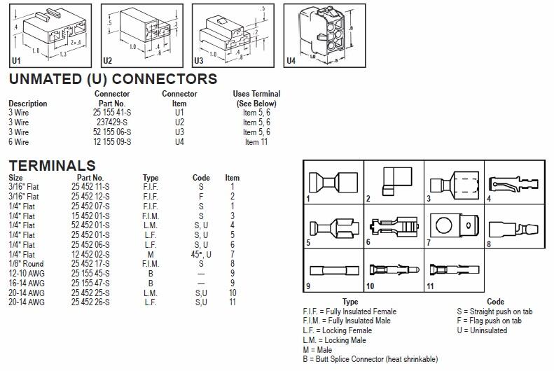

gwest_ca-(File Mod) 12,488 #5 Posted December 6, 2024 Item 26 is the 101476 original regulator connector but no longer available from Toro. A least it gives you the original number to chaise down. https://www.partstree.com/models/81-16b801-c-161-toro-lawn-tractor-1978/electrical-system-single-cylinder-models-16/ This from the Kohler accessory catalog Looks like U2 is the one needed Kohler part number 237429-S but also no longer available. https://www.partstree.com/parts/kohler-237429-s/ Good used may be the quickest to find. I am sure it is available new from somewhere. Share this post Link to post Share on other sites

rmaynard 17,582 #7 Posted December 6, 2024 There should be 2 white wires. They go to the terminals marked AC. The other wire goes to B+ (DC). Share this post Link to post Share on other sites
WHX?? 58,163 #8 Posted December 7, 2024 (edited) You can just skip the plug and crimp on 1/4 female spades & tie wrap up securely. I prefer full insulated ones for this method. While yer at it secure up that dangly fuel line ... don't want that getting snagged on something ... Edited December 7, 2024 by WHX?? 4 Share this post Link to post Share on other sites

mrc 1,119 #12 Posted December 7, 2024 i appreciate all the help. sooo... the red wire in the pic goes to the coil. does that wire go to the B+ terminal on the regulator? then the other 2 wires go to the AC terminals on the regulator correct? and it does not matter which wire to which terminal? because it is AC? thank you mike 1 Share this post Link to post Share on other sites
WHX?? 58,163 #13 Posted December 7, 2024 (edited) Yep ... the two in the harness are the AC wires. Looks like you have enough to cut back to good wire. Yes does not matter which wire goes where as long as both are on the side by side AC posts. The red is the B+ and should end up back to the battery +. Often through a amp meter and/or the ignition switch. Not a bad idea to put a fuse on that one. Edited December 7, 2024 by WHX?? 1 Share this post Link to post Share on other sites
