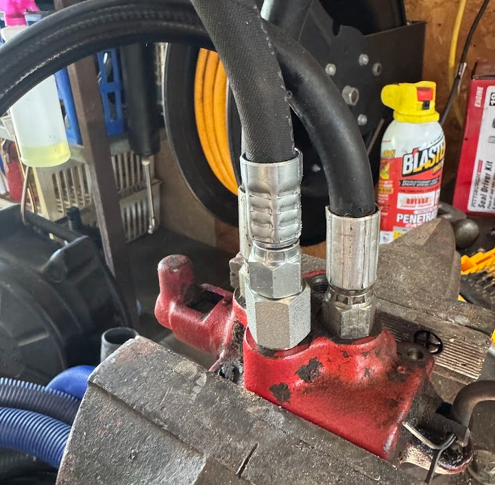

wheelhorseman 3,256 #51 Posted July 13, 2025 The hoses you have have number five fittings on them so you would need a #6 male to #5 female adapter to get them to work 1 Share this post Link to post Share on other sites
Bar Nuthin 2,319 #52 Posted July 13, 2025 3 minutes ago, wheelhorseman said: The hoses you have have number five fittings on them so you would need a #6 male to #5 female adapter to get them to work The hoses I bought have larger fittings than will fit into the control head. They fit fine at the pump. #103213 / #103214 Pump Replacement Hydraulic Hoses for C-160 Wheel Horse Share this post Link to post Share on other sites
pfrederi 20,317 #53 Posted July 13, 2025 FYI to aide in identifying fittings SAE# 5 ORB have 1/2" NF Threads 20 TPI SAE# 6 ORB 9/16" NF Threads 18 TPI 2 Share this post Link to post Share on other sites
Bar Nuthin 2,319 #54 Posted July 16, 2025 It looks like these adapters will work nicely to go from ORB-6 down to ORB-5. Any advice on how to purge the air from the system? I'll probably finish assembling tonight. Share this post Link to post Share on other sites
ebinmaine 78,365 #55 Posted July 16, 2025 10 minutes ago, Bar Nuthin said: It looks like these adapters will work nicely to go from ORB-6 down to ORB-5. Any advice on how to purge the air from the system? I'll probably finish assembling tonight. Should self purge. Just use the up/down a few times and drive around. Check and top off fluid. 2 Share this post Link to post Share on other sites
