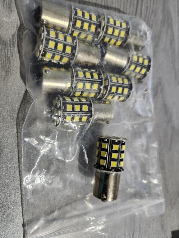

Racinbob 13,290 #27 Posted December 3, 2024 (edited) If you're talking about the screws on the bezel that's not really a good idea. Those are intended to hold the bezel on and do nothing for the poor hinge connection unless you run a ground from the housing to the frame which is....jumpering the hinge. Tighten them too much and the bezel will suffer. Properly installed the housing is held in place with two pop rivets. If I've removed them replace with steel rivets. Never a hood to housing ground issue. Countless times I've seen obvious issues with the hood hinge only as a ground. It's a lousy connection at best. Jumper it. There are gazillions of direct replacement bulbs out there. I purchased a package of ten of these for cheap and they work great. Goofy thing is, I haven't used the headlights for years. Edited December 3, 2024 by Racinbob 4 Share this post Link to post Share on other sites

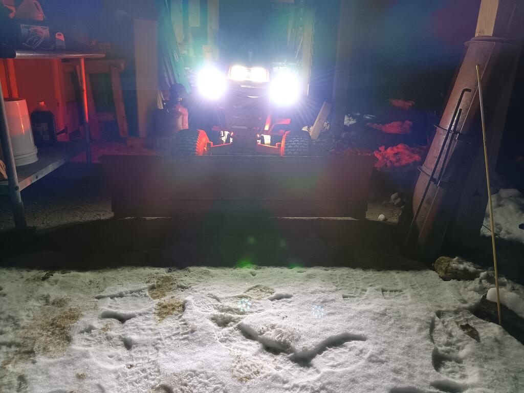

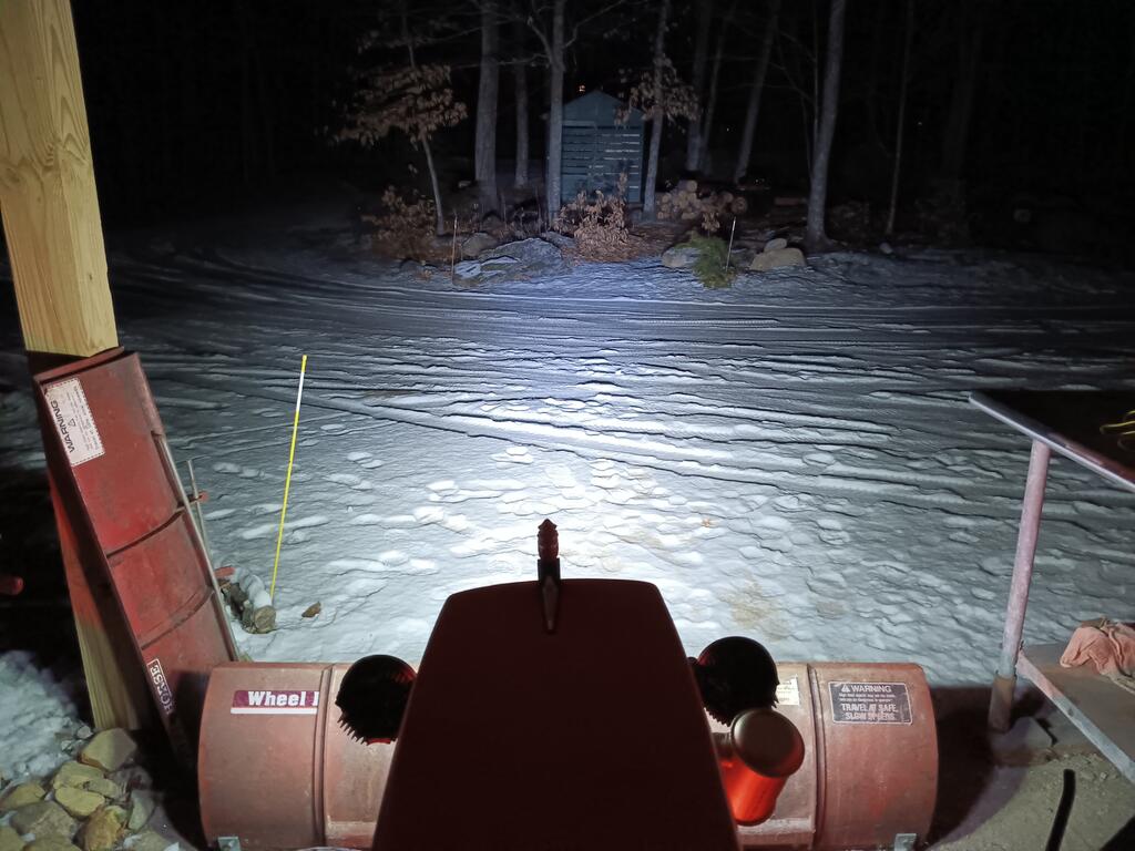

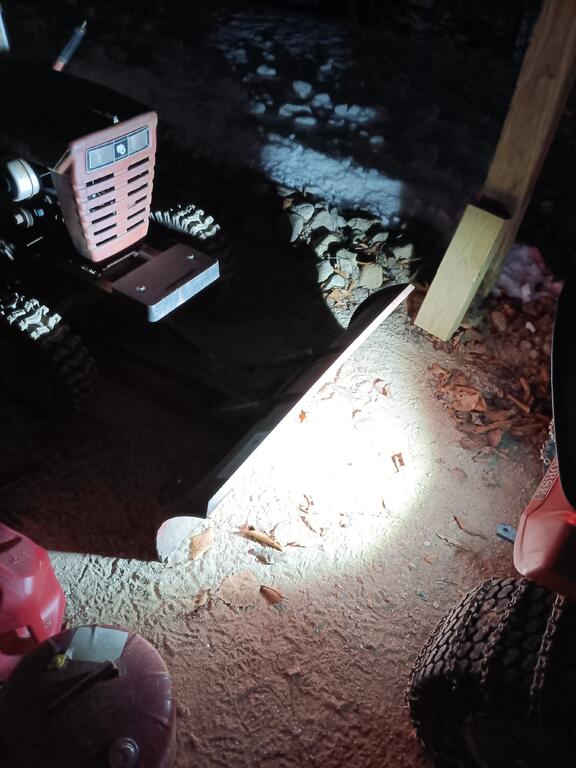

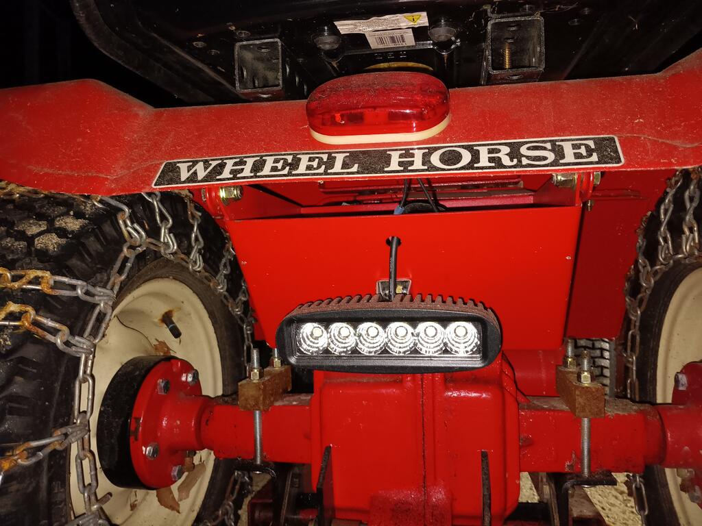

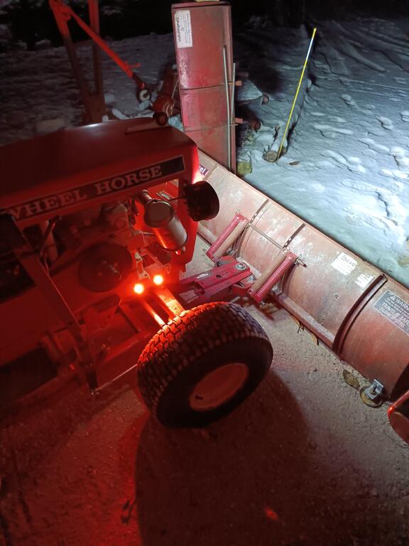

ebinmaine 81,282 #29 Posted December 4, 2024 @fourwheelhorseman I finally got a minute in the in the dark to get some comparison pics of my snow plow tractor's LED lights. @Easton Rich I believe you'd be interested here too. Dark to light on the side. The back. And the front. 1 1 Share this post Link to post Share on other sites

kpinnc 19,107 #31 Posted December 4, 2024 22 minutes ago, ebinmaine said: And the front. Ah so you did try it?!? 2 Share this post Link to post Share on other sites

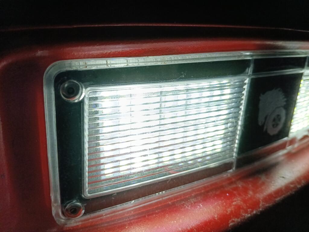

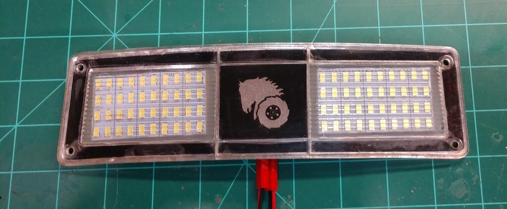

kpinnc 19,107 #36 Posted December 4, 2024 13 hours ago, fourwheelhorseman said: You guys are going to have to show a detailed thread on what these are, I have the individual ones.. there not bad, but I bet these are really good! The first page of the LED thread I linked above shows how they are made. They are hot glued to the lens (as it can be completely removed if needed). Look at post #8 in that thread. 1 Share this post Link to post Share on other sites
