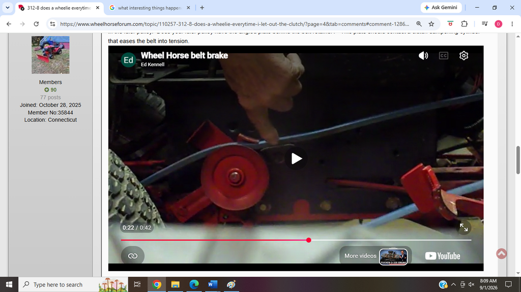

1987_WHEEHORSE312 95 #79 Posted September 1 On 11/22/2024 at 3:58 PM, Ed Kennell said: The clutch on my 310-8 works perfectly. The clutch can be eased in with no grabbing. I use the TSC wrapped belts. Note the amount of travel in the idler pulley. Does your idler pulley have the angled plate behind the belt retainer? This plate should contact a clutch dampening cylinder that eases the belt into tension. What size belt did you use? I just replaced my belt on my 312 with a tsc belt and now I have the similar issue as the OP. Share this post Link to post Share on other sites

Ed Kennell 47,619 #81 Posted September 1 9 hours ago, 1987_WHEEHORSE312 said: What size belt did you use? I just replaced my belt on my 312 with a tsc belt and now I have the similar issue as the OP. TSC 5/8 X 82 Aramid blue belt works great on my 310-8. Mine does have the clutch damper cylinder on the idler pulley, but I'm not sure the damper does anything as I can feel and feather the clutch with my foot. 1 Share this post Link to post Share on other sites
953 nut 69,842 #82 Posted September 1 @Ed Kennell, get your finger out of there, you are making me nervous! 3 Share this post Link to post Share on other sites

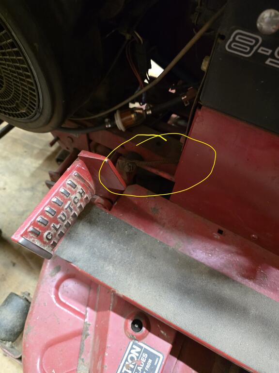

1987_WHEEHORSE312 95 #83 Posted September 1 37 minutes ago, Ed Kennell said: TSC 5/8 X 82 Aramid blue belt works great on my 310-8. Mine does have the clutch damper cylinder on the idler pulley, but I'm not sure the damper does anything as I can feel and feather the clutch with my foot. Ok so I have the same belt you have, so I know the belt size is okay. I also found a spring that goes from the actual clutch pedal and attaches behind the dashboard. I assume that was someone's backyard fix to the blown out strut on the clutch. I have a new correct spring clutch coming in from Wheelhorse parts and more today, so ill install that and remove this other spring that is circled in the attached photo. 1 Share this post Link to post Share on other sites

Ed Kennell 47,619 #85 Posted September 1 37 minutes ago, 1987_WHEEHORSE312 said: backyard fix I think you have found the problem. With the spring here, I can see where any slop in the clutch linkage would allow the clutch pulley to engage and grab. Share this post Link to post Share on other sites
1987_WHEEHORSE312 95 #86 Posted September 1 1 minute ago, Ed Kennell said: I think you have found the problem. With the spring here, I can see where any slop in the clutch linkage would allow the clutch pulley to engage and grab. Yea the correct spring that goes from the linkage to the trans will be here tonight so after I swap them as long as the rain calms down ill test it and report back. 1 1 Share this post Link to post Share on other sites
1987_WHEEHORSE312 95 #87 Posted September 2 11 hours ago, Ed Kennell said: I think you have found the problem. With the spring here, I can see where any slop in the clutch linkage would allow the clutch pulley to engage and grab. Yup! The correct spring did the trick! I think i am also used to the worn belt that was slipping, the as well as the worn strut. Now it feels like a true tractor not a lawn mower from lowes any more. 1 1 Share this post Link to post Share on other sites
