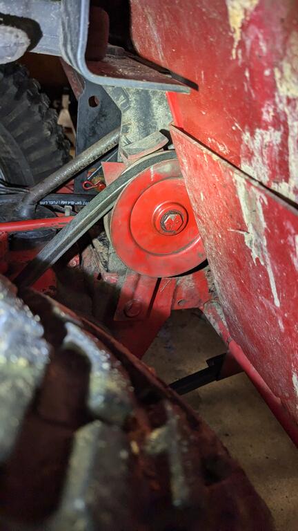

Alrashid2 476 #26 Posted November 22, 2024 Thanks for sharing that Ed. Thats curious... I don't have video but it looks like mine doesn't grab and spin the pulleys until the travel is almost complete and the pedal is nearly released. Yours looks to grab almost as soon as it lets go of that stopping point... Share this post Link to post Share on other sites
Ed Kennell 47,619 #27 Posted November 22, 2024 Al, see the edit about the dampening cylinder. Share this post Link to post Share on other sites
Alrashid2 476 #28 Posted November 22, 2024 Mine seems to be missing one of those angled metal pieces when compared to yours? Mine also seems to rest much farther back in tracely 1 Share this post Link to post Share on other sites
Handy Don 17,581 #29 Posted November 22, 2024 (edited) Apologies if someone already mentioned this, but the belt should be fabric covered, not plain rubber. The fabric lengthens the service life AND helps with smoother starts by changing the friction dynamic between the belt and the pulley sheave. Also, as a belt nears end-of-life, the SIDES wear to allow it to go deeper into the pulley sheave (belts DO NOT STRETCH). This can make them grab too. Edited November 22, 2024 by Handy Don 1 Share this post Link to post Share on other sites
Ed Kennell 47,619 #30 Posted November 22, 2024 4 minutes ago, Alrashid2 said: Yours looks to grab almost as soon as it lets go of that stopping point... The belt does move as soon as the belt brake is released, but that is because the transmission is not in gear therefore there is no resistance on the tranny input pulley. When it is in gear, the belt does not move until the idler pulley tightens the belt. 1 Share this post Link to post Share on other sites
Alrashid2 476 #31 Posted November 22, 2024 I'm very perplexed. Just can't seem to figure out what is causing this. I wonder if a new belt would help but I'd buying aftermarket. Share this post Link to post Share on other sites
Ed Kennell 47,619 #32 Posted November 22, 2024 6 minutes ago, Alrashid2 said: Mine seems to be missing one of those angled metal pieces when compared to yours? Mine also seems to rest much farther back in tracely Yes, yours does not have the clutch damper like mine and your idler pulley is further back when engaged. Some gear drives also used a gas cylinder instead of a spring to provide the tension on the belt. These clutch cylinders I am sure were an attempt by Wheel Horse to ease this sudden belt engagement problem. My only suggestion would be to buy several different length (+ and - one inch) new belts from TSC and test them. If you keep the belts clean, you can return the unused belts for a full refund. Share this post Link to post Share on other sites

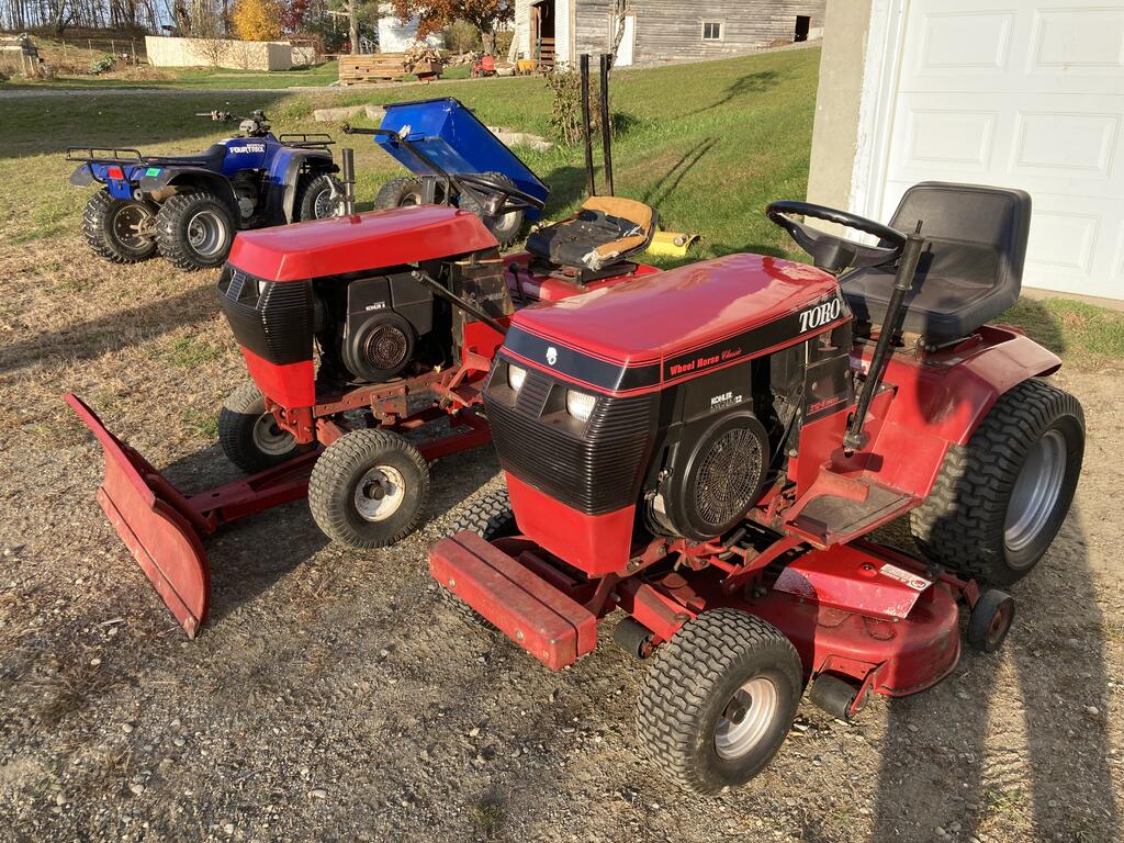

MainelyWheelhorse 3,146 #42 Posted November 23, 2024 (edited) @Alrashid2 I’d run it and get used to it. You’ll eventually find the sweet spot where it just goes. I’ve had mine three years and it still jumps every so often. But, you will get it. The plow does help with weight on the nose and it isn’t so abrupt. Wheelhorse did sell a weight kit for the front that I have on my 312. You probably could make it with some Quick Crete, some long heavy duty bolts to mount the blocks. A 1/4 thick 1 inch flat bar bent into a C to fit the front of the frame. There are some existing mounting holes for 5/16 or bigger bolts and a horizontal quick release bar there. Edited November 23, 2024 by MainelyWheelhorse 1 1 Share this post Link to post Share on other sites

MainelyWheelhorse 3,146 #45 Posted November 23, 2024 (edited) @Alrashid2 A pic of the front weight. The 312 is the tractor on the right. I put the weight on when I had the issue of wheelies like you are having. I think the original owner bought it for counterweight as he was 300+ at the time. Edited November 23, 2024 by MainelyWheelhorse 3 1 Share this post Link to post Share on other sites
