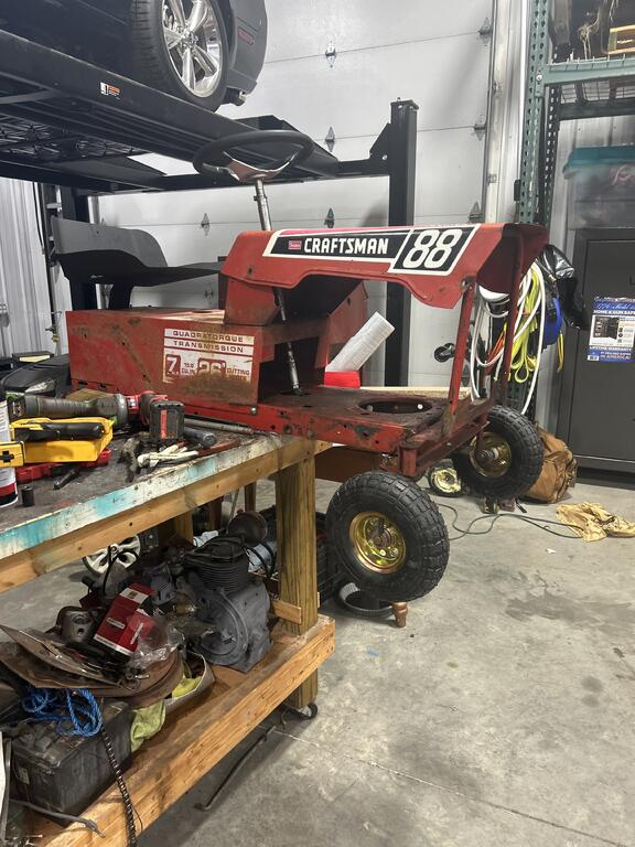

Keaton 466 #44 Posted December 16, 2024 its still coming along, I got my new steering wheel mount and wheel on, I got the gas tank mounted and my chain tensioner done, then I threw the seat and body panels back on for now. I took the gas tank off of my 856 and the belt cover its a parts tractor, or yard art. and I realized that my axle is too long, it is a 1 inch axle but it sticks a foot off the frame on both sides. that's how it looks now, don't mind the mess, that's a weekends worth of working, I got it cleaned up. 2 Share this post Link to post Share on other sites
Keaton 466 #45 Posted December 19, 2024 ive been working more, i have it on saw horses. i put my engine back in tonight, before i had the 2 rear bolts mounted, now i got all 4, for the front holes one of the holes is in the hole were the origonal engine was, so i took a pice of angle iron and that mounts the front 2, they both evenly pull on the angle iron, i will fix it after i get it going and "finalize" stuff then put in a pach and i may keep that pice because that would stregithen the frame a lot, its just as wide as the frame. that may be the last update till christmad when i get parts. merry christmas yall, unless i update before christmas agin 1 Share this post Link to post Share on other sites

Keaton 466 #47 Posted December 22, 2024 i lied, its before christmas. me and my freind had a little christmas, i got some rims and free labor . but we got the tires on and for being almost 2 inches to wide there not bad, I could not get one tire to seal on the bead because china made stuff. the little nubs on the tires were too close to the bead and folded over, I pulled them off with pliers and all good agin, merry Christmas 1 Share this post Link to post Share on other sites
