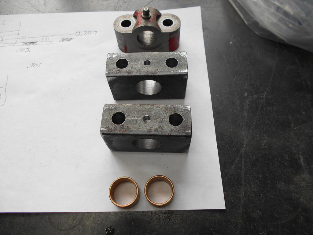

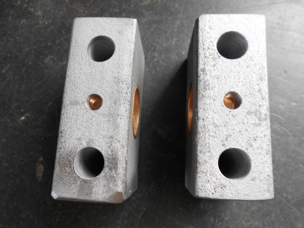

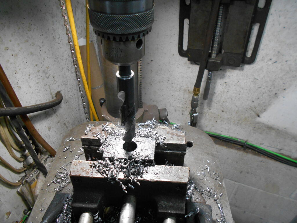

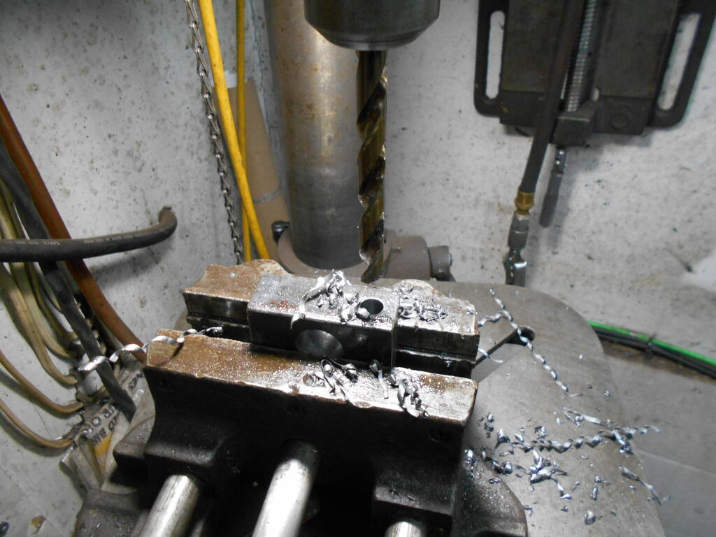

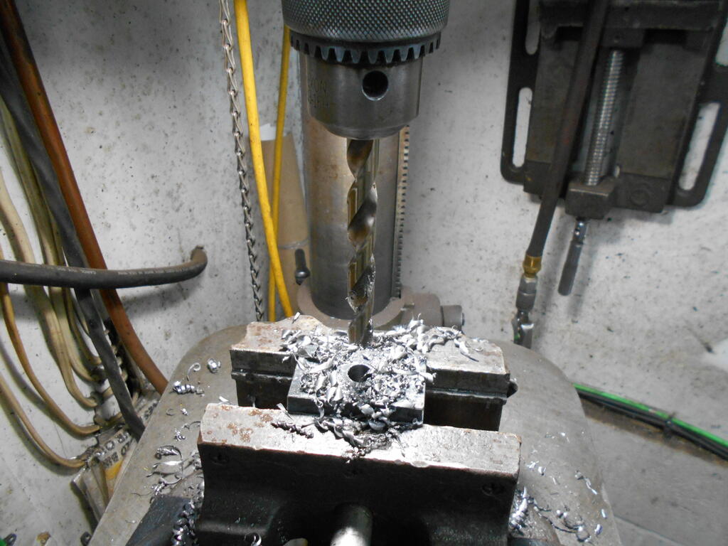

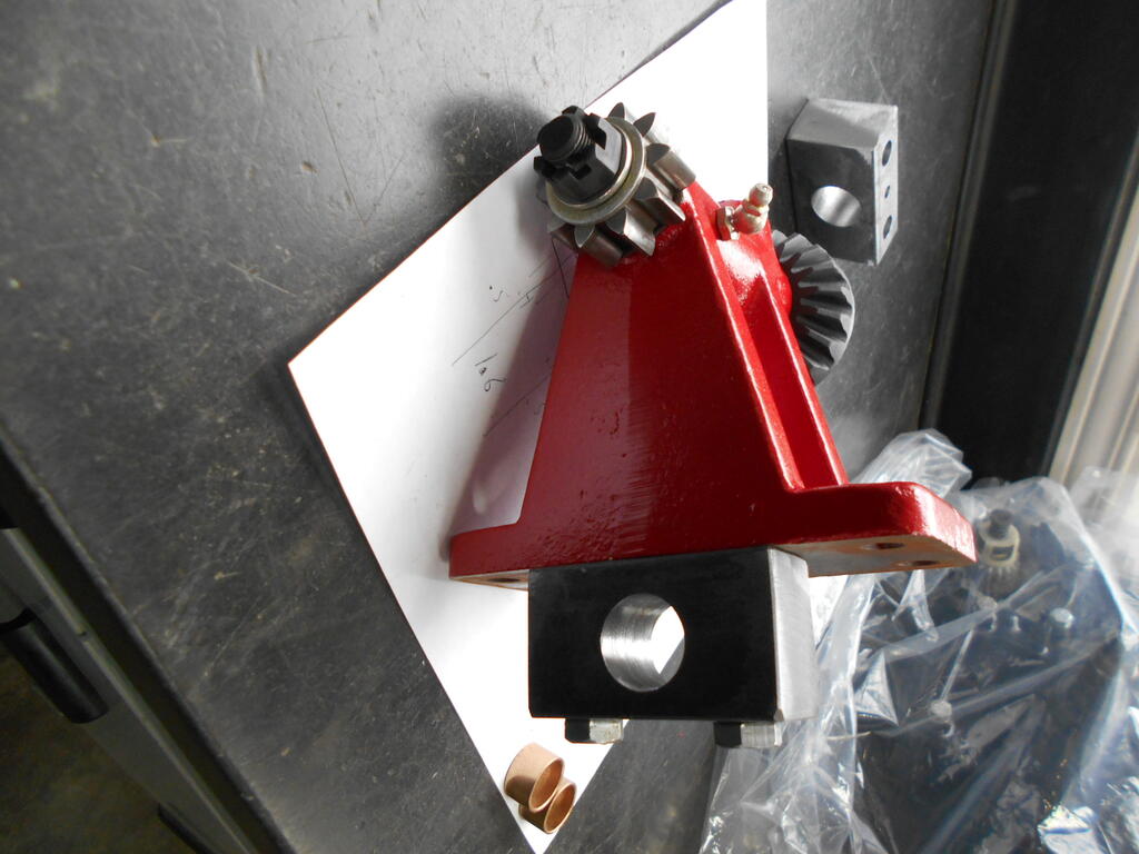

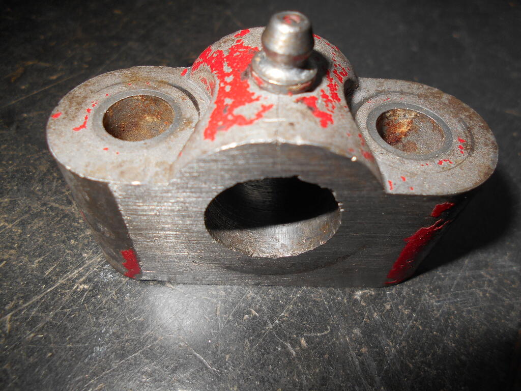

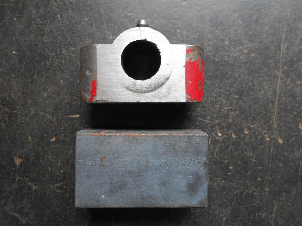

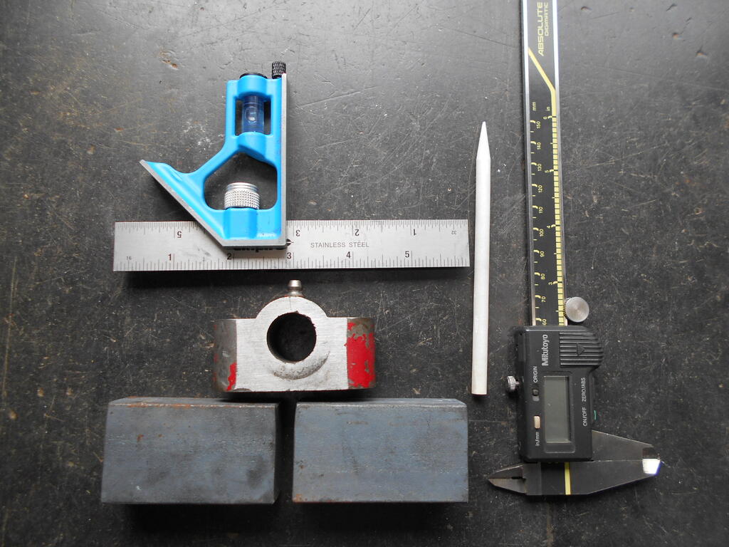

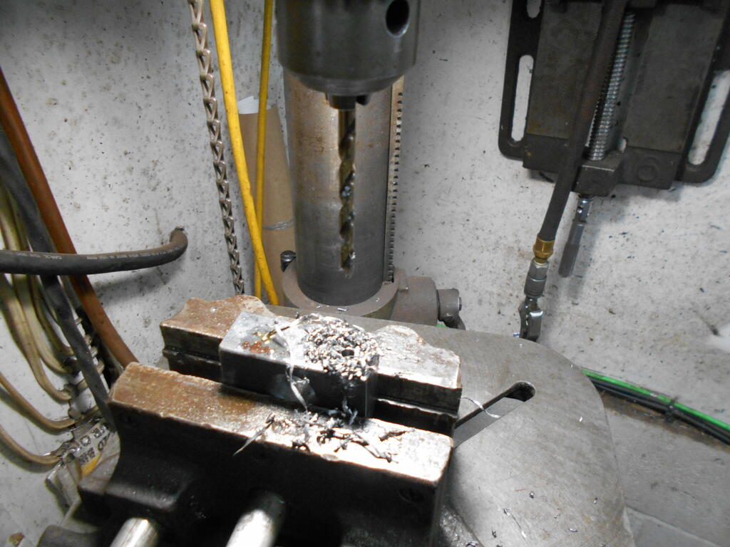

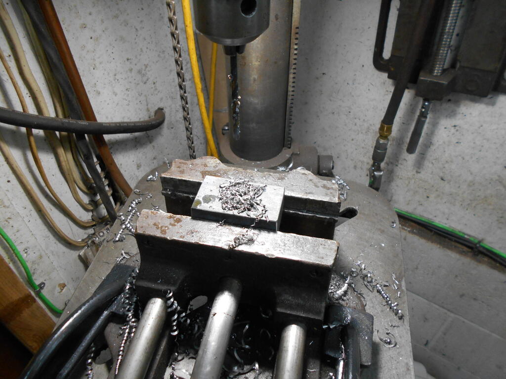

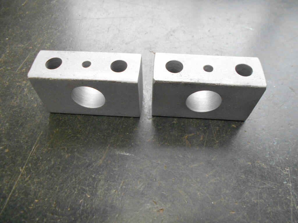

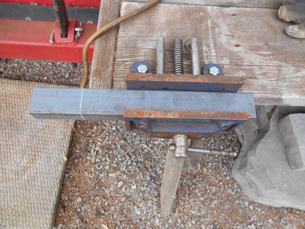

cleat 8,101 #1 Posted November 20, 2024 I have found several of the lower bearing blocks for the reduction steering assembly cracked. Here is one that I have here that is cracked. If the block is worn and you try and drill it for a bushing it also usually cracks so I decided to make my own. I went and bought a short length of 1"x1.5" flat bar (over $20 for that, I guess steel prices must be up). Marked bar then cut off. I then drilled the blanks for the 3/4"x 7/8" bushings that will be installed. Then the holes were drilled for the mounting bolts and grease fitting. Bearing block bolted to steering block for test fit. I now need to order the bushings then I can finish these. 2 10 Share this post Link to post Share on other sites

cleat 8,101 #3 Posted November 20, 2024 5 minutes ago, peter lena said: @cleat awesome job ! can you say lucas x tra hd green chassis grease ? ALSO POLYUREA RATED , so it will stay with it ,always like to over build a problem spot . related front axel and spindle bearings / wheel bearings , like it too . pete I agree. This one came to me cracked. Others arrive worn. Once I repair then I use good quality synthetic grease and basically never have an issue again. I believe the steering block grease fittings on both gear reduction and non gear reduction units get missed by a lot of owners so they just run dry and wear out. 3 Share this post Link to post Share on other sites

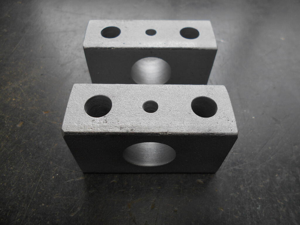

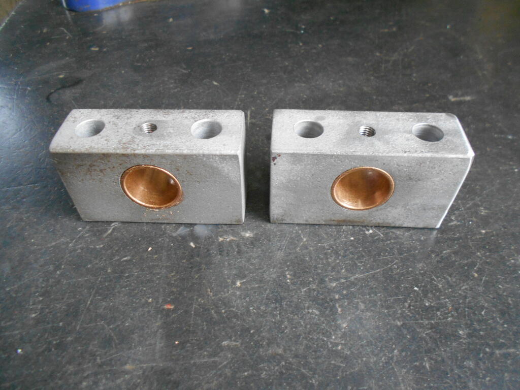

cleat 8,101 #7 Posted November 21, 2024 Blocks bead blasted. 2 3 Share this post Link to post Share on other sites

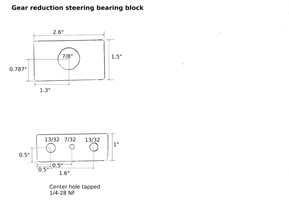

cleat 8,101 #8 Posted November 21, 2024 Here is a quick drawing of the block 5 1 Share this post Link to post Share on other sites
kpinnc 16,224 #9 Posted November 22, 2024 15 hours ago, cleat said: Here is a quick drawing of the block Thank you for sharing this! 2 Share this post Link to post Share on other sites

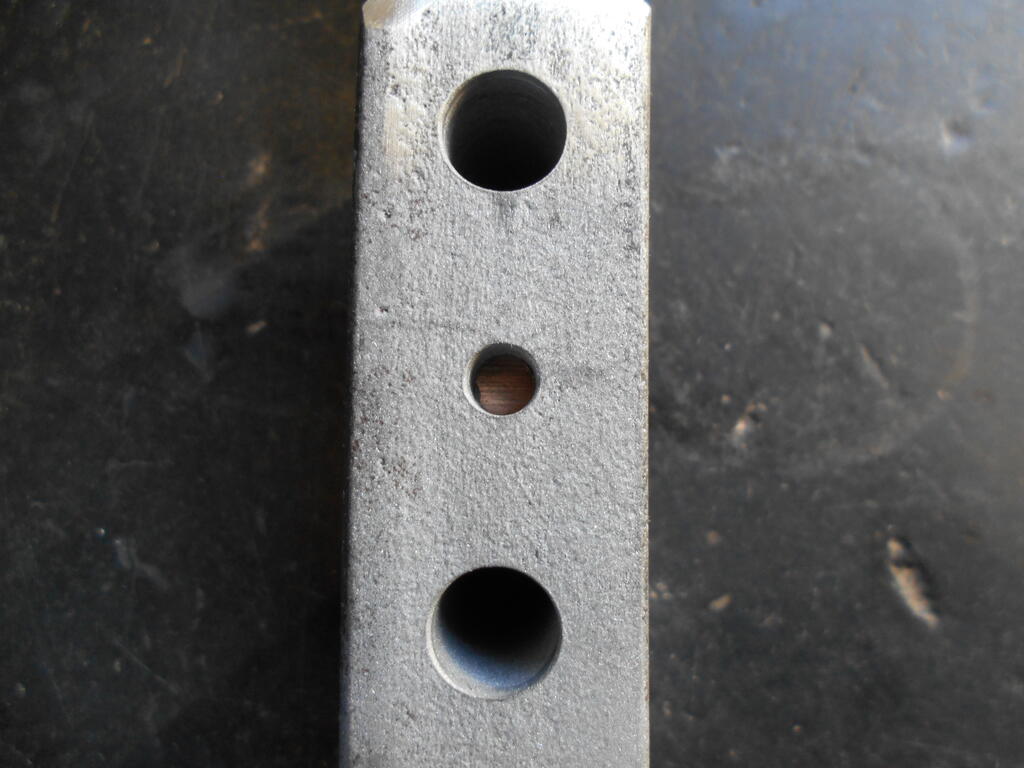

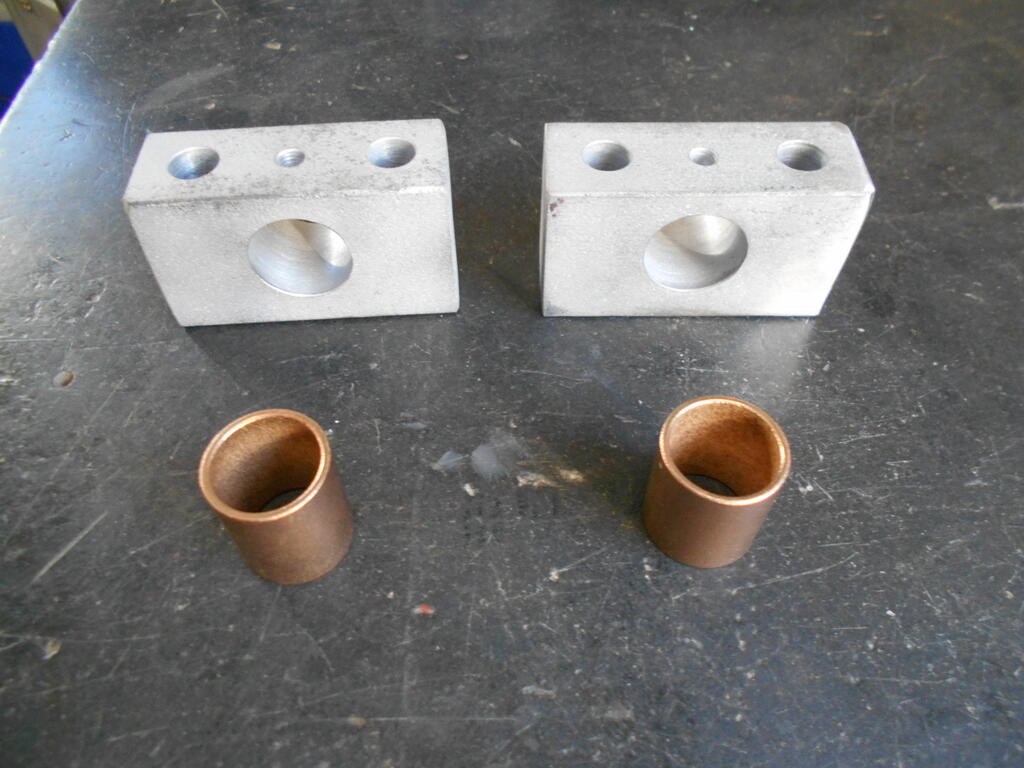

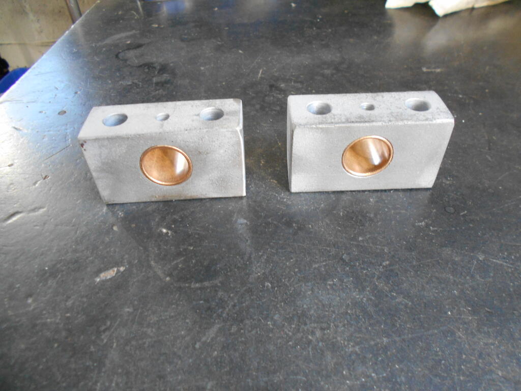

cleat 8,101 #10 Posted November 25, 2024 Bushings came in. Here they are cleaned and ready to be installed. I used a bit of this to ensure bushings do not move once installed. Bushings pressed in. Ready to be drilled. Bushings drilled. Blocks tapped to 1/4-28 for grease fittings. 1 5 Share this post Link to post Share on other sites
