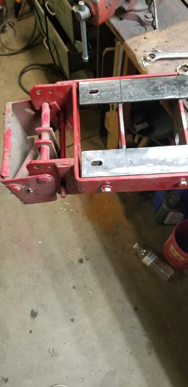

953 nut 68,466 #2 Posted November 19, 2024 (edited) If you add a Mule Drive to the front of the GT-14 you can use any newer deck. The receiver for the mule drive is used to retain the front axle of later model Wheel Horses. Lincoln at A-Z should be able to fix you up, give him a call. https://www.a-ztractor.com/ Edited November 19, 2024 by 953 nut add photo Share this post Link to post Share on other sites

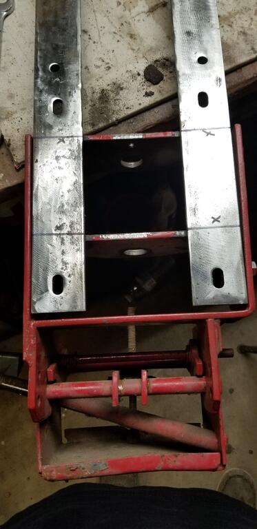

gt14rider 1,278 #4 Posted November 20, 2024 (edited) You will need to modify the front attach o matic, off set about a inch. The gt14 is wider than other tractors. If you need measurements let me know. Edited November 20, 2024 by gt14rider 1 Share this post Link to post Share on other sites

953 nut 68,466 #6 Posted November 21, 2024 23 hours ago, Mark siebenaler said: Do I need to install something On the tractor to accept the mule drive. Yes, the receiver for the mule drive can be salvaged from any late model parts tractor. A-Z can fix you up. 1 Share this post Link to post Share on other sites
