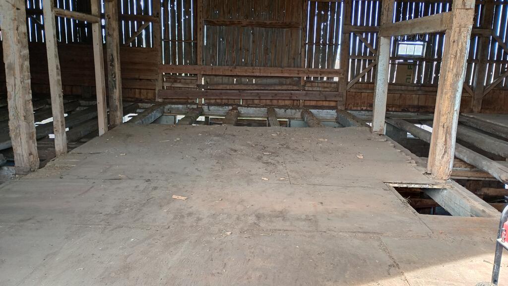

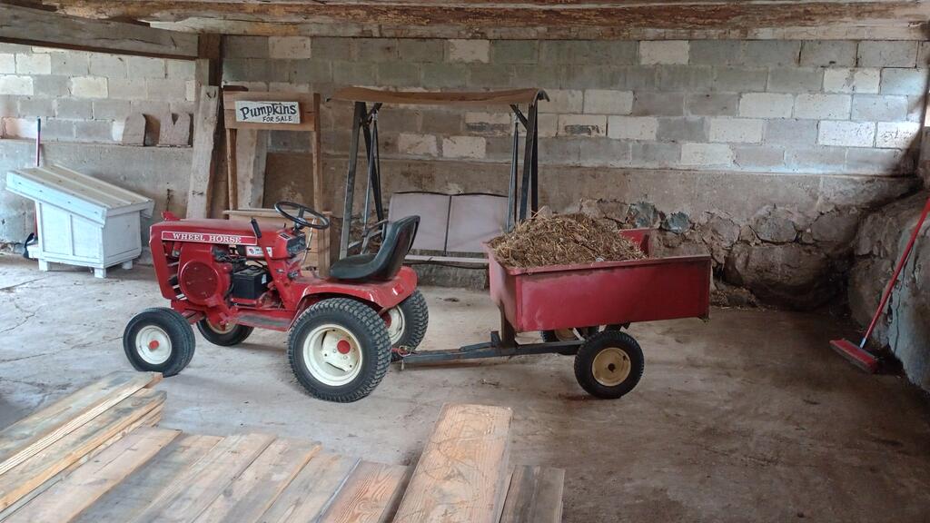

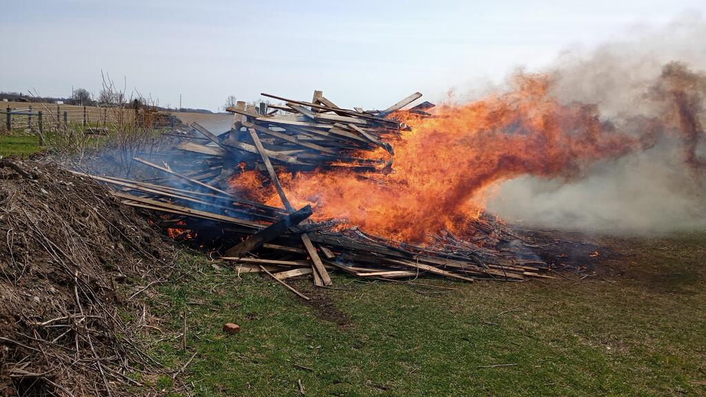

AlexR 3,136 #151 Posted April 1, 2025 Getting the last section done. Started the pile on fire, filled the trailer and threw that on the pile of coals that was left, and that all is burned up now as well. 1 8 Share this post Link to post Share on other sites

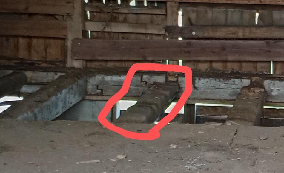

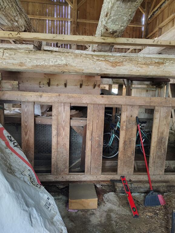

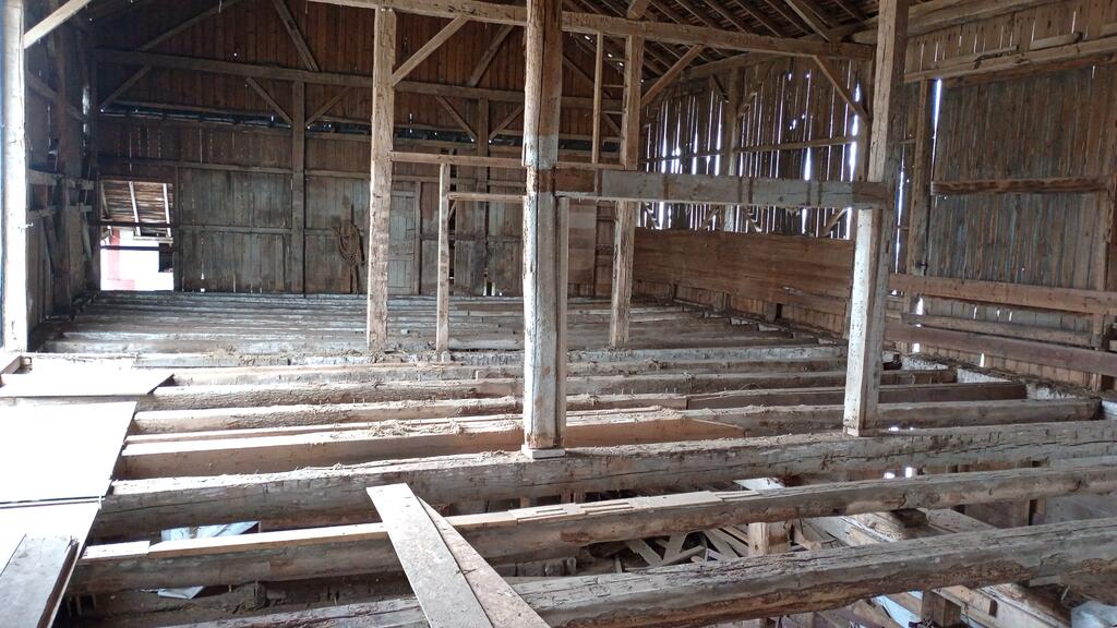

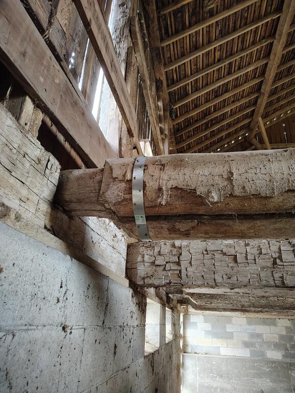

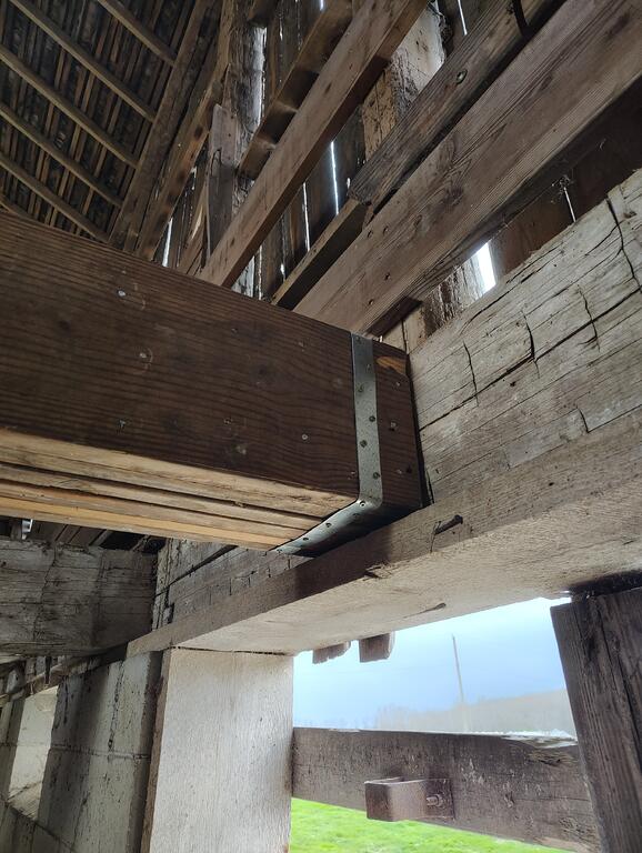

AlexR 3,136 #154 Posted April 2, 2025 Thanks guys! Means a lot to me. We'll see once I get the rest of the floor up, if I can replace the one beam without help. I got some ideas so we will see how it goes. Its hard to tell from the photo but the end of the beam is broken off and they bolted a piece of metal that they actually cleverly welded but it needs replaced. 6 1 Share this post Link to post Share on other sites
Wayne0 1,659 #155 Posted April 3, 2025 On 4/1/2025 at 8:14 PM, AlexR said: Thanks guys! Means a lot to me. We'll see once I get the rest of the floor up, if I can replace the one beam without help. I got some ideas so we will see how it goes. Its hard to tell from the photo but the end of the beam is broken off and they bolted a piece of metal that they actually cleverly welded but it needs replaced. Jacks and braces will get it done. 1 Share this post Link to post Share on other sites

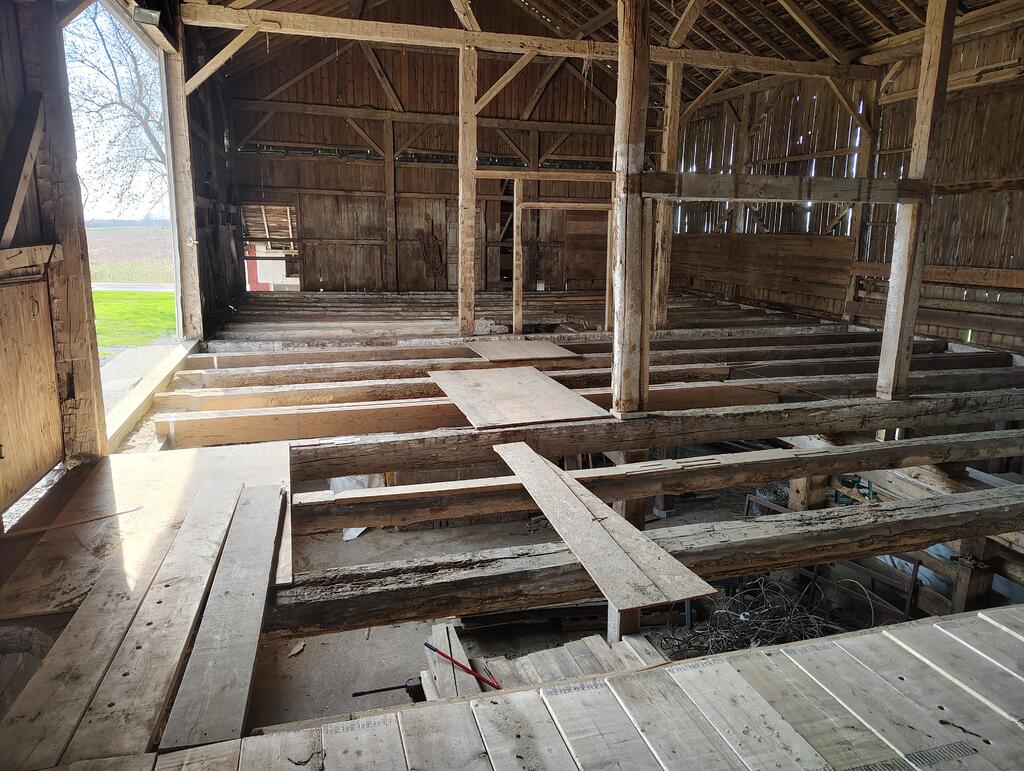

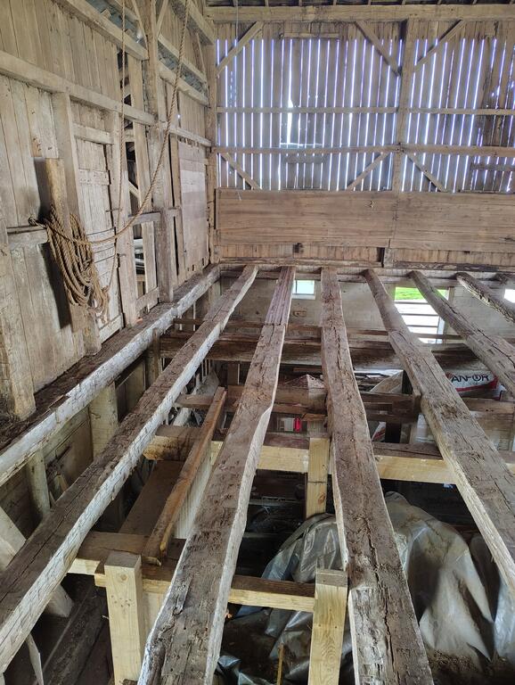

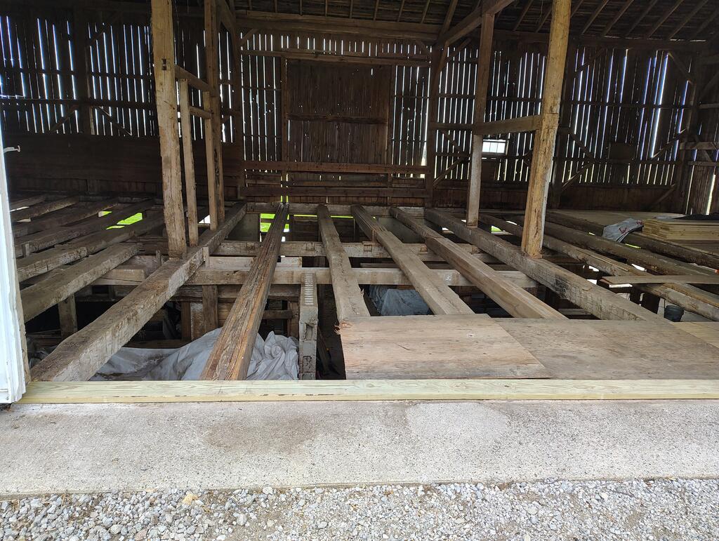

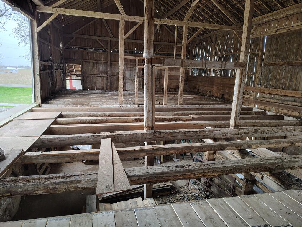

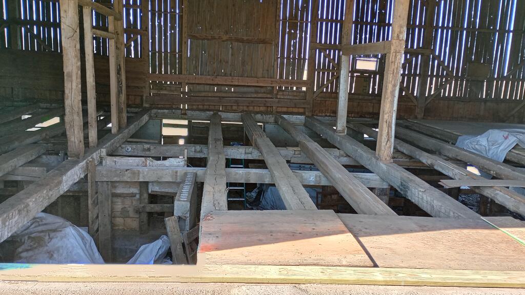

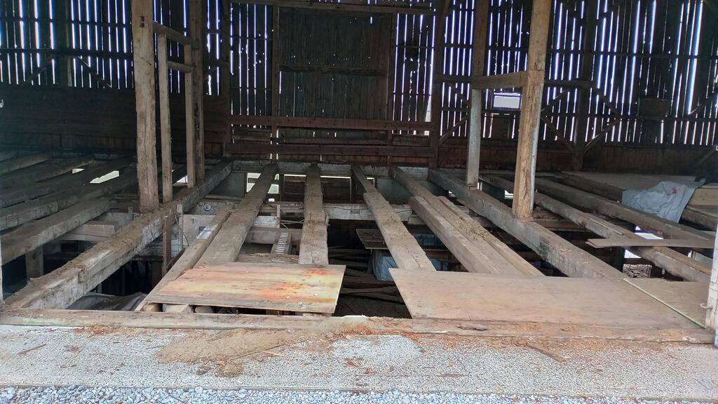

AlexR 3,136 #156 Posted April 3, 2025 My Amish neighbor came over and helped me today and we got the rest of the floor tore up. Pieces of plywood are loose just to walk on to get the barn doors closed. 7 4 1 Share this post Link to post Share on other sites

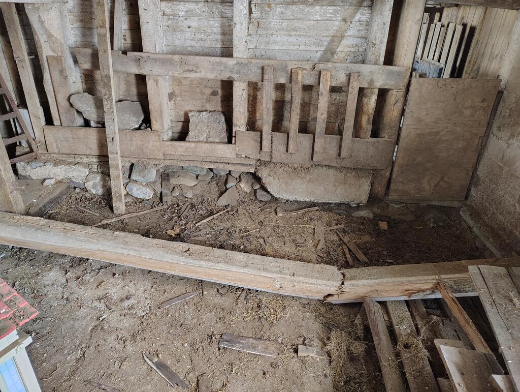

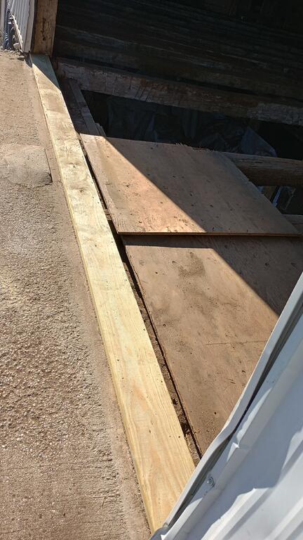

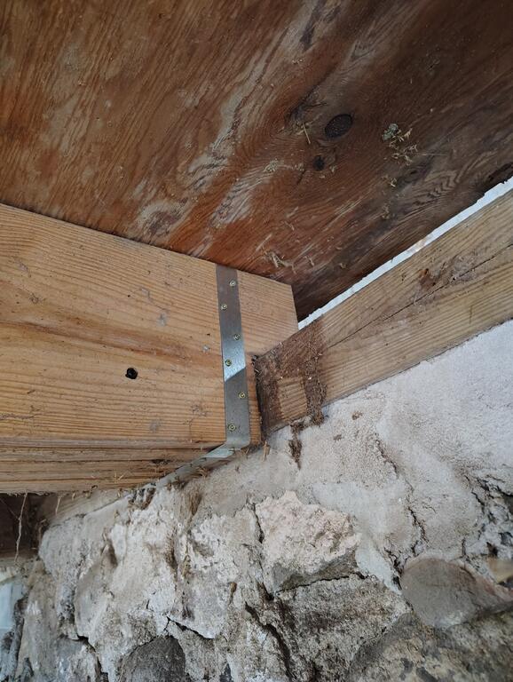

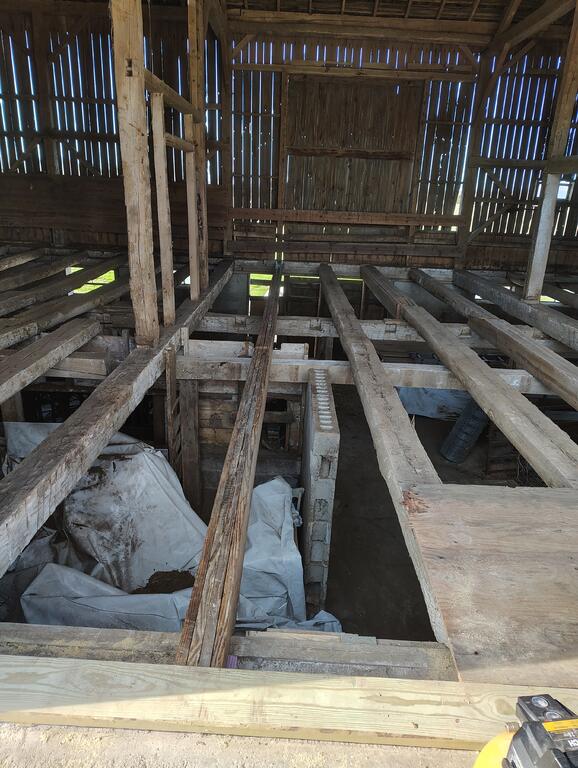

AlexR 3,136 #157 Posted April 12, 2025 Getting some more work done, got the bad beams cut out. Getting the whole area beefed up. Used the beam I had from the loft as a extra support beam going across underneath the other beams and under the support posts that were just being supported by the beam itself. I ended up cutting the entire beam out it was dry rotted all the way. I am going to glue, nail, and timber screw together some of the floor joists from the loft to make one long beam probably going to do 6 wide. Got this threshold replaced with a new treated ground contact board. 2 8 Share this post Link to post Share on other sites

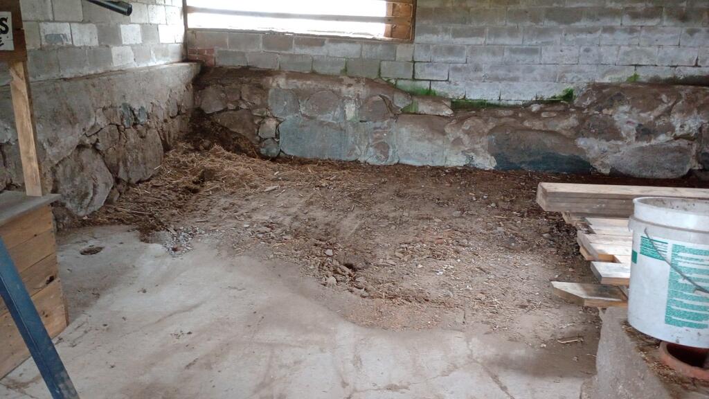

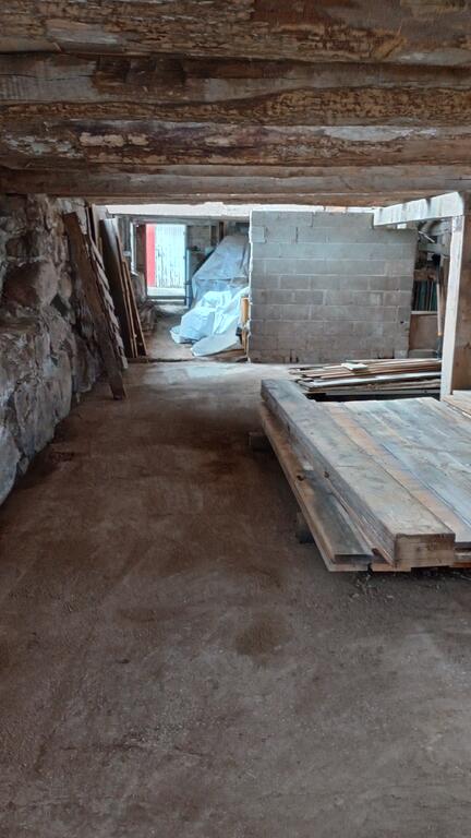

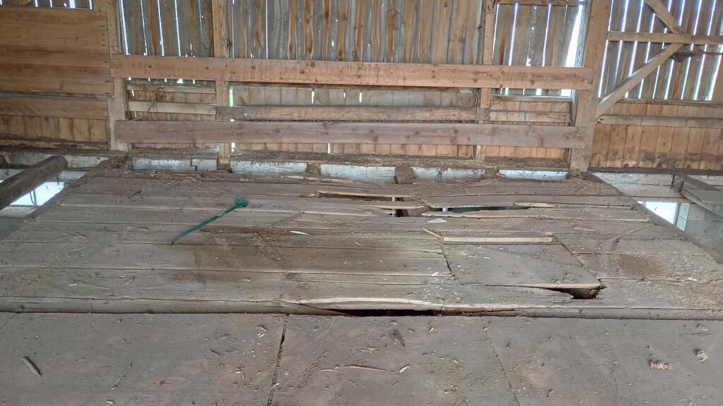

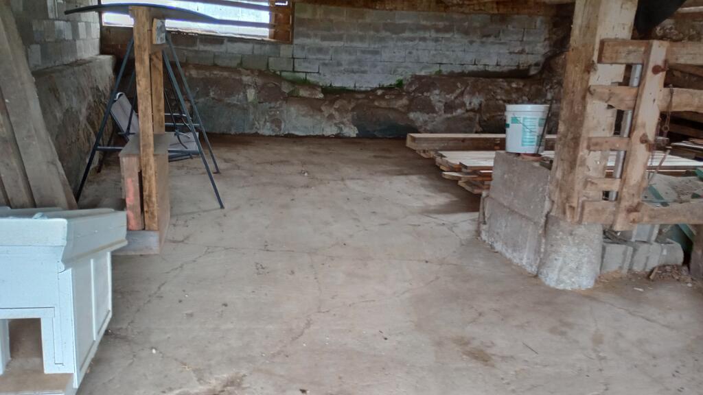

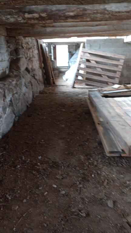

AlexR 3,136 #159 Posted April 13, 2025 Spent some time today cleaning up the bottom of the barn from all the dirt, dust, and everything else that came down. While pulling up the floor up above. 2 6 Share this post Link to post Share on other sites

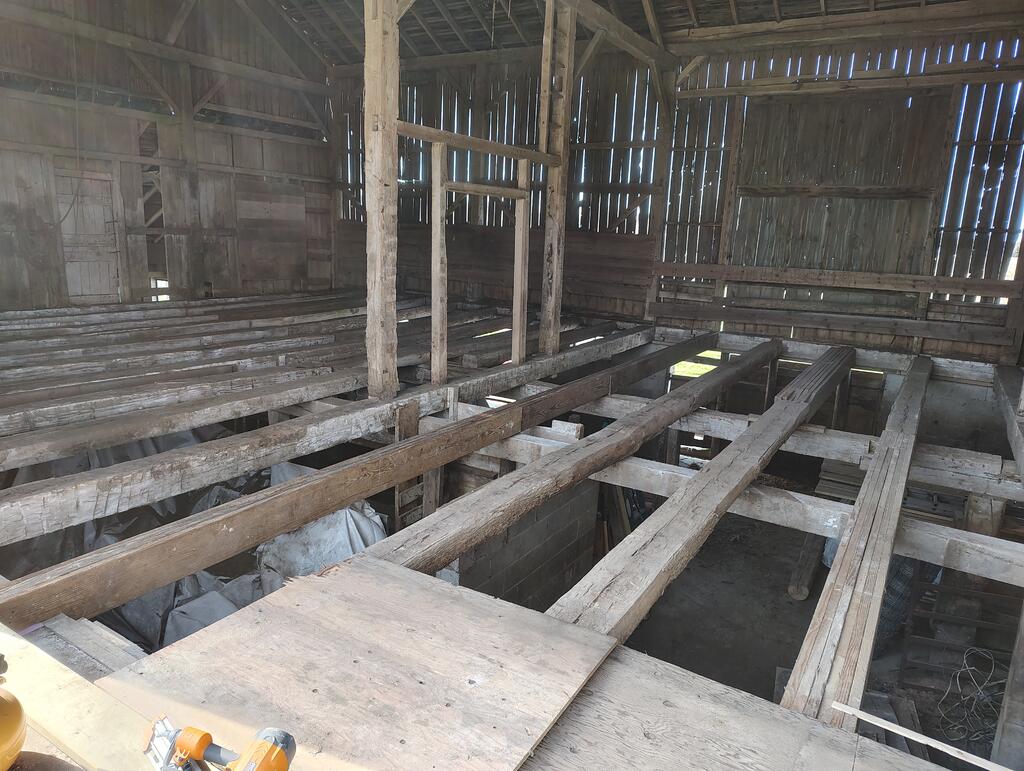

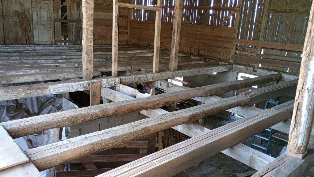

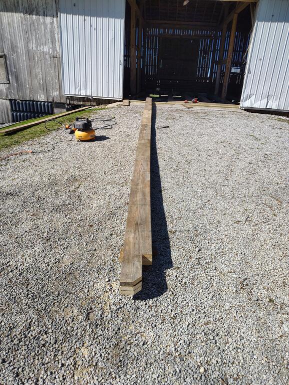

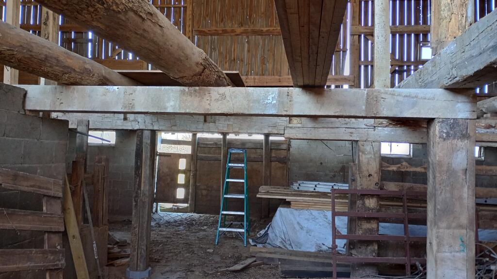

AlexR 3,136 #165 Posted April 16, 2025 Got most of the new beam made and in just got to add one piece to each side to make it 6 wide. Its made out of 2x10's that I pulled off the floor in the barn and it's 35' long. 2 6 Share this post Link to post Share on other sites
Handy Don 17,657 #166 Posted April 17, 2025 I like the reuse with a built-up beam--nicely done. Please consider spacing some TimberLock screws along the full length to assure that any future warping in any one layer will be absorbed. When I make built up beams, I put a strong C-clamp on either side of where I’m putting in the Timberlock to make extra sure the beam layers are tight together. Yes, it’s a bit tedious but you want this to be once and one for your lifetime, right? 1 1 Share this post Link to post Share on other sites
AlexR 3,136 #167 Posted April 17, 2025 Added the last two layers for the beam, and yes I used 8" timberlock screw lags in the beam both sides. @Handy Don Not sure if I will have any more posts until I start laying down the new flooring, as it's not really noticeable leveling out beams in the photos. In a side note we got some chicks. We've been talking about getting them for the 4 years we lived here but never were quite ready for them. So over the summer I will need to build a coop into the bottom of the barn. I do have something to put them in for the summer and early fall, but will need a coop for after that. 6 Share this post Link to post Share on other sites

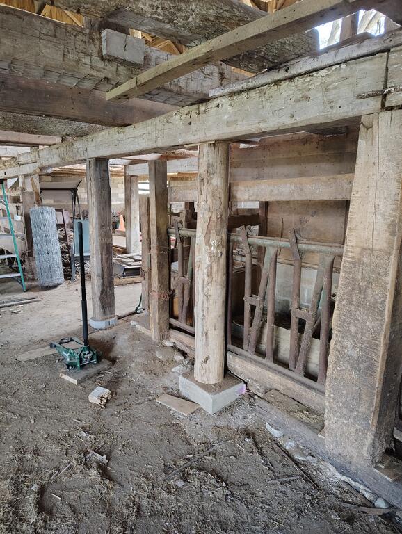

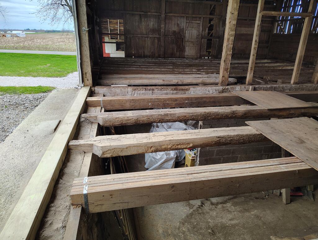

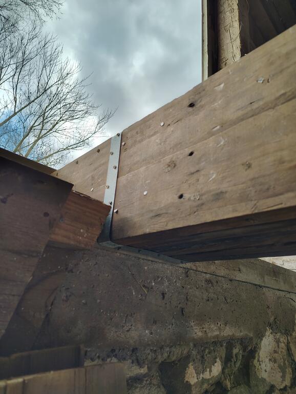

AlexR 3,136 #170 Posted April 18, 2025 Strapped the beams that needed it got 36" straps so they go all the early around. And put some concrete footers in for additional supports that are needed. 2 6 Share this post Link to post Share on other sites

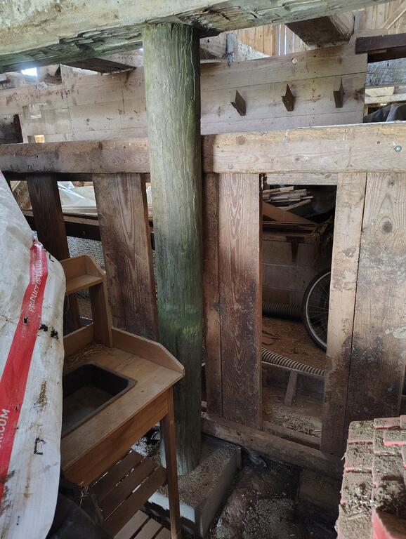

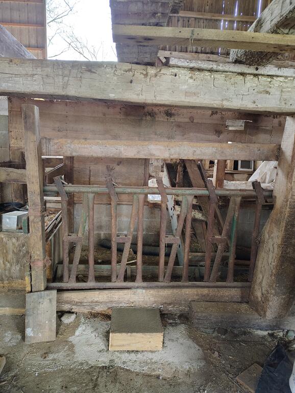

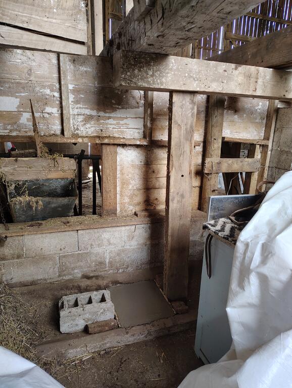

AlexR 3,136 #171 Posted April 19, 2025 (edited) Well... Got another beam to replace I should have seen this one coming I knew it was cracked they had a couple boards on either side, but I decided it would be better just to replace it. And yes I need to do some concrete work behind that beam. Can't really tell haha, but I leveled out the beams along the front of the barn. I started working on the back side as well. Once I get that done I can do the middle, then run a string line the length of each beam to level out any low spots. Edited April 19, 2025 by AlexR 4 5 Share this post Link to post Share on other sites
AlexR 3,136 #172 Posted April 22, 2025 Got the beam replaced. And lifted and supported the main support beam it actually looks fairly level in the picture now. 1 7 Share this post Link to post Share on other sites
