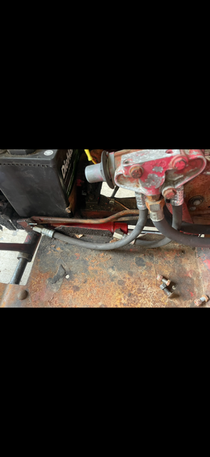

AHS 1,554 #1 Posted November 16, 2024 Hello there, new to me C120. Im planning on using it for plow duties this winter! I have got the cylinder rebuilt by wheelhorsepartsandmore, and got 101422 and 101423 hoses for the hydro lift. I messed up the o rings on one of them! What o rings go on them? Can i just get them at a regular store? Im curious! Thanks! Share this post Link to post Share on other sites
953 nut 61,692 #2 Posted November 16, 2024 (edited) You should be able to match them up at ACE or any other good hardware store. The proper amount of torque applied to these "O" Ring fittings is very important. Your fittings are ORB. JIC ORB Size SAE Thread Torque Size SAE Thread Torque 4 7/16-20 140 In/Lb 4 7/16-20 220 In/Lb 5 ½-20 180 In/Lb 5 ½-20 260 In/Lb 6 9/16-18 250 In/Lb 6 9/16-18 320 In/Lb 8 ¾-16 550 In/Lb 8 3/4 -16 560 In/Lb Edited November 16, 2024 by 953 nut 2 Share this post Link to post Share on other sites

953 nut 61,692 #5 Posted November 16, 2024 We aren't talking about wrench size here, we are talking about bolt thread size. A common 7/16-20 bolt will have a 1/2" hex head that the wrench goes onto. Here you go, just plug in your numbers and it will tell you what you need to know. I don't think any fittings on a Wheel Horse are 3/4-16 thread but if they were then would be about 47 foot pounds of torque. https://www.thecalculatorsite.com/conversions/common/inch-pounds-foot-pounds.php 2 Share this post Link to post Share on other sites
Handy Don 14,493 #6 Posted November 16, 2024 (edited) 2 hours ago, AHS said: What o rings go on them? I’m not sure I’d count on hardware store o-rings for the ORB fittings. ORBs typically need a high-durometer Buna rubber. Try this place. I’ve bought fittings from them but never just the rings. Edited November 16, 2024 by Handy Don Share this post Link to post Share on other sites
ri702bill 9,895 #7 Posted November 16, 2024 3 hours ago, AHS said: What o rings go on them? Can i just get them at a regular store? Im curious! Thanks! Regular Buna-n may not be compatible with hot hydraulic fluid. Perhaps either Viton or HNBR may be a better choice. Share this post Link to post Share on other sites
oliver2-44 10,922 #8 Posted November 16, 2024 Just take it to a Hydraulic shop. hey have drawers and drawers of O-rings, it what they do every day. 5 Share this post Link to post Share on other sites
pfrederi 18,870 #9 Posted November 16, 2024 SAE ORB #5 use Dash # 905 O rings SAE ORB #6 use Dash # 906 O rings. When you figure which ones you need PM me your address i will send you a couple 1 1 Share this post Link to post Share on other sites

AHS 1,554 #13 Posted November 16, 2024 On 11/10/2024 at 8:06 AM, lynnmor said: And then decide to never buy or accept a free Onan again that was left in the weather. 9 hours ago, 953 nut said: We aren't talking about wrench size here, we are talking about bolt thread size. A common 7/16-20 bolt will have a 1/2" hex head that the wrench goes onto. Here you go, just plug in your numbers and it will tell you what you need to know. I don't think any fittings on a Wheel Horse are 3/4-16 thread but if they were then would be about 47 foot pounds of torque. https://www.thecalculatorsite.com/conversions/common/inch-pounds-foot-pounds.php Duh! It is bigger than 1/4 20. I think 9/16. I will have to look! Share this post Link to post Share on other sites
