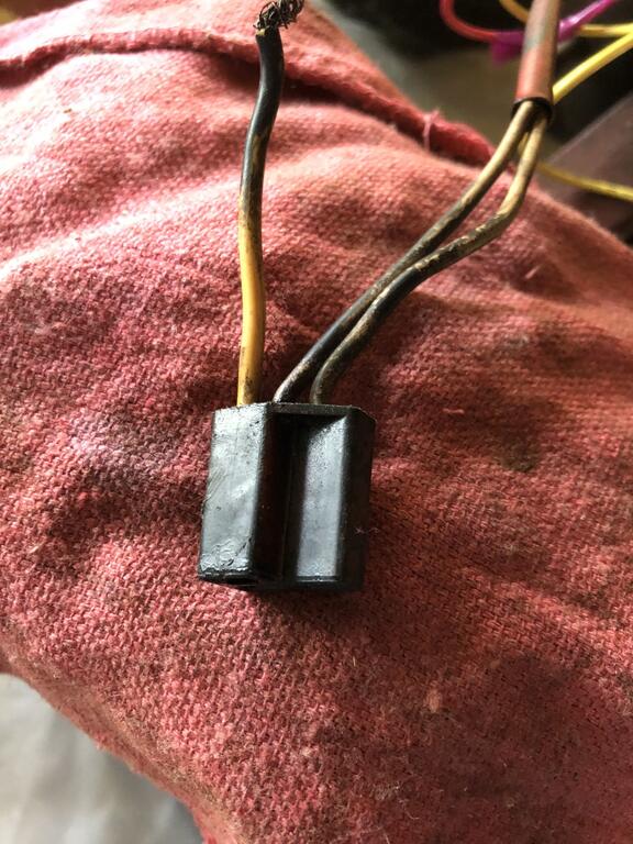

pfrederi 20,532 #3 Posted November 15, 2024 That is the plug for teh voltage regulator two white wires come from stator yellowish goes to ammeter 3 Share this post Link to post Share on other sites

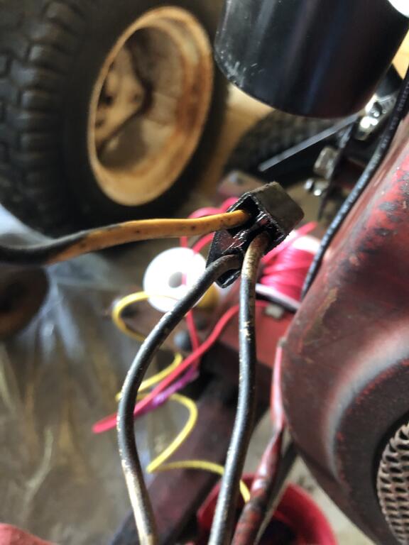

CNC 17 #7 Posted November 16, 2024 1 minute ago, CNC said: Could someone please tell me where to connect these wires coming from the stator on my 1974 C-160 Wheelhorse? 1 Share this post Link to post Share on other sites
pfrederi 20,532 #8 Posted November 16, 2024 the plug goes into the regulator the cur wire goes to the R terminal on the switch 1 Share this post Link to post Share on other sites
CNC 17 #9 Posted November 17, 2024 Thanks for responding. I have 2 questions 1 The wires coming from the stator are about 16 inches long and the regulator/rectifier is under the steering wheel, So would I have to build a jumper wire from the stator wires to the regulator/rectifier ? 2 The yellow wire coming out the back of the connector( the one that has been cut) does it go to the starter R terminal ? it looks like the yellow wire also plugs into the regulator/rectifier. Thanks for all your help!! 2 Share this post Link to post Share on other sites

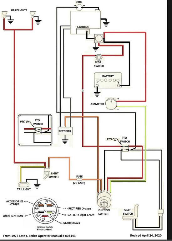

953 nut 66,051 #13 Posted November 18, 2024 51 minutes ago, CNC said: 1 The wires coming from the stator are about 16 inches long and the regulator/rectifier is under the steering wheel, So would I have to build a jumper wire from the stator wires to the regulator/rectifier ? If it isn't long enough you should be able to splice a sufficient amount of 16 gage wire to make the connection. It would be a good idea to solder the splices if you can. 2 The yellow wire coming out the back of the connector( the one that has been cut) does it go to the starter R terminal ? it looks like the yellow wire also plugs into the regulator/rectifier. The wire from the B+ terminal of the rectifier/regulator goes to the ignition switch R terminal. Share this post Link to post Share on other sites
