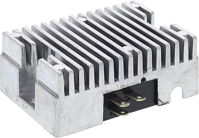

JP56 42 #1 Posted November 14, 2024 Went to put in a new feeder wire for the tail light & head lights on my 74 C-100 & found the black 2 wire plug on the Rectifier/Regulator was fried so bad it melted into the contacts on one of the 2 wires going to the engine. Any ideas as to what may have cased this? The wire connector on one of them was so badly encased I had to cut the end off it. Looking at the condition of the 2 wires to the engine, I can see what looks to be some heat shrink over what may be bullet connectors wrapped with electrical tape, just above the flywheel backing/plate at the top over the starter. Not sure if what I am looking at is OEM connections there, or if the prior owner did some kind of repair at the engine end of the 2 wires. Any way of testing the Rectifier/Regulator while off the tractor to see if I need to replace it at the same time when I check what's under the tape, & replace the 2 wires coming from the engine end of the two wires back to the Rectifier/Regulator since the connector ends got screwed up & need replacing anyway? My regulator looks like this one, except mine just has a 2 prong single plug connector for the 2 AC prongs & a separate single wire going to the B+ terminal instead of a single L shaped 3 prong connector on the end of the wires. Share this post Link to post Share on other sites

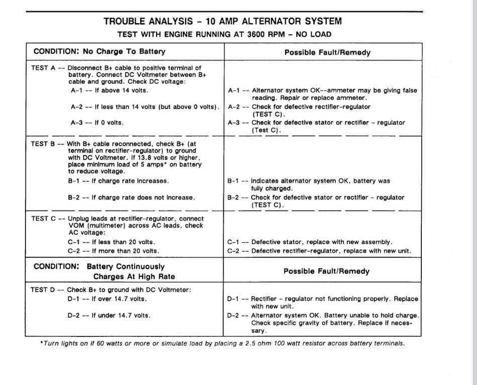

pfrederi 21,162 #4 Posted November 15, 2024 Check you stator output and charging system as below. Probably will need a new regulator if so make sure it is well grounded... 2 Share this post Link to post Share on other sites
