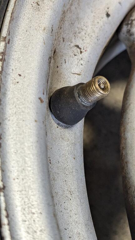

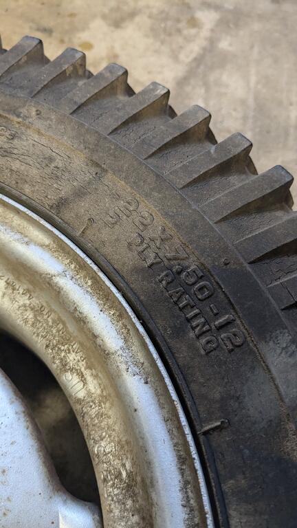

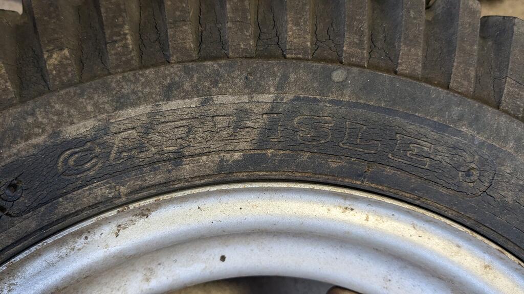

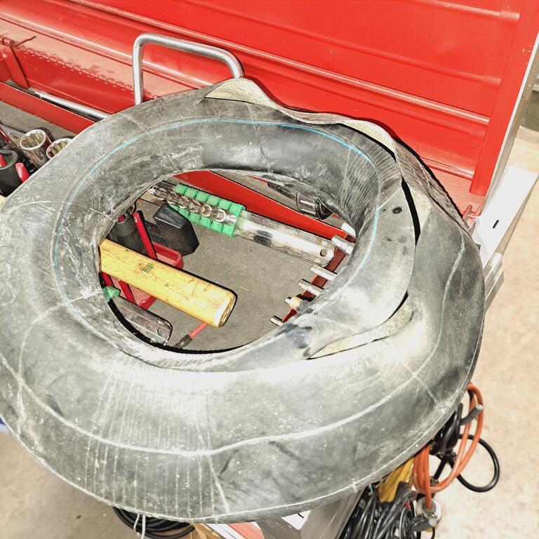

Alrashid2 431 #1 Posted November 11, 2024 (edited) Hey guys. All 4 of my newly acquired Wheel Horse 312-8's tires are dry rotted and cracked, but have near perfect tread. The fronts are definitely tubeless, and losing air, so going to get tubes put into them. The rears, however, I'm not so sure of. They aren't losing air, but I'd like to put tubes in them at the same time just for peace of mind. However, if they already have tubes in them, no point right? Can anyone help me figure out if they are Tubed or Tubeless? Attached some photos. They're Carlisle 22x7.50-12 tires, don't say "Tubeless" anywhere on them. However, the valve stem shape made me think they were tubeless but I'm not quite sure... Tried deflating one and poking in but I just can't get a good look and didn't want to risk ripping the tire. Thanks for the advice all! I'm real thankful for this place Edited November 11, 2024 by Alrashid2 Photos Share this post Link to post Share on other sites
ebinmaine 75,801 #2 Posted November 11, 2024 That last photo would lead me to believe that you have a tubeless tire there. You can't see the hole that the stem should be going through. 6 1 Share this post Link to post Share on other sites
Alrashid2 431 #3 Posted November 11, 2024 1 minute ago, ebinmaine said: That last photo would lead me to believe that you have a tubeless tire there. You can't see the hole that the stem should be going through. Thanks for replying. Ya, that is what I was thinking too... The fact that the valve stem is pretty wide. But I wasn't sure and googling is not helping me find anything at all. Seems wild they're still holding air if tubeless! Share this post Link to post Share on other sites
pfrederi 19,278 #4 Posted November 11, 2024 Fat rubber around the hole tubless Share this post Link to post Share on other sites
Alrashid2 431 #5 Posted November 11, 2024 Thanks for confirming. Guess I better take all 4 wheels to my local guy to get tubes put in... thanks guys! Share this post Link to post Share on other sites

Alrashid2 431 #16 Posted November 13, 2024 Got my wheels back! He aired them up to 19 PSI but I dropped to 12 PSI as per the service manual. Here are the tubes he used. Tires are 15x6-6 and 22x7.5-12 3 Share this post Link to post Share on other sites
ebinmaine 75,801 #17 Posted November 13, 2024 1 minute ago, Alrashid2 said: the tubes he used Not Chinese. Decent brand. 1 1 Share this post Link to post Share on other sites
Alrashid2 431 #18 Posted November 13, 2024 Good to know! Only thing that concerned me is he used a 23" tube in a 22" tire. But I know the exact size is hard to find 1 Share this post Link to post Share on other sites
ebinmaine 75,801 #19 Posted November 13, 2024 14 minutes ago, Alrashid2 said: Good to know! Only thing that concerned me is he used a 23" tube in a 22" tire. But I know the exact size is hard to find Should be fine. Tubes are usually able to be used one size up or down. Maybe more. 1 Share this post Link to post Share on other sites
Alrashid2 431 #20 Posted November 13, 2024 Thank you @ebinmaine. More peace of mind from you boys. Appreciate you all! 1 Share this post Link to post Share on other sites
