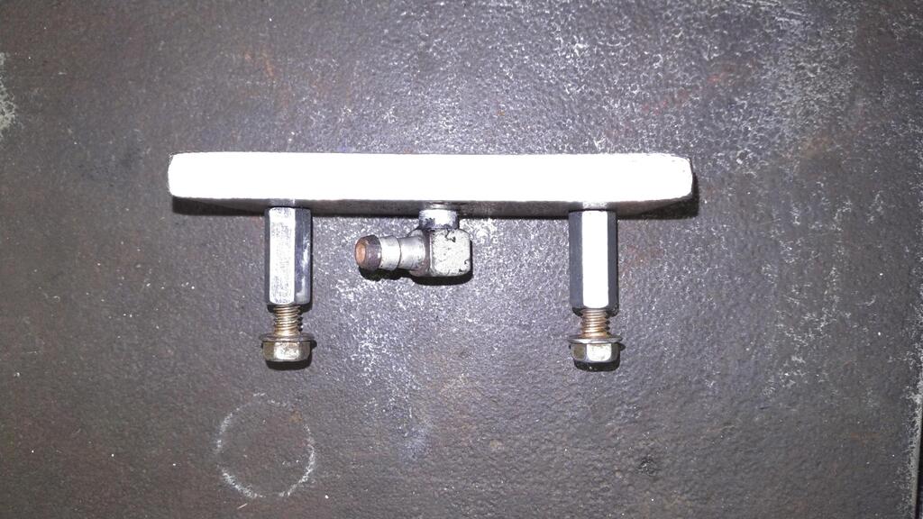

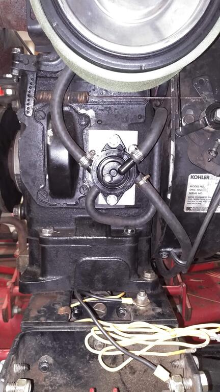

Bill D 3,099 #11 Posted November 10, 2024 I built a mounting plate and switched to vacuum impulse pumps. If you go this route, purchase a name brand Briggs or Kawasaki pump. They are made by Mikuni in Japan. 1 Share this post Link to post Share on other sites

Bill D 3,099 #13 Posted November 10, 2024 17 minutes ago, Alrashid2 said: Thanks for sharing, you did a nice job! Reading over some posts, the electric pump seems a bit beyond me. I'm short on cash at this point too and would like to just replace with a plastic fuel pump. Hell, if it goes bad, they seem cheap enough and the install doesnt seem too difficult Does anyone know of a source for a mechanical fuel pump replacement? Ton on amazon but I rather buy from a more reputable source if possible Thanks. You can get OEM pumps off Amazon for about the same as aftermarket mechanical pumps. They are much more reliable than the aftermarket mechanical pumps. Those too are known to leak gas into the crankcase. The plate is easy to make. 1 Share this post Link to post Share on other sites
