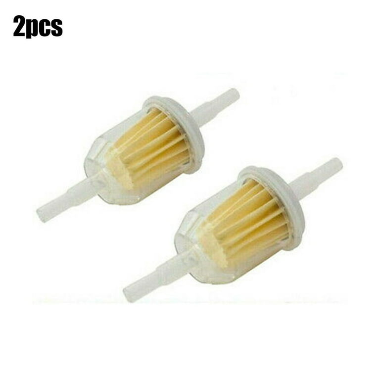

953 nut 65,156 #2 Posted November 9, 2024 (edited) By fuel filter are you looking for an in-line clear plastic filter, if so you can buy any 1/4" filter off the shelf. https://www.tractorsupply.com/tsc/product/arnold-universal-fuel-filter-4441282?store=1398&cid=Google-Shopping-Sustain&utm_medium=Google&utm_source=Shopping&utm_content=Sustain&gad_source=1&gclid=Cj0KCQiArby5BhCDARIsAIJvjIRL4bGw_EqlPQX9MCRCKk8sY63RQ8NsPA7Z4lZ52qE2A7HBydrpngcaAo1aEALw_wcB Edited November 9, 2024 by 953 nut 1 Share this post Link to post Share on other sites

squonk 46,072 #4 Posted November 9, 2024 Stay away from these type filters. They tend to air lock (happened to me more than once) and the cheap version of these the media falls apart. 1 Share this post Link to post Share on other sites
953 nut 65,156 #5 Posted November 9, 2024 2 hours ago, squonk said: They tend to air lock (happened to me more than once) and the cheap version of these the media falls apart Been using them for years with no problems. 1 Share this post Link to post Share on other sites
kpinnc 17,814 #6 Posted November 10, 2024 4 hours ago, 953 nut said: Been using them for years with no problems. Same here. Never had one fail. 2 Share this post Link to post Share on other sites

squonk 46,072 #8 Posted November 10, 2024 I've had 4 of those cheap clear plastic fuel filters air lock. Even with an electric pump. Had a couple tractors in for service with them and the fuel bowls are filled with filter material. I use the red Breaks and Scrap Em pancake filters now Share this post Link to post Share on other sites

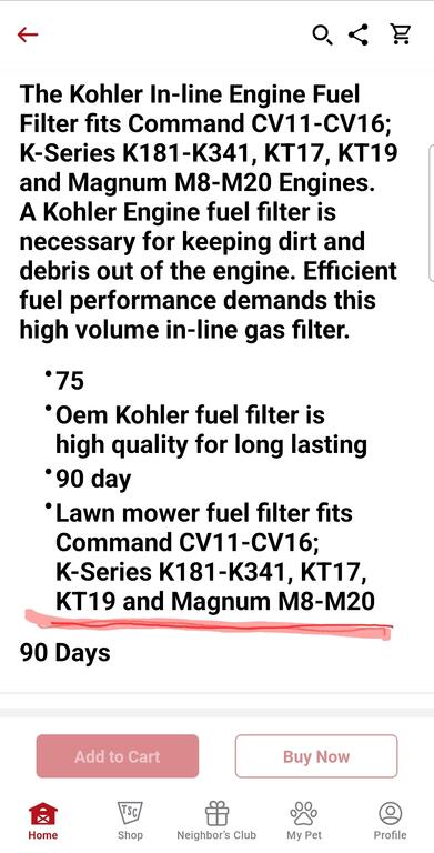

Greg Cullison 76 #9 Posted November 10, 2024 Seems like this should be what I need....? Share this post Link to post Share on other sites
kpinnc 17,814 #10 Posted November 10, 2024 (edited) 2 hours ago, Greg Cullison said: Seems like this should be what I need....? That will work. One reason I prefer the clear filter is so I can see any particulate it catches. Definitely a plus with a metal tank or if you have a fuel sensor that can drop debris. Edited November 10, 2024 by kpinnc 1 Share this post Link to post Share on other sites
