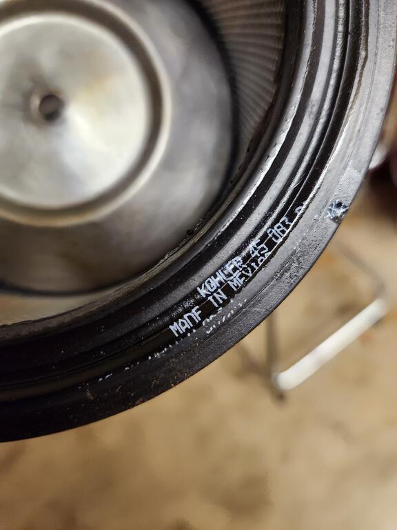

Greg Cullison 76 #1 Posted November 7, 2024 Hello all, looking to replace the air filter but cannot make out the part number. I believe it's a 1990 horse and it has the Kohler Magnum 12 in it. Model and serial number in the second pic. Thanks!!! Share this post Link to post Share on other sites
gwest_ca-(File Mod) 11,849 #2 Posted November 7, 2024 6" OD x 4-5/8" ID x 3" HT Kohler 4508302, 4508302-S, 4508302-S1 with pre-filter replaced by 4588302-S1 (Used on 16hp) Onan 1401216 Toro/Wheel Horse KH10236 Toro/Wheel Horse pre-filter KH10235 Napa 7-02226 (Prime Line) Stens 100-065, 055-017 Stens with pre-filter 055-421 Stens pre-filter 100-768 Wix 42299 2 Share this post Link to post Share on other sites
peter lena 9,559 #3 Posted November 7, 2024 @Greg Cullison agree with @gwest_ca on choices , personally like the PRE FILTER TYPE . got mine on line , pete 2 Share this post Link to post Share on other sites
