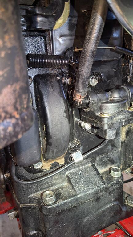

Alrashid2 476 #1 Posted November 6, 2024 Hey guys, curious if I'm being too picky and if this is normal or not. Picked up a 1985 312-8 with the Kohler 301S engine on it. Noticed engine was sludgy looking so I cleaned off with brake cleaner and a good scrub and pressure wash. Couple days and less than an hour run time later and I notice it's sludgy looking again... Can't quite tell where the leak is coming from but it's all over the front of the engine. Looks to be from the carb, to the fuel pump, all the way down to the pan. All seems to be on the front only. No drips or puddles on the ground and dipstick looks spot on, so it's not that bad, but just enough to make the engine grimy. Is this ok to let be, it being an older engine and all? Id rather not tear and rebuild when it otherwise runs perfectly. Anyone ever tried a stop leak? I have 10w30 in it because I'll be using it in temps between 25 and 85 F but I'm wondering if switching back to 30SAE would help at all. Thanks all! 2 Share this post Link to post Share on other sites
kpinnc 18,884 #2 Posted November 6, 2024 If you’ve removed the breather for any reason, the reed valve may be backwards. That or the fuel pump gasket is a common place for the engine to leak some. And no, I doubt SAE30 would make any difference. 4 Share this post Link to post Share on other sites
ebinmaine 80,279 #3 Posted November 6, 2024 Several thoughts. Clean it again and carefully watch the cylinder head gasket area. Pretty normal for those to go bad eventually. I'd seriously consider removing and cleaning your breather as a matter of maintenance. Because you'll have to remove the carb you might as well schmooge that out too. Very easy. 17 minutes ago, Alrashid2 said: stop leak? IMHO: DO NOT USE STOP LEAK. >>>>> EVER <<<<< Find and fix the leak. Period. 19 minutes ago, Alrashid2 said: 10w30 in it because I'll be using it in temps between 25 and 85 F but I'm wondering if switching back to 30SAE I don't have a manual for your model handy. I'd defer to that. That said..... Trina's mid 60s 8 HP Kohlers like HD30 all year. My mid 70s 16 HP Kohlers do NOT like to start below about 20⁰ unless I change to 10W30. 3 Share this post Link to post Share on other sites

JimSraj 585 #5 Posted November 6, 2024 Pictures would help but I’m gonna guess it’s spray from the breather. Clean it up and make sure it’s reed is properly installed. 2 Share this post Link to post Share on other sites
953 nut 68,503 #6 Posted November 6, 2024 Remove and clean the internals of your breather. If the filter is oil saturated clean it with mineral spirits and let it dry over night and be sure the louvers of the cover are pointed UP. 2 1 Share this post Link to post Share on other sites
squonk 47,887 #7 Posted November 7, 2024 How many our on this thing? If high hours I'm guessing breather spray and oil out the governor shaft from over pressurization of the crankcase due to a worn out cylinder and rings. Share this post Link to post Share on other sites

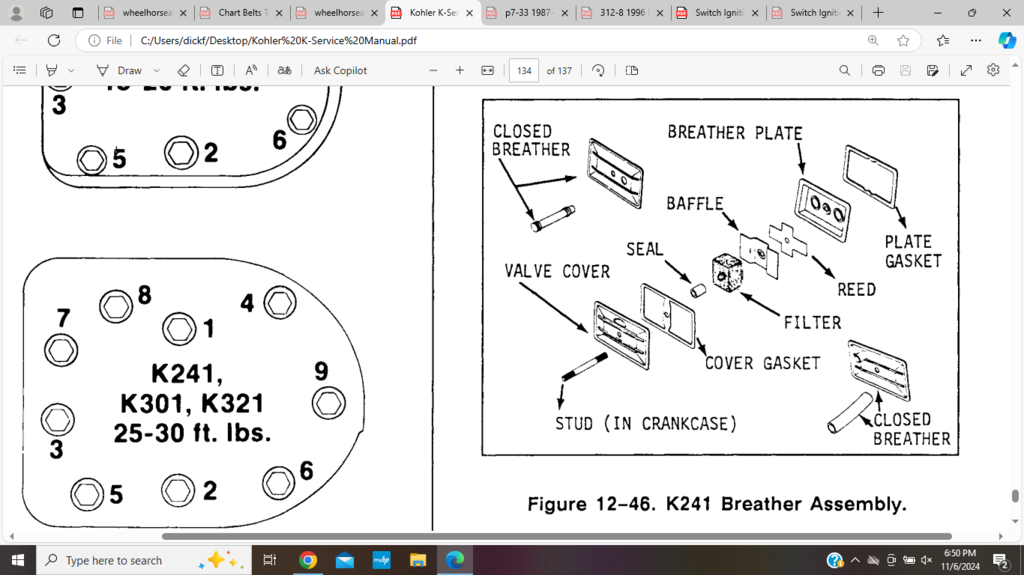

Alrashid2 476 #8 Posted November 7, 2024 Thanks all for your replies! You guys beat me to asking my next question, which was "What is this square piece on the front of the engine?" because it appears that the oil is coming from that - the breather! I may need to do some more reading, but can I simply remove that breather, clean, and put back together according to the diagram posted above? Want to make sure I'm not pulling something and getting too beyond myself Unfortunately no hour meter on this one so no idea how long she's been running... 1 Share this post Link to post Share on other sites

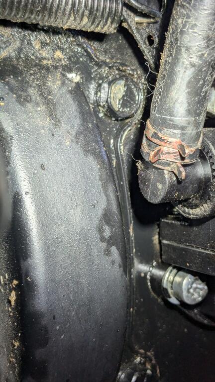

Alrashid2 476 #16 Posted November 7, 2024 Haha I have learned time and time again to always take pictures! I did so! Just pulled the carb and breather! Unfortunately the breather was perfectly assembled, as per the previously posted diagram. Lot of oil in there though, and the filter is totally saturated. Thinking that might not be the best news... isn't the oil supposed to drain back into the engine, as opposed to weeping out? Maybe the gasket is bad? I checked that the little hole was on the bottom, so in theory I think oil should drain back in... 2 Share this post Link to post Share on other sites
Handy Don 17,316 #17 Posted November 7, 2024 (edited) 4 minutes ago, Alrashid2 said: Haha I have learned time and time again to always take pictures! I did so! Just pulled the carb and breather! Unfortunately the breather was perfectly assembled, as per the previously posted diagram. Lot of oil in there though, and the filter is totally saturated. Thinking that might not be the best news... isn't the oil supposed to drain back into the engine, as opposed to weeping out? Maybe the gasket is bad? I checked that the little hole was on the bottom, so in theory I think oil should drain back in... Making sure the filter is clean and the drain hole is clear and the gasket is good are all you can do on a correctly assembled breather. Check also that the cover is flat at the edges! Is the oil at the correct level? It’s sometimes tempting to “add just a bit more for insurance” but it really isn’t useful and can create issues. Edited November 7, 2024 by Handy Don 2 Share this post Link to post Share on other sites
oliver2-44 11,694 #18 Posted November 7, 2024 Since your ordering gaskets for the carb and breather order a new breather mesh filter. The old one will probable fall apart when you remove it ( they look like coarse scotch bite bad material) Inside the breather cavity are your 2 valve springs. Down in the bottom side/corner is a small hole (slightly smaller than 1.8" if I remember) that allows oil in that area to flow back to the crankcase. Clean that hole with a wire. You will probable want to clean that area out with some brake clean or similar spray solvent. If you not going to change your oil after this, plug that hole so your spray cleaner doesn't go into the crankcase and dilute your oil. (I use a whittled wooden match stick) Take a picture of that area before you clean it. It will give you a peek of how this engine was maintained. It will definitely have some black oil film/buildup. But if the Previous Owner did rarely changed the oil or never serviced this, it will have a black goo sludge at the bottom. (clean it out and move forward) While you have this open is the perfect time to check and adjust your valve spring clearance. (Kohler Service Manual says every 500 hours) Your K301 has adjustable tappets. Read the simple process in the Kohler Service manual. Since you've never been in one of these engines go to the Disassemble Section and read through it to help you visualize the internals before you pull it apart (But your only disassembling the breather and partial carb, so don't get overwhelmed.) Since your new at this, on the carb just plan to remove the 2 needles and the bottom bowl and float. SAFETY when you spraying cleaner through all the carb holes it can come out somewhere and spray back at you Wear safety glasses. You also want to wear disposable gloves since your going to get spray cleaner on your hands ( I buy the thicker mil black ones) Can you tell my wife is a medical person and preaches how absorbent the skin on your hands is! Don't try to remove the chock and throttle shaft which would require removing the tiny screws holding the round plates on. (the screws are staked and easy to break of removing them) If you throttle shaft has a lot of side to side movement (wear) get back with us and we can walk you through a simple repair and how to remove those tiny brass screws) When you remove the 2 needles, first count the turns it takes to completely close them to a gentle closed position. You will use this to reinstall them in the same position. On the long needle it is hollow but closed at the top and bottom. There are several horizontal holes in it that need to be cleaned with a tiny wire (i clip a wire off a wire brush and hold it in a vice grip) I hold the spray carb or brake clean straw against the holes and see that it blows out the other holes. Then take the carb body and spray cleaner through the 2 needle holes several times. Also take the spray straw and hold it against the small holes you see inside the carb throat. This is kind of awkward, but work at it to spray them out multiple times) If the carb bowl has some hard or gooey stuff in the bottom (old evaporated gas) soak it in lacquer thinner if you have some, or just spray and scrub with a stiff tooth brush multiple time (that stuff can get amazingly hard) 2 3 Share this post Link to post Share on other sites
Alrashid2 476 #19 Posted November 7, 2024 (edited) Thank you guys for the detailed instructions and advice. I just wanted to get in there and at least take a look. Looks like the drain hole in the back was clean and clear, inside by the valves was super clean - looked brand new! I'll look into ordering the carb gasket, breather gaskets (2), and that breather filter. Yup, looked like a brillo pad but was shockingly in good shape. Didn't fall apart, though I can see how it would over time. Anything else to buy? I'll look into the valve adjustment when i get the gaskets. Can I ask, what happens if your valves aren't adjusted correctly? Likewise, what is the function of the tippets? You guys rock! Thanks Edit: thought i should mention, yes there was some oil in the breather system, but not a ton. It honestly just looks like the gaskets are leaking during operation, so maybe not as much blowback as I thought. Will keep an eye on it. Edited November 7, 2024 by Alrashid2 1 Share this post Link to post Share on other sites

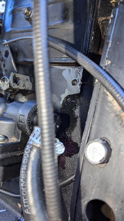

Alrashid2 476 #20 Posted November 7, 2024 Well, ran her for 15 minutes around the property and went back and checked the engine block. I was thinking maybe the oil was leaking from the fuel pump area. I now realize it looks like it's leaking from the governor arm, and dripping down onto the fuel pump area. I still think the breather was leaking though - I ended up flipping the gaskets in the mean time and so far it's holding, no leaks! It sounds like not much can be done about the governor arm leak though as I've read some posts on here. As long as I'm not dripping oil, I'm OK with a bit of leaks. My old Jeep used to seep oil all day long and she ran fine . Share this post Link to post Share on other sites

Alrashid2 476 #24 Posted November 8, 2024 Confirmed the main leak is from the breather! Am I safe to assume if I replace the gaskets I'll be good to go? Did notice a bit of oil from the governor arm and also some from the oil drain plug despite being right... But the big leak is from the breather 1 Share this post Link to post Share on other sites
ebinmaine 80,279 #25 Posted November 8, 2024 18 minutes ago, Alrashid2 said: Am I safe to assume if I replace the gaskets I'll be good to go? You're safe to assume that replacing those gaskets is the next logical step. After that..... Recheck and report. Share this post Link to post Share on other sites
