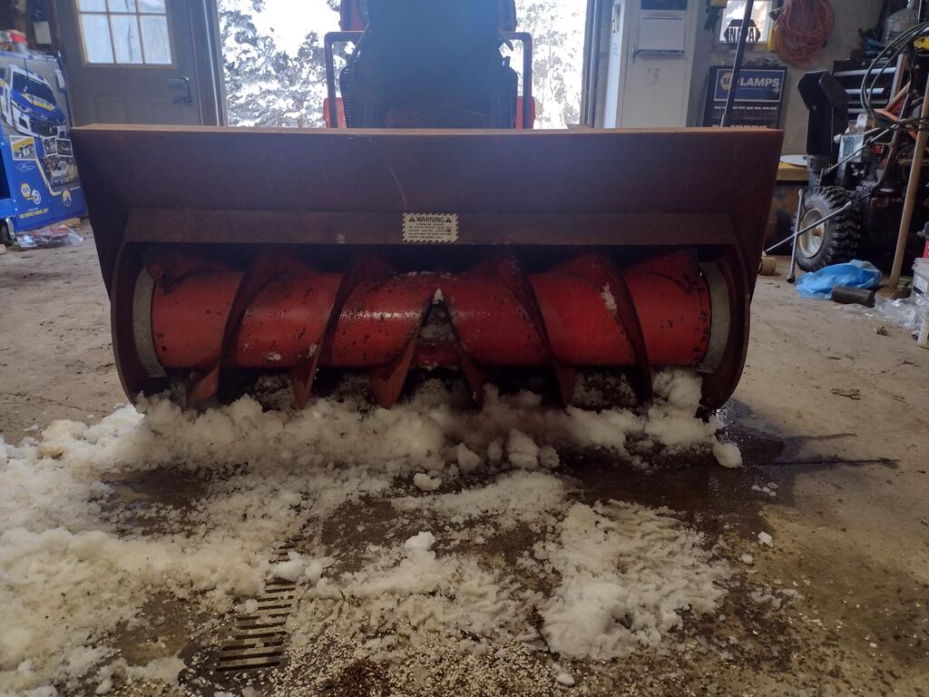

Bar Nuthin 3,246 #26 Posted January 17, 2025 20 minutes ago, BuffaloD200 said: If anyone has any insight, I would glad to hear it. Can you post some pictures? I've seen some posts where people were addressing wear or deformation of the augers - where they meet in the center to launch the snow. Share this post Link to post Share on other sites

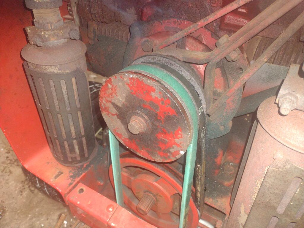

BuffaloD200 54 #30 Posted January 20, 2025 On 1/17/2025 at 4:57 PM, Bar Nuthin said: Can you post some pictures? I've seen some posts where people were addressing wear or deformation of the augers - where they meet in the center to launch the snow. I can do that. I'll snap some pictures later tonight. On 1/17/2025 at 7:17 PM, lynnmor said: Sounds like PTO slippage to me. The PTO is spinning great. Too well - that's what is melting the belt. On 1/17/2025 at 7:32 PM, Ed Kennell said: I think you found the problem. It for sure won't blow snow if the auger isn't turning. Now figure out why the auger seizes under load. Does the rotating auger spin freely and does it contact the housing. What appears to be happening is the chute can't keep up with the volume of snow the auger is chucking at it. Once the chute packs up the auger packs the back of the blower and stops the auger. I hadn't thought of the auger being out of whack, but that would make sense why its not sending the snow far away. Share this post Link to post Share on other sites

Ed Kennell 47,375 #33 Posted January 20, 2025 2 hours ago, BuffaloD200 said: The PTO is spinning great. Too well - that's what is melting the belt. Can you take a picture of the belt and the PTO pulley. If your belt is bottomed out in the pulley, It will slip. The belt has to grip on the sides . Share this post Link to post Share on other sites

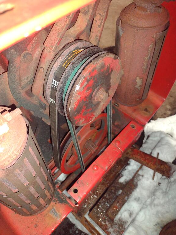

BuffaloD200 54 #34 Posted January 21, 2025 The auger looks straight to me, but you guys are the experts. Admittedly that first pass was a little fast, but it shouldn't clog that easily. You can see at the end of the video that this is cold fluffy snow, nothing heavy here. I walked alongside in that last video. Looked strong at first, but you can see it doesn't shoot far, then it clogged again. Very simple 2 pulley belt routing. No way to incorrectly install. Any help is appreciated Share this post Link to post Share on other sites
wallfish 20,618 #35 Posted January 21, 2025 If that front belt is for the blower , it's TOO small. You need to get the correct belt as that small belt will just simply slip easily in the pulley. It's bottoming out instead of gripping to the side walls of the pulley. Change it to a 5/8 wide belt 1 1 Share this post Link to post Share on other sites
Ed Kennell 47,375 #36 Posted January 22, 2025 (edited) On 1/20/2025 at 4:41 PM, Ed Kennell said: Can you take a picture of the belt and the PTO pulley. If your belt is bottomed out in the pulley, It will slip. The belt has to grip on the sides . That was an easy fix. Is it my old eyes , or is that auger actually running backwards in the first video? Edited January 22, 2025 by Ed Kennell 2 Share this post Link to post Share on other sites

Bar Nuthin 3,246 #38 Posted January 22, 2025 2 hours ago, Ed Kennell said: That was an easy fix. Is it my old eyes , or is that auger actually running backwards in the first video? Sure looks that way from the video, but capturing rotary motion on video can be tricky that way. It should definitely be pulling snow toward the center, not the outside. 1 Share this post Link to post Share on other sites
Ed Kennell 47,375 #39 Posted January 22, 2025 (edited) 12 hours ago, Bar Nuthin said: but capturing rotary motion on video can be tricky that way. Yeah, slow camera speed had all the wagon wheels turning backwards on old western movies. For now we will assume the auger is turning opposite from the video and that tiny 1/4" belt is slipping in that 5/8" pulley causing the auger to stop as soon as it feels a load. Edited January 22, 2025 by Ed Kennell 1 Share this post Link to post Share on other sites
Handy Don 17,479 #40 Posted January 22, 2025 15 hours ago, Ed Kennell said: Is it my old eyes , or is that auger actually running backwards in the first video? That was my first thought, too! Once I saw that snow was, indeed, coming out of the chute, however, I realized it was an artifact of the frame rate of the video! Also noticing: - the pulley on the engine is looking kinda rough and will need a good dressing to prevent it from from chewing up the new belt - a wider belt riding farther out on the pulley will speed up the auger action in addition to delivering adequate power Share this post Link to post Share on other sites

BuffaloD200 54 #42 Posted January 22, 2025 17 hours ago, wallfish said: If that front belt is for the blower , it's TOO small. You need to get the correct belt as that small belt will just simply slip easily in the pulley. It's bottoming out instead of gripping to the side walls of the pulley. Change it to a 5/8 wide belt I'm running the recommended 4L490W belt. That pulley has two widths, a 5L & 4L. I can try a 5L. Maybe a 5L480W or 470 would fit kinda ok in there. I'll bring one home tonight and test it. Its not easy to get a view of the lower pulley, but I don't believe there's any space for a wider belt on it. Share this post Link to post Share on other sites

Handy Don 17,479 #44 Posted January 22, 2025 8 minutes ago, BuffaloD200 said: I'm running the recommended 4L490W belt. That pulley has two widths, a 5L & 4L. I can try a 5L. Maybe a 5L480W or 470 would fit kinda ok in there. I'll bring one home tonight and test it. Its not easy to get a view of the lower pulley, but I don't believe there's any space for a wider belt on it. A dual-width pulley is a new thing for me. Interesting. Yes, important to check the other pulleys in that drive to be sure the wider on will fit. I’m surprised that a 40+ inch blower would spec a 4L -- these are typically used to transfer less than 3 horsepower. That blower would need at least 8 (and probably 10 or 12) to really do its job. Running a new belt farther out on the pulley means it’ll need to be LONGER than the 490, not shorter. Share this post Link to post Share on other sites
BuffaloD200 54 #45 Posted January 22, 2025 42 minutes ago, Handy Don said: That was my first thought, too! Once I saw that snow was, indeed, coming out of the chute, however, I realized it was an artifact of the frame rate of the video! Also noticing: - the pulley on the engine is looking kinda rough and will need a good dressing to prevent it from from chewing up the new belt - a wider belt riding farther out on the pulley will speed up the auger action in addition to delivering adequate power I could take a wire wheel or flap disc to that pulley and clean it up a bit Share this post Link to post Share on other sites
BuffaloD200 54 #46 Posted January 22, 2025 1 minute ago, Handy Don said: A dual-width pulley is a new thing for me. Interesting. Yes, important to check the other pulleys in that drive to be sure the wider on will fit. I’m surprised that a 40+ inch blower would spec a 4L -- these are typically used to transfer less than 3 horsepower. That blower would need at least 8 (and probably 10 or 12) to really do its job. Running a new belt farther out on the pulley means it’ll need to be LONGER than the 490, not shorter. I'll throw a caliper on it and get measurements. It certainly surprised me when I saw that in there. Both of my D's have the same pulley. Good call. Wasn't thinking clearly there. I'll grab a 500 & 510 Share this post Link to post Share on other sites
Handy Don 17,479 #47 Posted January 22, 2025 3 minutes ago, BuffaloD200 said: I could take a wire wheel or flap disc to that pulley and clean it up a bit I sometimes live on the wild side and have carefully used a strip of fine emory cloth wrapped around a piece of rope and “shoe shine" the sheave. Engine NOT running. 1 Share this post Link to post Share on other sites
BuffaloD200 54 #48 Posted January 22, 2025 On 1/21/2025 at 6:44 PM, wallfish said: If that front belt is for the blower , it's TOO small. You need to get the correct belt as that small belt will just simply slip easily in the pulley. It's bottoming out instead of gripping to the side walls of the pulley. Change it to a 5/8 wide belt I just installed a 5L500W. I suppose it fits alright. I did measure the width of the two pulleys - the one by the motor is about 21mm and the further is 17mm. Tested it with the 5L and had the same results. I just don't understand what could be the problem. Share this post Link to post Share on other sites
wallfish 20,618 #49 Posted January 23, 2025 (edited) Is that thing spinning backwards? Looking at the first video it can be deceiving sometimes but when you move to the side at about 12 seconds it looks more as though that chain on the sprocket is spinning it backwards. It should be spinning from the top to the bottom. Same direction as the tractor tires when moving forward. Edit: Watched again and again. It's spinning backwards. It's forcing snow in the auger out to the ends instead of to the middle. Chain routing wrong? Again, I'm not familiar with the D series setup but no matter what it needs to spin the correct direction Edited January 23, 2025 by wallfish 1 Share this post Link to post Share on other sites
