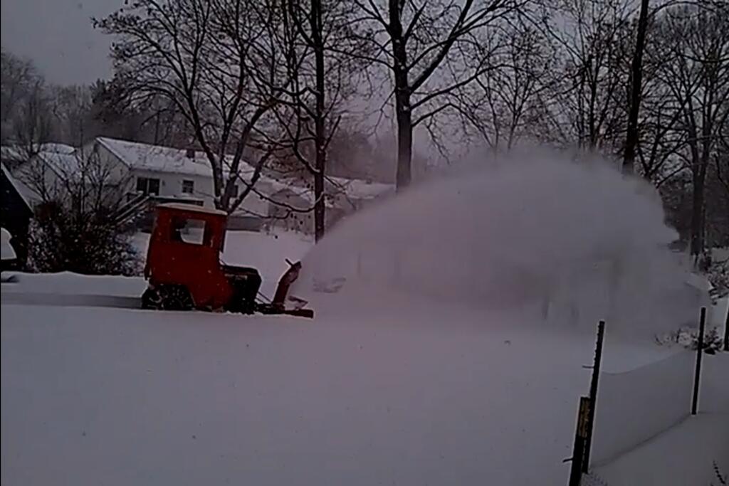

TonyToro Jr. 2,539 #5 Posted November 5, 2024 I’ve been using my C-145 with a tall chute single stage blower now I think for 3 or 4 seasons. Works great with the lighter snow and wet. As long as it isn’t slush it will throw it. (In the videos it was like a foot of kinda wet snow but mostly powder.) IMG_3377.mov cm-chat-media-video-1:921c5e01-9961-3138-8733-92850a611703:10989:0:0.mov 2 1 1 Share this post Link to post Share on other sites
