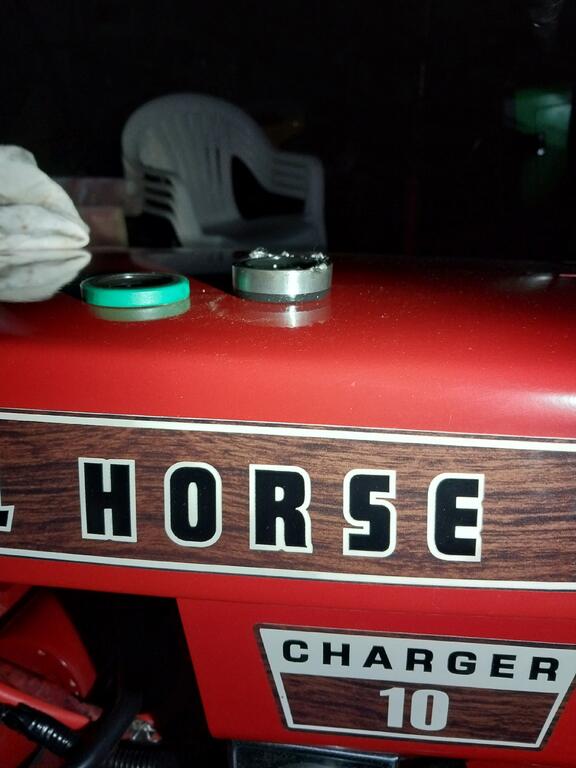

Mike_eash 59 #1 Posted October 31, 2024 Hello guys I am replacing an axle seal on my charger 10 Hydro tranny sunstrand I bought a replacement seal. However the one I pulled out is steel and much thicker then the rubber one I bought. See attached pics Does anyone know If the thinner rubber one works? Just seems much cheaper Does anyone have experience with those?? Any input is always appreciated Thanks in advance Also how can I tell if I have a bad wheelbearing? I heard that can cause seal leaks as well Share this post Link to post Share on other sites
953 nut 68,503 #2 Posted October 31, 2024 2 minutes ago, Mike_eash said: Also how can I tell if I have a bad wheelbearing? I heard that can cause seal leaks Take ahold of the end of your axle and attempt to move it up and down/forward and back. There should be NO movement at all. A bit of in and out is OK. 10 minutes ago, Mike_eash said: bought a replacement seal. However the one I pulled out is steel and much thicker then the rubber one I bought These are the ones I have used and have been very pleased with them. https://www.ebay.com/itm/142042768245 Share this post Link to post Share on other sites

Mike_eash 59 #5 Posted November 1, 2024 5 minutes ago, 953 nut said: My assumption was the it was up on stands because he had removed the axle seal. BUT, we all know what comes next. you make an a$$ out of you and me. It is on stands lol! I have maybe a 1/4" in and out play nothing up and down at all Assuming it's not my bearing from what you told me 2 1 Share this post Link to post Share on other sites
mrc 1,109 #6 Posted November 1, 2024 hi mike-eash, too bad you live so far away from me. i have those thick metal seals in stock in my garage. heck, you could bring over a six pack and i would give you one. you want to use the thick metal ones. regards mike 1 Share this post Link to post Share on other sites
Mike_eash 59 #7 Posted November 1, 2024 Would gladly bring a six pack for one lol! I ordered one on ebay from attached link above. Only problem is I gotta wait till Nov. 8th till it shows up. And I have leafs to mulch guess it will have to wait Thanks anyway 1 Share this post Link to post Share on other sites

rmaynard 17,527 #9 Posted November 1, 2024 (edited) Lowell sells a 6449 seal (metal) if you need them. https://wheelhorsepartsandmore.com/product/6449-axle-seal-for-hydrostatic-transmission/ Edited November 1, 2024 by rmaynard Share this post Link to post Share on other sites
953 nut 68,503 #10 Posted November 1, 2024 3 minutes ago, rmaynard said: Lowell sells a 6449 seal (metal) if you need them. https://wheelhorsepartsandmore.com/product/6449-axle-seal-for-hydrostatic-transmission/ Yes, he does sell seals under that name but they are the thin ones like @Mike_eash already has. I bought a pair of them years back but was reluctant to use them. The ones I have purchased on and passed along the link to have worked well and match what was used at the factory. Share this post Link to post Share on other sites
rmaynard 17,527 #11 Posted November 1, 2024 Just my opinion, but the advent of newer seal material has made seals work better. Because of that, I feel that the thinner seal will work just fine. Share this post Link to post Share on other sites
953 nut 68,503 #12 Posted November 1, 2024 23 minutes ago, rmaynard said: I feel that the thinner seal will work just fine. It probably would, just my OCD kicking in. Share this post Link to post Share on other sites

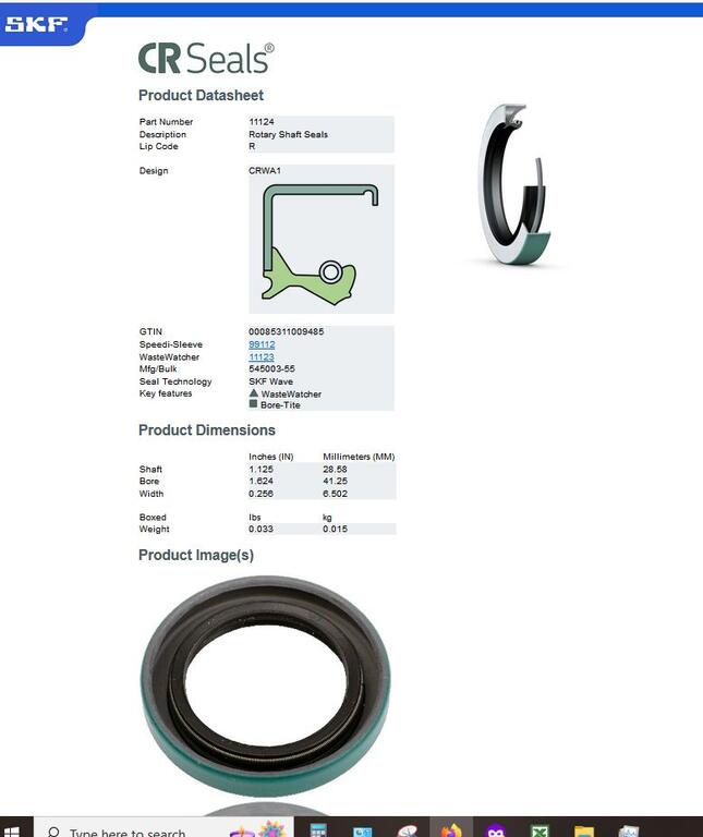

pfrederi 21,046 #13 Posted November 1, 2024 I have 7 sunstrands I have always used the CR 11124 seal. Never had any of them leak. 1 1 Share this post Link to post Share on other sites

Mike_eash 59 #17 Posted November 2, 2024 Thanks for all the info guys! Just an update I decided to use the thinner rubber seal so far so good! Seems to be working just fine 1 Share this post Link to post Share on other sites
