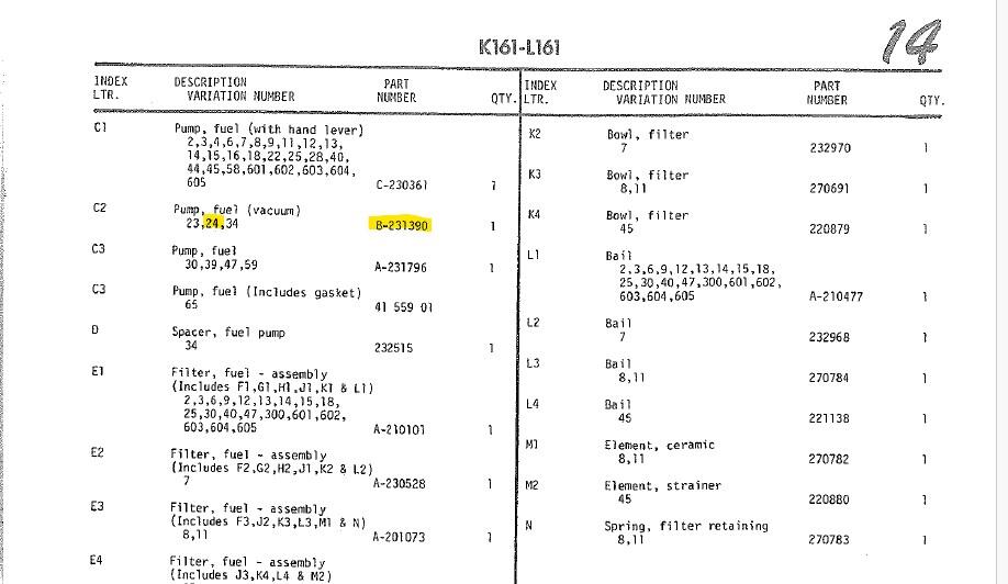

Walleye Guy 24 #3 Posted November 1, 2024 Thank-you for that manual! The good news is that by using my engine spec number it guided me to #24 (which is my variation number) to confirm that B-231390-S is the correct pulse pump. Unfortunately, I am unable to determine the correct number for the mechanical pump because, I believe, it would change the engine spec number. See attached file and you'll see that four pumps are listed (one is the pulse pump) as well as one fuel pump spacer. 1. C-230361 (pump with hand lever) 2. B-231390-S (pulse pump which we purchased) 3. A-231796 4. 41-559-01 Fuel pump spacer = 232515 Can one of the Wheel Horse gurus out there tell me which number is the mechanical pump that would fit my engine? Thanks in advance! Share this post Link to post Share on other sites

Walleye Guy 24 #5 Posted November 4, 2024 (edited) The one we bought was an NOS unit and, when initially installed, it didn't pump at all but then we realized that the oil fill plug was only finger tight. After tightening the fill plug it pumped a tiny bit but now it doesn't pump at all so we think either (a) the diaphragm broke or (b) the engine is a little tired and thus the pulse isn't so great so we thought we would switch over to a mechanical pump. I'm still hoping one of the Wheel Horse Gurus out there can tell me which of the P/N's I listed above would be the correct mechanical pump for our engine. Edited November 4, 2024 by Walleye Guy Share this post Link to post Share on other sites
