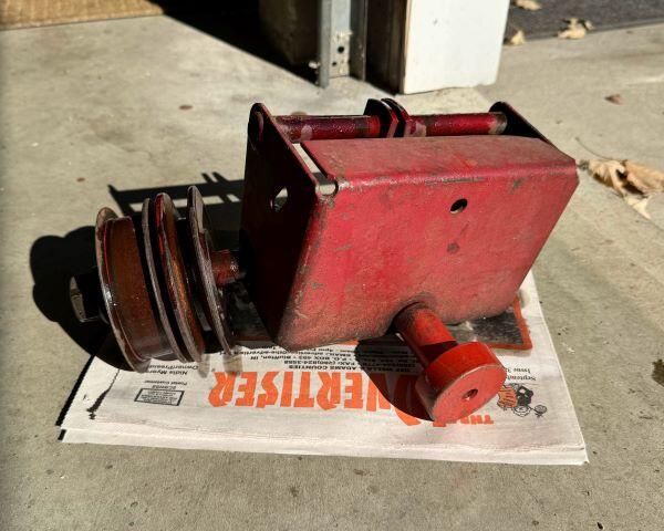

Bar Nuthin 2,564 #1 Posted October 27, 2024 Picked up this Mule Drive that has a steel adjusting knob. Is it an older design, or just someone's handywork? Share this post Link to post Share on other sites
Rick3478 454 #2 Posted October 27, 2024 1 hour ago, Bar Nuthin said: Picked up this Mule Drive that has a steel adjusting knob. Is it an older design, or just someone's handywork? My guess is someone's handiwork. It is, after all, just a fancy nut that anyone with a lathe could make. I think the factory would have knurled it, but I could be wrong. 1 Share this post Link to post Share on other sites
Blasterdad 3,167 #3 Posted October 27, 2024 The adjustment knob is home made. The pulleys are the solid steel ones with pressed in bearings which is GREAT! K&B Horse Parts makes a reproduction of that mule & it's expensive. The stock mules have riveted stamped pulleys, not as heavy duty. Nice score! 1 Share this post Link to post Share on other sites

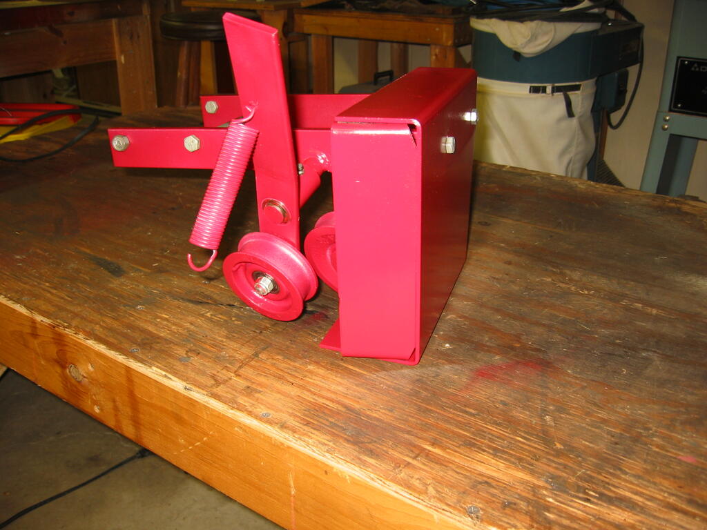

pfrederi 20,828 #4 Posted October 27, 2024 First year (or 2) mule drives looked like this 3 5 Share this post Link to post Share on other sites

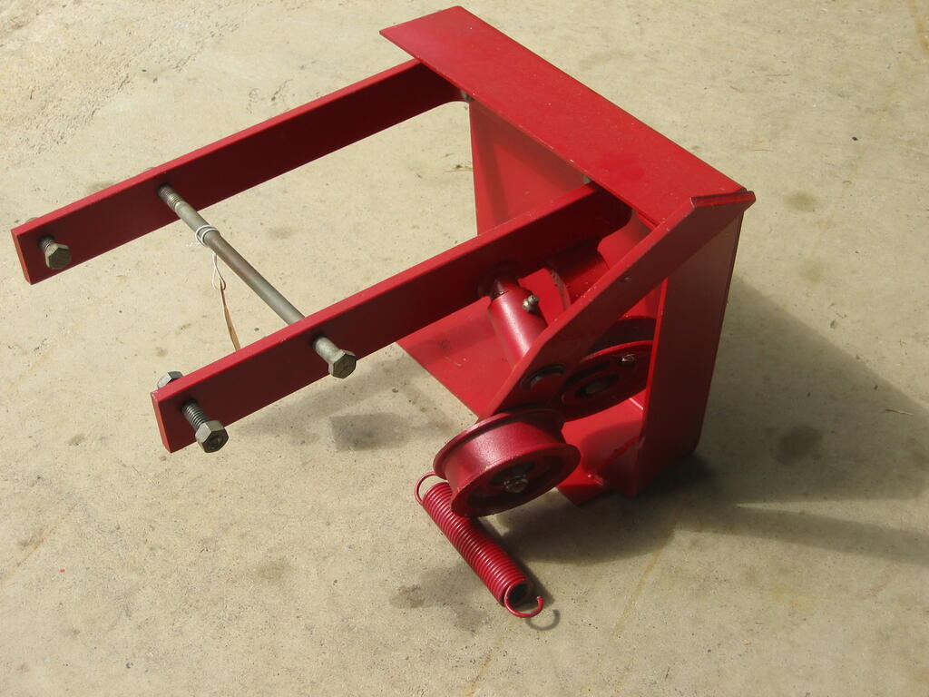

Ed Kennell 46,467 #5 Posted October 27, 2024 5 hours ago, Bar Nuthin said: someone's handywork? Looks better than some I have seen like a vice grips. One of my mule drive cranks. 2 Share this post Link to post Share on other sites

peter lena 9,934 #8 Posted October 27, 2024 @Bar Nuthin good opportunity to CLEAN OUT AND RE PACK RELATED BEARINGS , wide rubber side shields , remove easily , lucas 550 drop point hd green chassis grease , all 10 of the original bearings , known for whyining noise . except pto cone sealed outed and inner needle . really makes a deck quiet , and spin up very easily . pete 1 Share this post Link to post Share on other sites

76c12091520h 4,236 #10 Posted October 28, 2024 22 hours ago, Blasterdad said: The adjustment knob is home made. The pulleys are the solid steel ones with pressed in bearings which is GREAT! K&B Horse Parts makes a reproduction of that mule & it's expensive. The stock mules have riveted stamped pulleys, not as heavy duty. Nice score! That's news to me? 1 Share this post Link to post Share on other sites
Blasterdad 3,167 #11 Posted October 28, 2024 10 hours ago, 76c12091520h said: That's news to me? I'm sorry, I saw you had one at the big show, I thought you guys made them. Either way I was tempted, they are night & day better quality... 1 Share this post Link to post Share on other sites
