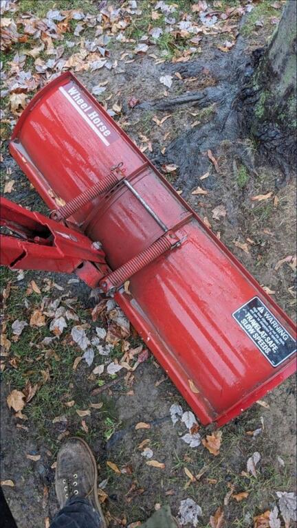

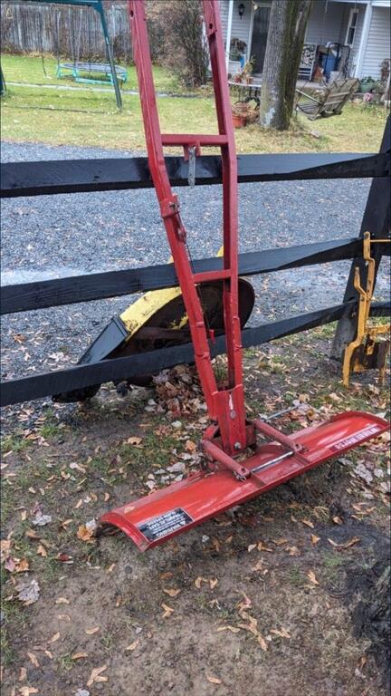

Alrashid2 476 #1 Posted October 25, 2024 Hey guys. Just saw this posted near me and was wondering if it would fit my 312-8. Do you guys know? How can I confirm? Are they easy to install/uninstall? Do you typically leave your plow installed? Thanks guys! In case link doesn't work, attached photos. No info or description Share this post Link to post Share on other sites

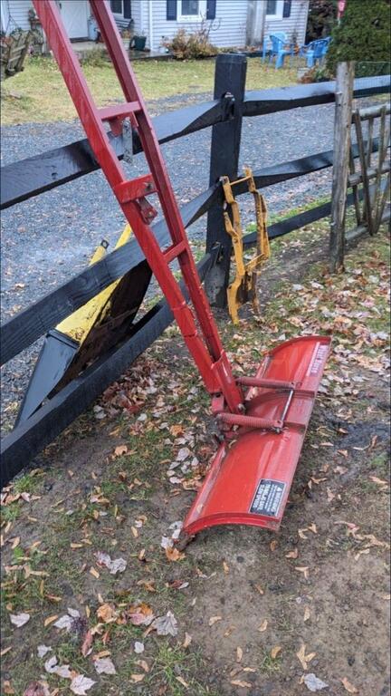

JCM 11,342 #2 Posted October 25, 2024 (edited) Has that plow frame been cut and length added near the blade end on both sides, looks odd ? Otherwise looks decent. Short frame plow turned into a long frame ? Yes , easy to install and remove. Edited October 25, 2024 by JCM 1 Share this post Link to post Share on other sites
Alrashid2 476 #3 Posted October 25, 2024 Thanks for replying. I'm not sure to be honest. Trying to get more info. He wants $175. Considering how hard it seems to be to find WH stuff around me I thought maybe I should buy it if it was a good deal 1 Share this post Link to post Share on other sites
mrc 1,108 #4 Posted October 25, 2024 jcm, maybe the plow 'A' frame was lengthened a few inches to clear a FSA on a 520??? other than that looks good. wish it was closer i would buy it regards mike 1 Share this post Link to post Share on other sites

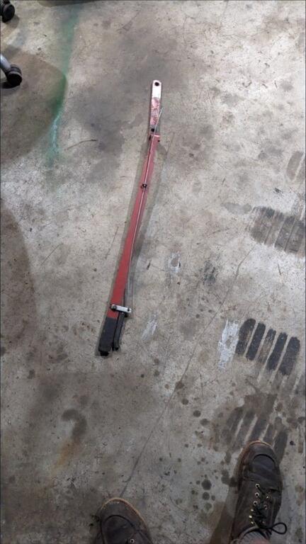

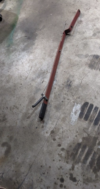

MainelyWheelhorse 3,011 #5 Posted October 25, 2024 @Alrashid2 In my experience with mine on my 308 and 312, if it hasn’t been lengthened it should fit. You will need the mount for it that goes on the rear axle. You may have to modify or make another handle to operate the swivel side to side, The one shown might contact the right footrest when the handle is back. I have a similar plow and had that issue. It is a nice plow though and it looks in good condition. It’s worth the money. Share this post Link to post Share on other sites
Ed Kennell 46,797 #6 Posted October 25, 2024 11 hours ago, mrc said: maybe the plow 'A' frame was lengthened a few inches to clear a FSA on a 520??? would be my guess. If you are ever in the York area, I still have a 54" blade with long frame and axle bracket. PM me if interested. 1 Share this post Link to post Share on other sites
squonk 47,748 #7 Posted October 25, 2024 Looks like it was lengthened. For a 520 probably. It will fit and just stick out the front farther. Share this post Link to post Share on other sites
