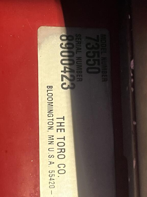

gwest_ca-(File Mod) 12,452 #2 Posted October 24, 2024 Have a tractor model number and serial number? There was a change in filter numbers between oldest and newest tractor model/serial numbers Share this post Link to post Share on other sites
stevebo-(Moderator) 8,742 #3 Posted October 24, 2024 Share this post Link to post Share on other sites
stevebo-(Moderator) 8,742 #4 Posted October 24, 2024 Fram oil filter XG3614 Wix oil cross is 51348 Toro fuel filter 63-8300 3.5 quarts engine oil Share this post Link to post Share on other sites
gwest_ca-(File Mod) 12,452 #5 Posted October 24, 2024 Toro parts lists are vague. Used B&S parts list by engine and spec number B&S air filter 820263 - Wix 46449 - Toro 93-2195 B&S fuel filter 820311 - Wix WF8059 has sensor port on end cap - 3.26" dia and 4.803" tall B&S oil filter 820314 or 692513 - Wix 51394 - Toro 99-9017 2 Share this post Link to post Share on other sites
