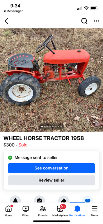

englertstephen 14 #7 Posted November 12, 2024 Just bought this one with a Briggs and full pipe thread exhaust with muffler. I can send more pics of exhaust tomorrow. Share this post Link to post Share on other sites
