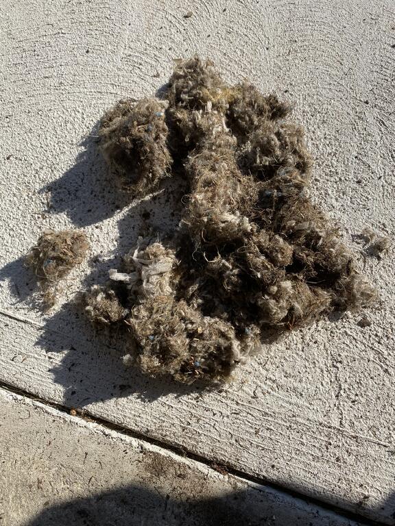

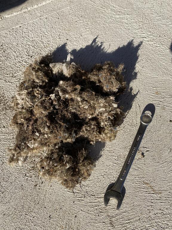

JimSraj 593 #1 Posted October 22, 2024 Another thing to add to the checklist for ‘new to me ‘ tractors. Remove the tins that surround the engines. Check out the mouse nest material I removed from the 312-8 that followed me home last summer. 7 Share this post Link to post Share on other sites

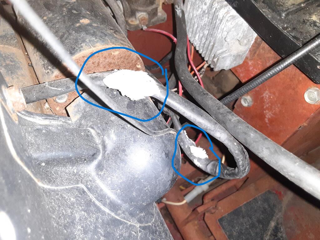

BBQVultureWings 160 #2 Posted October 22, 2024 (edited) The wiring of my new to Moo-Wah C-145 with rusted out deck & a Snowblade that followed Moo-Wah home Sunday night has been used as a chew toy by rhodents. You probably saved yourself quite a headache getting rid of that. It is Shocking what those little characters can do to evrything.... Edited October 23, 2024 by BBQVultureWings to include a picture 2 Share this post Link to post Share on other sites
Easton Rich 1,296 #3 Posted October 22, 2024 That stuff catches fire, it happened to my 418a 2 Share this post Link to post Share on other sites
ebinmaine 81,282 #4 Posted October 22, 2024 5 hours ago, JimSraj said: Remove the tins Absolutely necessary. It should be on the list in the thread we all made. I'll check it later. 1 1 Share this post Link to post Share on other sites
Ed Kennell 47,947 #5 Posted October 22, 2024 Clearing the air flow on an air cooled engine is as important as checking the fluid in a liquid cooled engine. 4 3 Share this post Link to post Share on other sites
