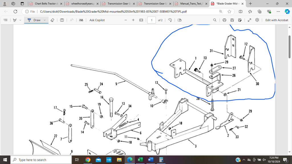

gwest_ca-(File Mod) 12,346 #4 Posted October 18, 2024 Welcome to Red Square 79351 fits the 300, 400 and 500 series of tractors. Here is what the D-Series used 1 Share this post Link to post Share on other sites

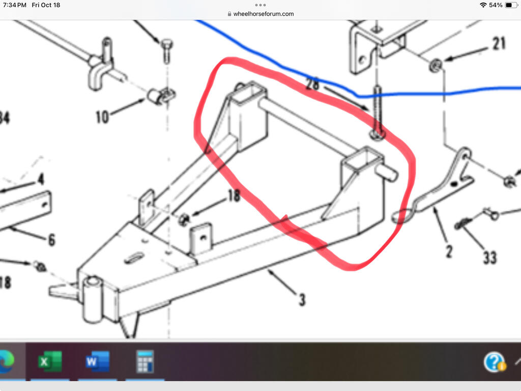

c-series don 12,110 #5 Posted October 18, 2024 A quick way to tell if it’s for a D-Series is this drop in the frame circled in red. Share this post Link to post Share on other sites
