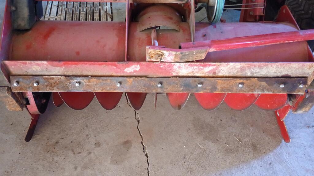

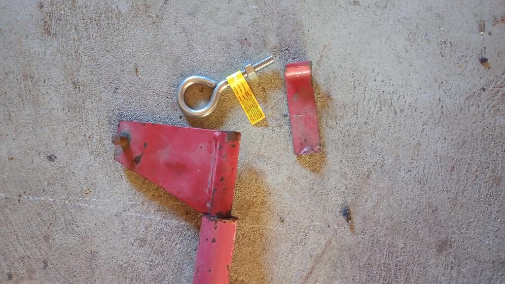

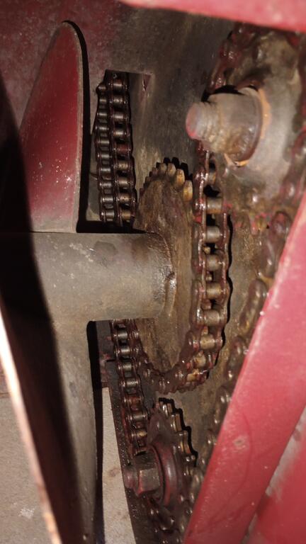

AlexR 3,057 #1 Posted October 17, 2024 Got this snowblower for a pretty good deal I think. It was $125. Getting it tuned up for winter, flipped the scraper blade and got new stainless hardware for it. And Adjusted the shoes to keep the blade slightly off the ground might have to adjust those more once I start using it. Adjusted the chain tension. And going to weld a tab on the flag rod to match the factory spring assist lift. Since mine doesn't have that and I don't have any hydraulic lift tractors. Is there anything you guys use to coat the inside area of the blower and the chute? 3 Share this post Link to post Share on other sites
peter lena 9,934 #2 Posted October 18, 2024 @AlexR lots of things to make it run/ operate better https://www.google.com/search?q=snow+blower+spray+walmart&rlz=1C1CHBF_enUS866US866&oq=snow+blower+spray&gs_lcrp=EgZjaHJvbWUqCAgDEAAYFhg , inside chute spray , you can also , make up , snow slide , PLASTIC AND MAKE UP A CHUTE BOTTON SLIDE GASKET . silicone spray , swings with ease , also note blower drive belt , pulley frame set up enhance lubrication on pulleys and pulley frame . use , chain / cable spray , on drive chain , napa has that MACS BRAND ,1/2" deflexion on chain ,adjust at same side drive bottom . use adjustable wrench on the auger center bends , easy to bend back , with adjustable wrench . had a couple of those , detail in lubrication , and drive belt set up from engine , makes for very easing running , had it up on a 4x4 off floor , for easy mounting , lift arm , has an inside hole on pick up point , helps in lifting , get some mineral oil on that paint , wipe it down , looks better , pete 1 Share this post Link to post Share on other sites

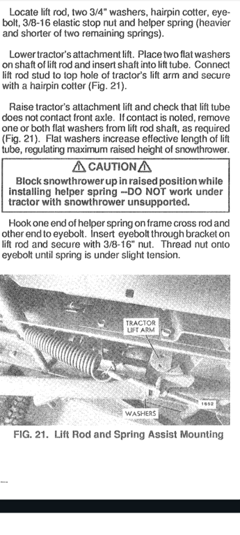

JimSraj 583 #3 Posted October 18, 2024 Anyone have good pictures of where/how that lift assist spring is attached on the flag and the tractor? Share this post Link to post Share on other sites
AlexR 3,057 #4 Posted October 18, 2024 8 minutes ago, JimSraj said: Anyone have good pictures of where/how that lift assist spring is attached on the flag and the tractor? 2 Share this post Link to post Share on other sites
JimSraj 583 #5 Posted October 18, 2024 Alexa, thanks for the quick response. I’ve seen that picture before but I guess I’m a little dense but I can’t make out where and how the eyebolt is inserted. Is there something welded to the flag or top of the tube the bolt goes through? 1 Share this post Link to post Share on other sites
gwest_ca-(File Mod) 12,323 #6 Posted October 18, 2024 The illustration in the parts list should help 1 Share this post Link to post Share on other sites

JimSraj 583 #9 Posted October 18, 2024 8 hours ago, gwest_ca said: The illustration in the parts list should help Perfect, easy enough. I can easily add that to the flag I’ve made. Thank you! Share this post Link to post Share on other sites
JimSraj 583 #10 Posted October 18, 2024 1 hour ago, Ed Kennell said: Thanks Ed that makes it very clear. Easy enough to add to the flag before painting. 2 Share this post Link to post Share on other sites

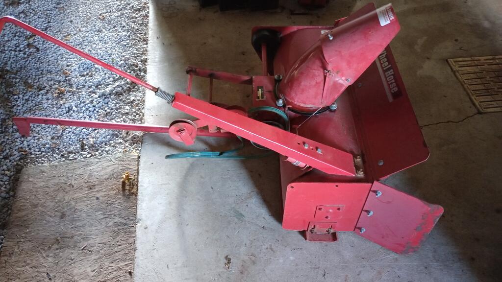

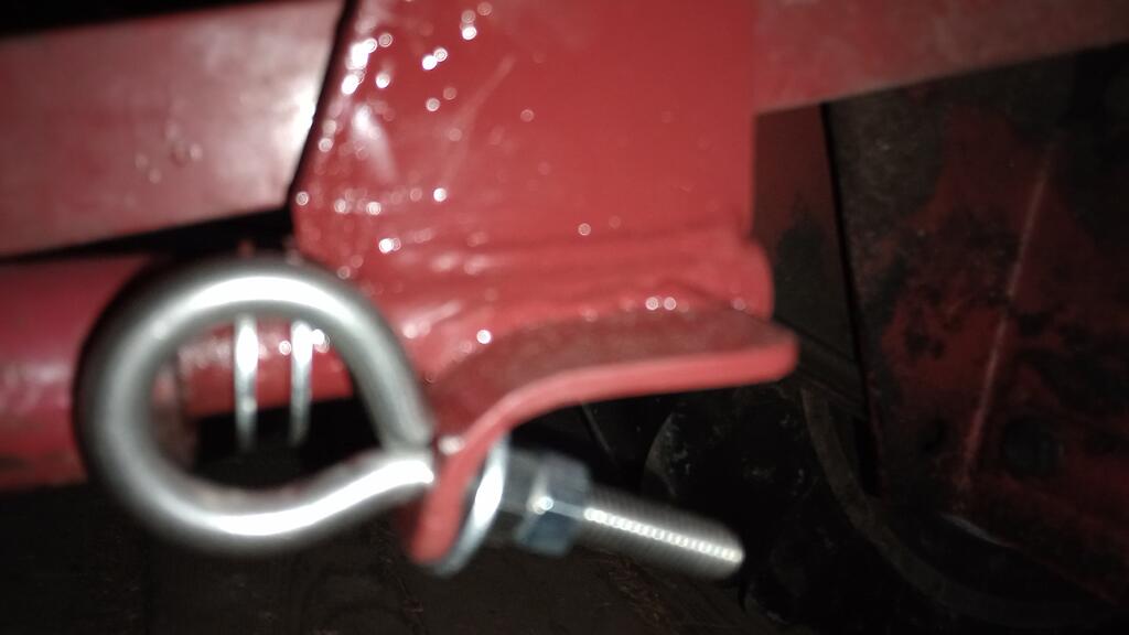

AlexR 3,057 #12 Posted October 19, 2024 Got the snowblower mounted and working now. Welded the tab on the flag for the eyebolt. Just need to get a spring for it now. 2 1 Share this post Link to post Share on other sites

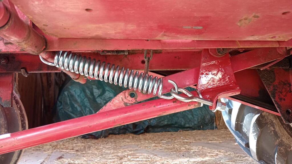

AlexR 3,057 #13 Posted October 20, 2024 Got the blower sprayed down with pb silicone lubricant pre-seasoning. I will spray it down again before we get a snowstorm. And got a spring installed, For keeping it parked I put 4x4 blocks under the skids to keep less tension and weight on everything while it's parked. 1 1 Share this post Link to post Share on other sites

JimSraj 583 #15 Posted October 24, 2024 On 10/20/2024 at 4:26 PM, AlexR said: Got the blower sprayed down with pb silicone lubricant pre-seasoning. I will spray it down again before we get a snowstorm. And got a spring installed, For keeping it parked I put 4x4 blocks under the skids to keep less tension and weight on everything while it's parked. Where did you get the spring? Looks perfect! 2 Share this post Link to post Share on other sites

AlexR 3,057 #17 Posted October 26, 2024 On 10/23/2024 at 8:16 PM, JimSraj said: Where did you get the spring? Looks perfect! Menards it's a 1 3/8" x7" long .207 wire diameter. $14.49 I did have to cut part of the hook off one end to fit over the crossbar. 1 Share this post Link to post Share on other sites
