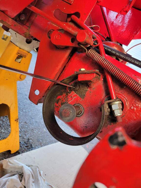

mrc 982 #1 Posted October 17, 2024 hi all, i have an oddball type leak on an 8 speed tranny. i placed the tractor on jackstands. i removed the wheels and power washed the tranny. you could almost eat off the tranny at that point. i started the tractor and with the hubs spinning i thought the brake shaft seal was leaking so i changed that seal. nope. the leak is coming thru a 'plug' just to the left of the brake shaft. the 'plug' seems to be like a freeze plug in the case of the tranny. this 'plug' is just under the tab where the brake band bolts onto the tranny. i have never seen this before and do not know how to proceed. any help is appreciated thank you mike Share this post Link to post Share on other sites

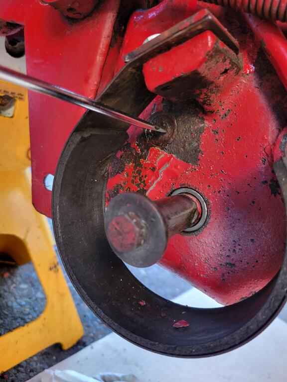

mrc 982 #4 Posted October 17, 2024 (edited) here are a couple pics. i'm looking at it and i think it is on the shaft that has the drive belt pulley on the other side of the tranny Edited October 17, 2024 by mrc Share this post Link to post Share on other sites
stevasaurus 23,427 #6 Posted October 17, 2024 That is your input bearing shaft...you still have to open the trans to replace it. That is a 5/8 x 13/16 x 3/4 WH#1531 Torington #M-10121. Thank you fior the picture...the information in this post is correct. 1 Share this post Link to post Share on other sites

mrc 982 #9 Posted October 17, 2024 steve, i know you are the manual tranny guru of RS. i just do not understand how changing the bearing will stop the leak. there must be a seal outboard of the bearing??? once i split the cases what else am i in for? Share this post Link to post Share on other sites
Lagersolut 746 #10 Posted October 18, 2024 (edited) 3 hours ago, mrc said: steve, i know you are the manual tranny guru of RS. i just do not understand how changing the bearing will stop the leak. there must be a seal outboard of the bearing??? once i split the cases what else am i in for? It’s a closed cup needle bearing - from what I see it shows rust - the cup probably rusted through - you have a pin hole on the facing of the bearing cup . Edited October 18, 2024 by Lagersolut 3 Share this post Link to post Share on other sites
stevasaurus 23,427 #11 Posted October 18, 2024 Motion Industries has the bearing, Like was said above, it is closed (capped) on one end. For now a finger of bondo would stop the leak or maybe even silacone might work. There is no real presure behind there. If the bearing sounds good you may be alright. https://www.motion.com/products/sku/00090868;origin=sayt 3 Share this post Link to post Share on other sites
