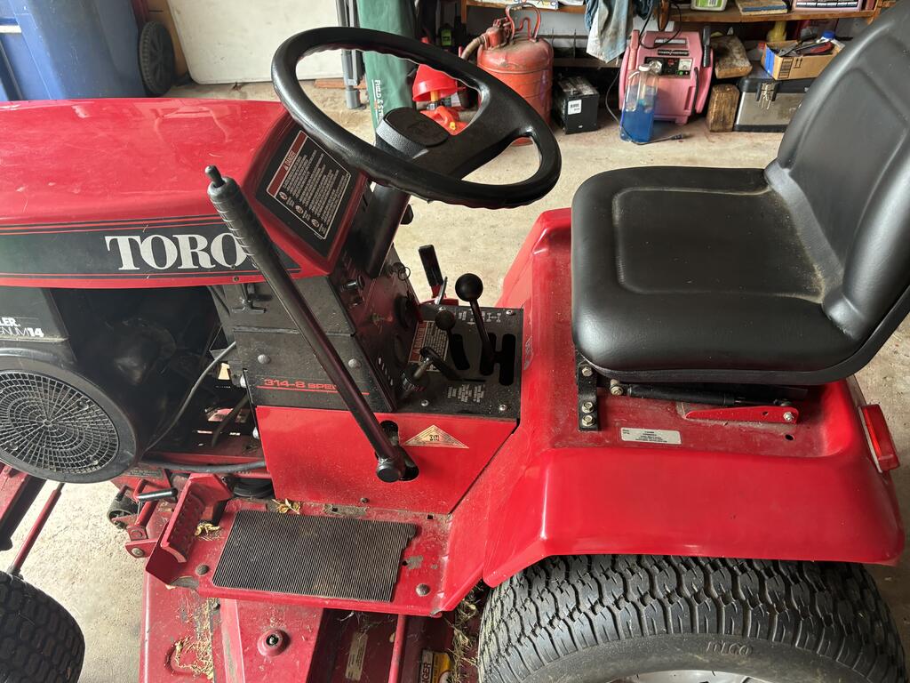

Jerzguy2 23 #1 Posted October 17, 2024 Can anyone help me with the procedure to remove the starter from this motor??? The dipstick is in the way, and I removed the one bolt to the bracket and Positive wire. What is the next step? Thanks Share this post Link to post Share on other sites

Lane Ranger 12,031 #5 Posted October 17, 2024 (edited) You have to loosen uo some of the outside motor tin to get access to that Magnum starter. Not as easy as the Kohler K series motors but not a major issue either. Edited October 18, 2024 by Lane Ranger 2 Share this post Link to post Share on other sites
pfrederi 20,874 #6 Posted October 18, 2024 Make sure you follow the manual about taping the end on the starter motor as you remove it. Mounting bolts double duty holding the end caps on the starter 1 Share this post Link to post Share on other sites
rick 305 #8 Posted October 18, 2024 Take the dipstick tube off, it is above the oil level. It would be handy to have a new gasket just in case. Share this post Link to post Share on other sites
