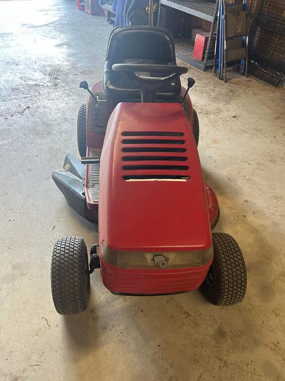

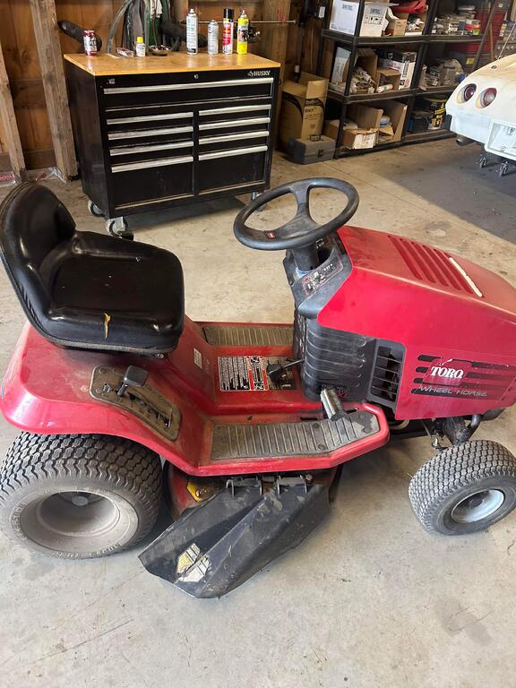

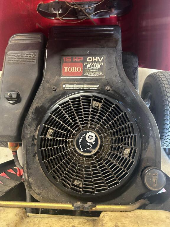

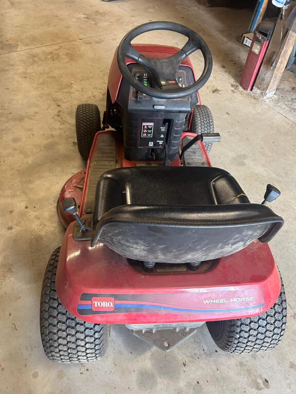

courtneysg3 0 #1 Posted October 17, 2024 Hello my name is Sean and I just bought a toro wheel horse 16-38 xl that keeps constantly surging I put a brand new aftermarket carburetor and a brand new aftermarket air filter, put a brand new oil filter, and even gave it a fresh oil change, but nothing is working to stop the surging. The engine is a Briggs and Stratton Q28q777-6190-E1 and the engine is from 1999 I am strongly suspecting the governor spring is bad. The previous owner who sold it to me messed around with the machine so he might have damaged the governor spring I ordered a new one because it was stretched out not horribly but enough to cause it to surge. I am not sure if the surging is normal or not any suggestions on how to fix it besides replacing the engine would be much appreciated. I hope that my toro wheel horse 16-38 xl is acceptable and not too new for this forum Share this post Link to post Share on other sites

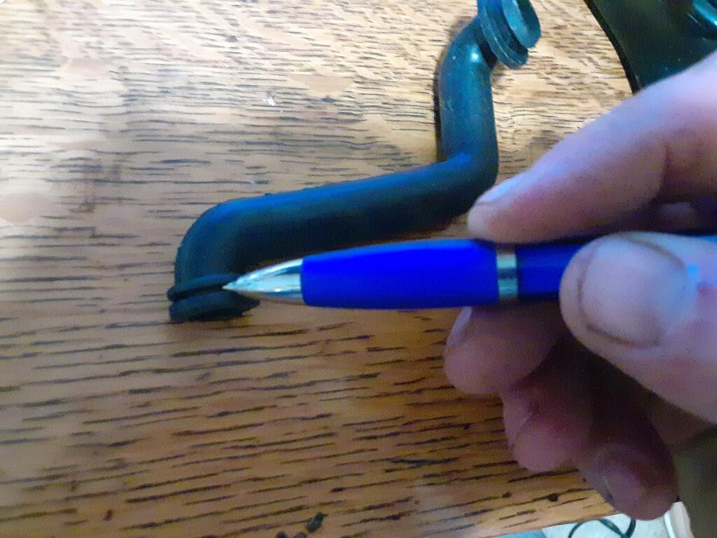

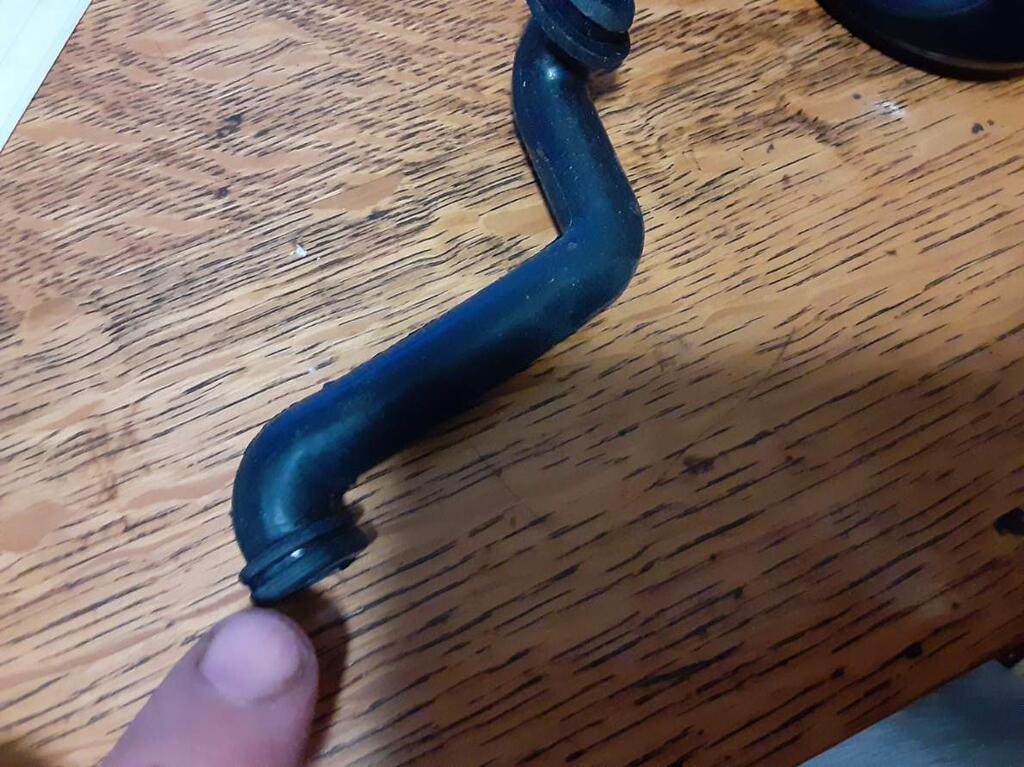

BBQVultureWings 160 #7 Posted October 22, 2024 (edited) I had a surging problem with a Briggs 15HP & it turned out to be the breather tube that goes from the air cleaner to the block. The thing had worn through from vibration & probably the p.o. or their "mechanic" not being careful about removing it for cleaning or maintenance. All above suggestions are most excellent. I would Check for this also as it fixed the problem. Sometimes they get dry rotted & fail also. My governor was in good shape & the spring was good n strong so I figured it was sucking air from somewhere.... here is a picture of a new tube with the pen pointing at where the tear was on the old 1 I already threw away. earlier this summer. I bought the scAmazon 4 pack as it was only $5 more than a single 1. Hope that helps. Edited October 22, 2024 by BBQVultureWings Share this post Link to post Share on other sites
