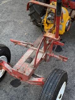

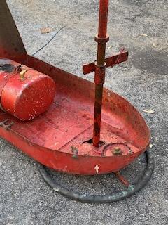

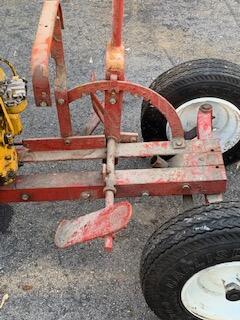

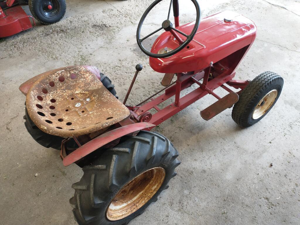

jsp_333 294 #1 Posted October 14, 2024 Picked up my first Suburban recently. I think this is a 551 but don’t really know. There appears to be a place for a battery. Which means electric start which I wasn’t expecting. I know the engine is wrong (k-91) The PO tried to put a bigger engine in it. Numbnuts. AlSo I think the steering column collar has been cut from the tower and will have to be welded back in place. Yes No? Is the tower missing a support. Should it have two supports like the Rj’s? There are no I’d tags on it anywhere. 1 Share this post Link to post Share on other sites

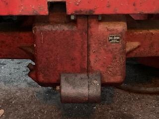

jsp_333 294 #3 Posted October 14, 2024 Does 2 piece transmission refer to the Trans case like in the photo or does it refer to something internal Share this post Link to post Share on other sites
953 nut 68,162 #4 Posted October 14, 2024 Yes, that is a two piece transmission. Share this post Link to post Share on other sites

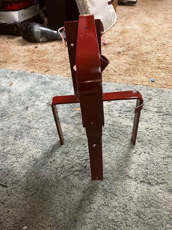

jsp_333 294 #5 Posted October 14, 2024 Great thx 953Nut. So next problem- what should the tower look like? Any one have photos of a 551 tower? Share this post Link to post Share on other sites
wallfish 20,384 #6 Posted October 14, 2024 5 minutes ago, jsp_333 said: Great thx 953Nut. So next problem- what should the tower look like? Any one have photos of a 551 tower? Yup, it's a 551. Most of the original hood stand is there. On the right side the flat bar steel would come down to a square where the battery would fit. You can see some 551 pics here in the photo gallery 1 Share this post Link to post Share on other sites
oliver2-44 11,662 #7 Posted October 15, 2024 (edited) The cast foot rest and the round hole in the hood are correct for 1961. The 1961 401 had a k91 pull start and the 551 had a Tecumseh H?55 electric start. I can't tell if the front rims are correct for the 59-61 tractors. These rims are getting harder to find. With them and the tires looking and the rest of the tractor looking untouched I would suspect they may be a newer style rim. its obvious the steering shaft hole in the hood has been cut. Edited October 15, 2024 by oliver2-44 Share this post Link to post Share on other sites
jsp_333 294 #8 Posted October 15, 2024 So I’ve got a 196? Suburban 551 I’ll get working on the Tecumseh. it looks like I need to build the battery box out of flatbar. Still not sure how the steering column attaches to the hood support tower. Share this post Link to post Share on other sites

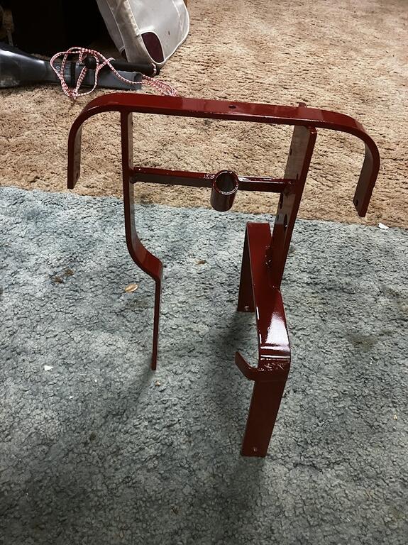

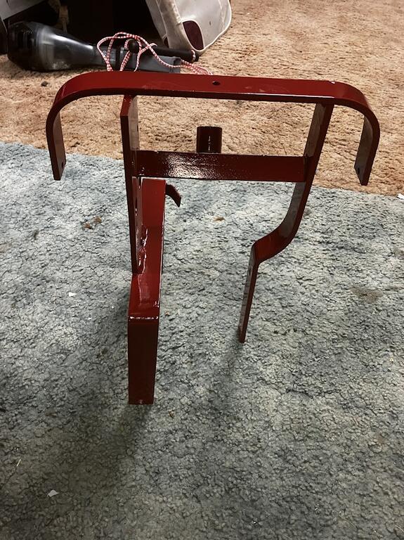

oliver2-44 11,662 #9 Posted October 15, 2024 (edited) 56 minutes ago, jsp_333 said: So I’ve got a 196? Suburban 551 I’ll get working on the Tecumseh. it looks like I need to build the battery box out of flatbar. Still not sure how the steering column attaches to the hood support tower. Yours is a 1961 suburban 551. I have an installed battery box hood support. I’ll get pictures if I can get to it in storage. PS. The Tecumseh HH 60 is identical on the outside except for the small model number stamped on the tin. Edited October 15, 2024 by oliver2-44 1 Share this post Link to post Share on other sites
jsp_333 294 #10 Posted October 15, 2024 7 hours ago, oliver2-44 said: Yours is a 1961 suburban 551. I have an installed battery box hood support. I’ll get pictures if I can get to it in storage. That would be fantastic. Thx.👍 Share this post Link to post Share on other sites

oliver2-44 11,662 #14 Posted October 17, 2024 @jsp_333 Here ya go! 2 Share this post Link to post Share on other sites
jsp_333 294 #15 Posted October 17, 2024 Thank You Thank You Thank You And not welded to the frame. Obvious;y. I need to have a closer look at what I've got Share this post Link to post Share on other sites
