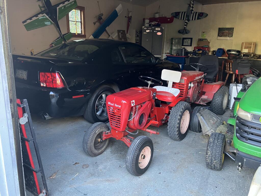

WH654 23 #1 Posted October 14, 2024 Hello All, I just bought a nice 552 and the wiring is quite a mess the way it’s all set up. I wonder if somebody that has an original 552 could post some detailed photos with the hood off to give me ideas on how to clean up my wiring? 1 Share this post Link to post Share on other sites
wallfish 20,154 #2 Posted October 14, 2024 (edited) Looks like your 552 has been changed to a 702, or the 702 had it's belt guard changed to a 552 A 552 would have had a Tecumseh (Lauson) engine and that would be a magnito ignition engine. That Kohler engine on there is a battery ignition engine. The wiring is different for those engines My advice would be to clean up or rewire what's there. You can buy 1/2" wire loom to cover the wires for a cleaner look Edited October 14, 2024 by wallfish 2 2 Share this post Link to post Share on other sites
ri702bill 12,383 #3 Posted October 14, 2024 I agree with @wallfish that there is a Kohler engine in it - 7 or 8 HP it has the later 8HP S/G belt guard with the big button dimple - the 702 had a smaller bump-out. Download the manual for the 854 wiring... Nice find. 1 Share this post Link to post Share on other sites
WH654 23 #4 Posted October 14, 2024 Thanks, Wallfish, I figured it’s got a mixed match of parts. I’m calling it a 552 because the previous owner put 552 stickers on it. He says it’s either a seven or eight horse Kohler that he put on it, he couldn’t remember which. I was looking for a nice clean 604 cause that’s what I had while growing up. But, I’m glad I got 1962 tractor because I like the mustache style front axle on it. 1 Share this post Link to post Share on other sites

ri702bill 12,383 #6 Posted October 14, 2024 13 minutes ago, WH654 said: Thanks, Wallfish, I figured it’s got a mixed match of parts. I’m calling it a 552 because the previous owner put 552 stickers on it. He says it’s either a seven or eight horse Kohler that he put on it, he couldn’t remember which. I was looking for a nice clean 604 cause that’s what I had while growing up. But, I’m glad I got 1962 tractor because I like the mustache style front axle on it. That was the last year of the vertical spindle axle - 1963 saw the beginning of the cambered axle and tie rods, not the flat tie bar. Cambered axles steer easier, with a greatly reduced turning radius... Share this post Link to post Share on other sites

WH654 23 #8 Posted October 14, 2024 35 minutes ago, ri702bill said: That was the last year of the vertical spindle axle - 1963 saw the beginning of the cambered axle and tie rods, not the flat tie bar. Cambered axles steer easier, with a greatly reduced turning radius... Very cool info. it’s funny when I went and looked at the tractor I was shocked to see the flat tie bar, and I thought somebody had jury rigged it that way. I was impressed at how tight everything was, and then I realized, after looking at the owner manual online that it was factory. lol. now I’m gonna have to get an 854 just so that I can experience both styles axles. 2 1 Share this post Link to post Share on other sites
