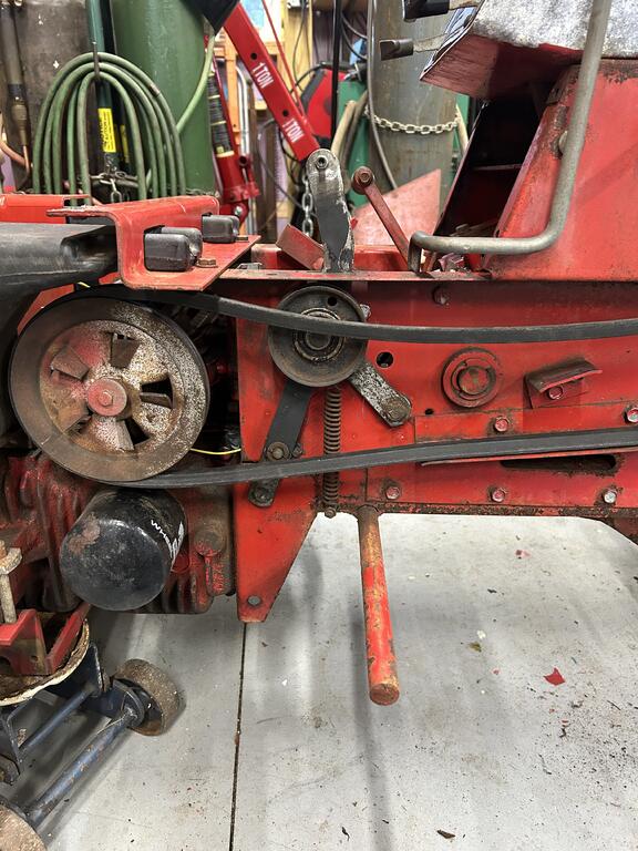

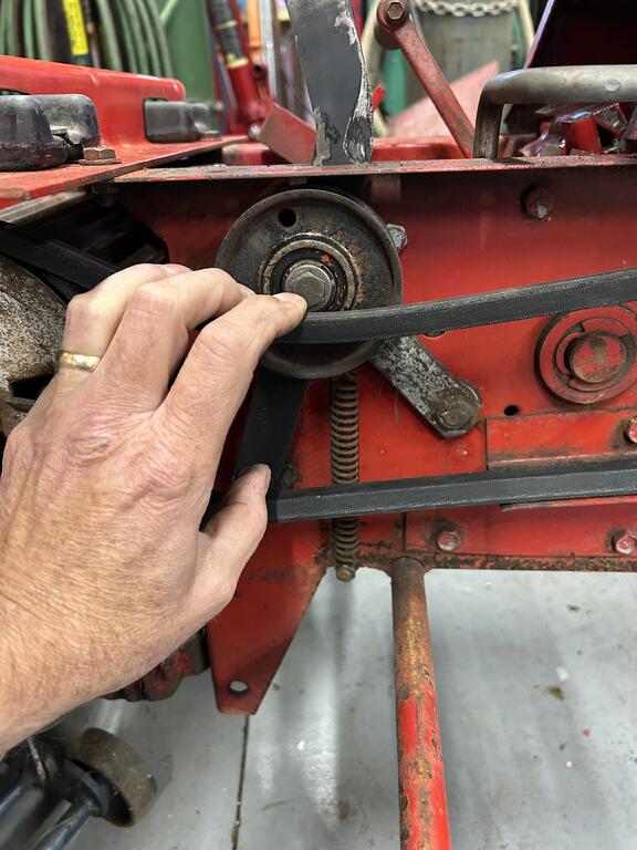

Scot 1966 8 #6 Posted October 14, 2024 I took the belt off, and it measures 84”, however, it is thicker than 5/8”. It measures .700” across the flat, which is .075” over 5/8”. I’m wondering if my problem is because the belt is wider, the width is preventing it from properly seating in the pulleys? The brand of this belt is D&D power sports, and came from Amazon. The top picture is with me pulling it down as far as I can, and the tensioner is all the way up, so you can see that there is no way the tensioner pulley will fit on top of it. I’m thinking of trying the TSC Kevlar belt that was recommended. 1 Share this post Link to post Share on other sites
953 nut 69,726 #7 Posted October 14, 2024 Your belt cross section should be the HB as shown below, 21/32", same as a 5L belt 1 Share this post Link to post Share on other sites

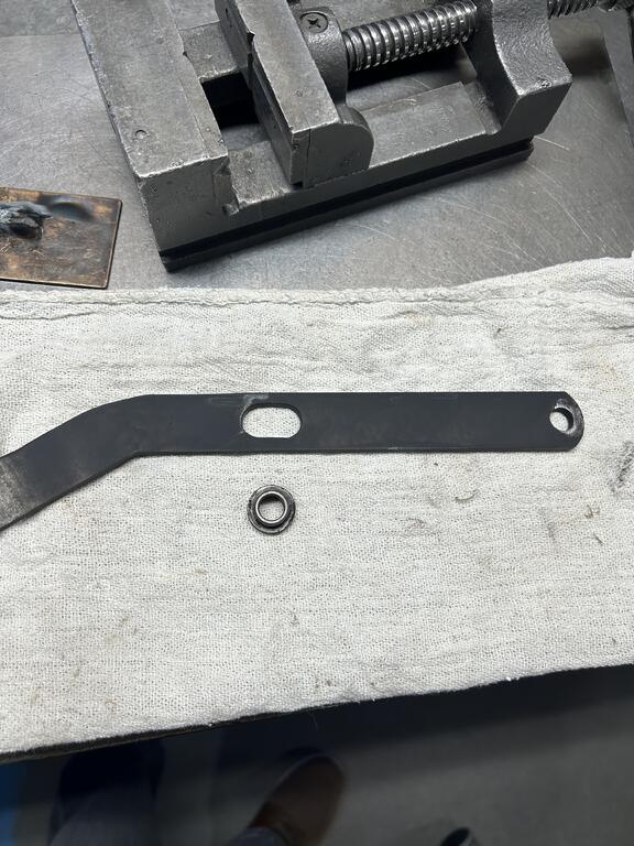

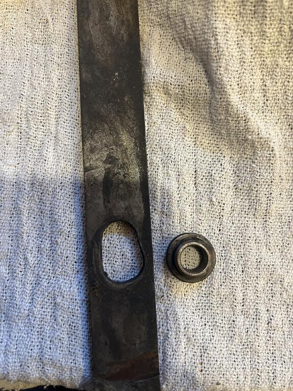

Scot 1966 8 #10 Posted October 15, 2024 The slot was worn in the tensioner arm. I welded the oval section, and machined it. It moves freely now, and the pulley turns with ease. My first issue is the 84” belt seems too short, and will not fit under the tensioner pulley. 2 Share this post Link to post Share on other sites

953 nut 69,726 #13 Posted October 27, 2024 On 10/14/2024 at 8:38 PM, Scot 1966 said: It’s close, but the 21/33” on the flat is .700” The wider belt is not setting down into the "V" far enough, effectively the same as having a shorter belt. Share this post Link to post Share on other sites
