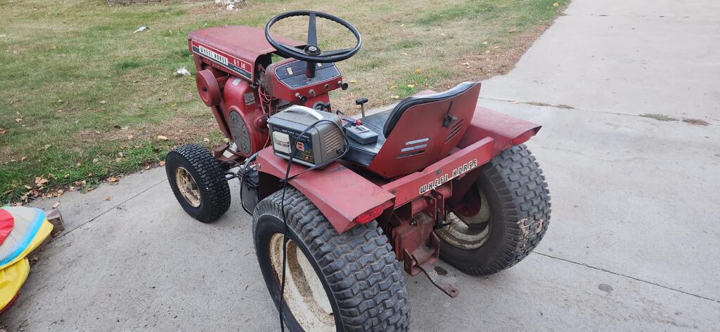

siebenaler 114 #1 Posted October 12, 2024 Well oiled machine? Waiting for some touch up. Got a blower and plow with it. No 3 point. 6 9 Share this post Link to post Share on other sites
Keaton 466 #2 Posted October 13, 2024 not a bad looking unit, run and drive good? 1 Share this post Link to post Share on other sites
WHGuy413 2,851 #3 Posted October 13, 2024 Sure looks like that one has aged very well 1 Share this post Link to post Share on other sites
siebenaler 114 #4 Posted October 13, 2024 Needs a battery so not sure haven't run it yet. 1 Share this post Link to post Share on other sites
