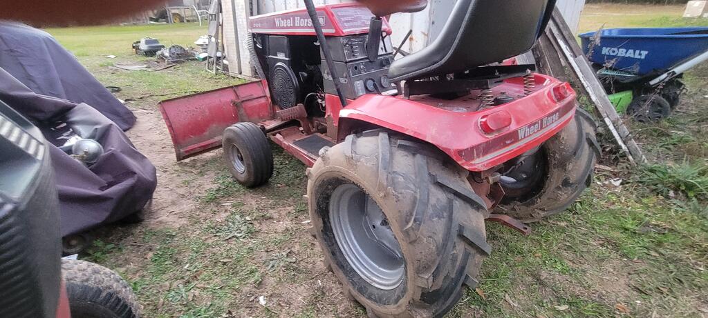

RED-Z06 2,720 #1 Posted October 11, 2024 I guess it was 3 years ago, i got a free 312; it had sat 16 years in a field, it was very rusty, engine was stuck, 8spd was full of water, tires were rotted off. I got it to run, but i spotted some stuff I knew would eventually do her in. The shift levers were eroded to about 3/16" thickness and there wasnt any reasonable way to repair them. Today the shifter shifted its last shift. I really thought the hammering M12 would have been what did it, but no, shes forever in Neutral. Ill save whats good, new tires, wheels, hood, gas tank, hubs, ill pull whats good off the M12. Yes I know "just swap a good 8spd into it". Its not worth it, the 48" blade will look real nice on the 416-H 4 1 Share this post Link to post Share on other sites

RED-Z06 2,720 #9 Posted October 11, 2024 3 hours ago, Pullstart said: So it needs a shifter? It needs a transmission. The set screw has rusted off, cant pull the broken stub out, the hi-lo shifter is holding on by about 20% of the rod thickness. What sucks is, i gave away a C160 rolling chassis last year..the 8spd was mint but i didn't want to pull it because then it wasn't a roller..it was just in the way. 1 Share this post Link to post Share on other sites
RED-Z06 2,720 #10 Posted October 11, 2024 3 hours ago, Pullstart said: Gotcha. Meh. Add some 90 weight in the crankcase and spin’r up! Im tempted to tie off the governor and get far...far away, put the tach on it and see how hard she'll turn before the knock stops. But its still got enough good parts to keep around, stupid part is its got a new rod, piston, rings, governor, carb, and it runs as good as any Kohler ive seen. Its knocked like this for over 2 years and over 140 hours, the oil has 0 metal. 1 Share this post Link to post Share on other sites

RED-Z06 2,720 #12 Posted October 11, 2024 40 minutes ago, Bill D said: I'd see if someone wants that engine. Maybe it can be rebuilt. I've got a couple here like that. I'd like to find new homes for them. I think the knock is the cam gear; i cant imagine its knocked this long, with new parts, and not come apart. Cam gear had a bunch of lash i couldn't get rid of Share this post Link to post Share on other sites
RED-Z06 2,720 #13 Posted October 11, 2024 Heres the knock, after tightening the pulley, and deleting the balance gears. This is with a new rod, piston..sounded the same with the old parts. 1 Share this post Link to post Share on other sites

RED-Z06 2,720 #16 Posted October 12, 2024 On 10/11/2024 at 1:15 PM, kpinnc said: Can you see the throttle butterfly screws? I had one come out and get squashed flat on the head. Thank goodness it was brass. Anyway, it sure had a knock until I figured it out. This was back when you could still get new Kohler pistons and such. I had quite a few dollars invested in that engine. So, the engine was stuck when i got it, it freed up and ran but ran away...it didn't knock though, but I couldn't control the speed. Pulled the engine, a flyweight had come apart..so i pulled the engine bare, new gear put in. Figured..hone the bore and do rings while its apart. After honing, i hot tanked the block, power washed it, 2 cans of brake cleaner. Then assembled it back. Started right up; ran perfectly. After 2 hours, oil was black, and it was starting to smoke, and rattle. After 1 more hour it was knocking. Pulled it back off, heavy piston skirt wear, rings worn, rod measured in spec but barely, crank pin was in spec. New rod, piston, rings, seals, removed balance gears. Ran fine but rattled the same amount. Its knocked ever since. Im sure the rod was close to the small side of tolerance, my measurement tools arent super elite high quality but of the 100+engines ive rebuilt this is the only one ive ever had any problems with. 1 Share this post Link to post Share on other sites
