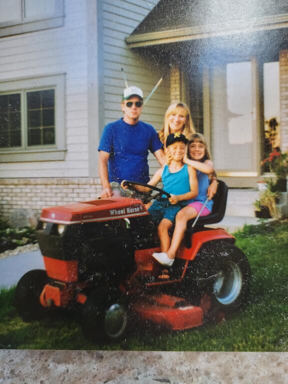

Wheelhorse newb 0 #5 Posted October 7, 2024 Thanks both. Looks like some good options and you are correct, don’t want to fab where no fab is needed. It’s an interesting beast, especially the drive system. Belonged to my now elderly father in law. Attached a pic of it relatively new with him and my wife and two kids. He must have liked the deep dish mag look as he ran it without the rear hub caps Share this post Link to post Share on other sites
