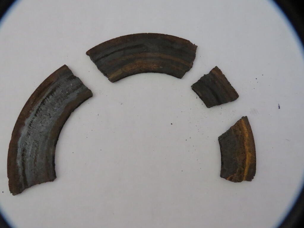

JCD 81 #1 Posted October 4, 2024 Hey Guys, I mowed the lawn yesterday and when I went out this morning I found the two larger pieces on the ground between my right front tire (from the seat) and the mower deck. I checked around and didn't see where they may have come from so I popped the hood and found the two smaller pieces on the ledge at the bottom of the hood. I don't see anywhere they may have come from, does anyone recognize what it was, where it goes and where I might find a replacement. Thanks, Jim 2 Share this post Link to post Share on other sites
cleat 9,333 #2 Posted October 4, 2024 PTO clutch disk (or what is left of it). You need to pull the PTO bell off and you will likely find where these parts came from. 5 Share this post Link to post Share on other sites

JCD 81 #4 Posted October 4, 2024 Thanks, guys I'm not sure if it's an easy fix for someone as mechanically inexperienced as myself but I watched a youtube video and I'll give it a shot. Thanks, Jim 3 Share this post Link to post Share on other sites

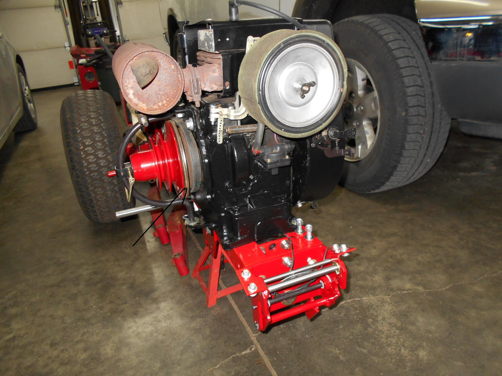

elcamino/wheelhorse 9,363 #5 Posted October 4, 2024 If you find that you can't fix it yourself. Contact K&B (one of our vendors) they sell new, used and rebuilt PTO bells and the clutch disk . 2 1 Share this post Link to post Share on other sites
MainelyWheelhorse 3,133 #6 Posted October 4, 2024 (edited) Amazon has the clutch disk as well. That’s where I got my replacement. YouTube has some good video’s that can help with disassembly and the reinstall. The YouTuber snowrulesnate does a good one. It’s for a 520 -H but PTO clutch wise it’s the same process. Edited October 4, 2024 by MainelyWheelhorse 1 1 Share this post Link to post Share on other sites
8ntruck 9,305 #7 Posted October 5, 2024 Your local Toro dealer can get you a clutch disc, too. Kind of pricy, though. If memory serves me right, there are 4 bolts holding the disc drive pulley. pulley. While you have the clutch apart, check the bearings in the bell. There are 2 ball bearings for the stub shaft and one roller bearing that runs on the crankshaft. Clean and lube the roller bearing with a high temp grease such as Lucas Red n Tacky. Use just enough to coat the rollers - too much and it will get into the friction material on the clutch - not good. If the ball bearings have a rubber seal, you can gently remove the seals with a small screw driver, to clean and grease the bearings. Use the same grease as the roller bearings, then replace the seals. Good luck and have fun. Share this post Link to post Share on other sites
peter lena 10,070 #8 Posted October 5, 2024 @JCD clutch is telling you of impending related bearing issues , if the pto lever engagement is a rough / squealing start , thats your relation to clutch / heat , cracking failure , agree with @8ntruck on the simple bearing clean out and re greasing . my decks spin / move by hand at the pto down drive to deck point , by hand . its the COLLECTIVE PULLY DRAG that cooks that clutch . as stated typical related bearings have wide rubber side shields , small putty knife , pocket flat screwdriver , lets you easily clean out original lube , carb cleaner flush out , re grease to same ammount , with a hi temp lucas chassis grease . having done , my 3 decks / drive set up , no noise or issues , pete Share this post Link to post Share on other sites
Brockport Bill 2,478 #9 Posted October 5, 2024 7 hours ago, peter lena said: @JCD clutch is telling you of impending related bearing issues , if the pto lever engagement is a rough / squealing start , thats your relation to clutch / heat , cracking failure , agree with @8ntruck on the simple bearing clean out and re greasing . my decks spin / move by hand at the pto down drive to deck point , by hand . its the COLLECTIVE PULLY DRAG that cooks that clutch . as stated typical related bearings have wide rubber side shields , small putty knife , pocket flat screwdriver , lets you easily clean out original lube , carb cleaner flush out , re grease to same ammount , with a hi temp lucas chassis grease . having done , my 3 decks / drive set up , no noise or issues , pete there is a U shaped snap ring i recall - - might be a challenge if you have not removed one previously 1 Share this post Link to post Share on other sites
8ntruck 9,305 #10 Posted October 5, 2024 . There are "C" rings holding the bearings the bearings in. You will need a pair of "C" ring pliers to make the job easier. Share this post Link to post Share on other sites
peter lena 10,070 #11 Posted October 5, 2024 @Brockport Bill , @8ntruck some KROIL and snap ring plyers make quick work of those snap rings , once yo do this set up once . the next ones are much easier . that lubrication upgrade also made me look for same pulley/ size type , but with a larger bearing , that could be repacked and also be refitted with a 3/8" press in insert , typically going from a 5/8 larger bearing bolt , to a 3/8 bolt bushing , for a wheel horse set up , paint it red , and its hiding in plane sight , but its solidly smooth / solid . just a thought . pete Share this post Link to post Share on other sites
