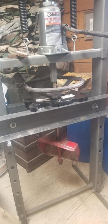

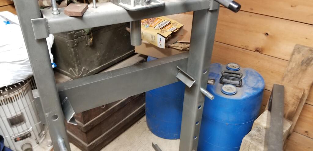

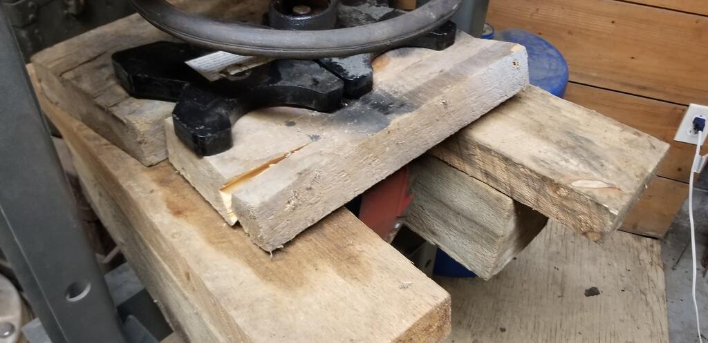

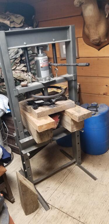

gt14rider 1,223 #1 Posted October 1, 2024 Hi all, trying to get the steering wheel of the shaft, won't fit on press. (don't know if this modification has been before) So tried to block it up, not happening, broke the block, so cut the cross beam and bolted it back together. Worked great, sounded like a gun going off when it popped 5 5 1 Share this post Link to post Share on other sites

gt14rider 1,223 #4 Posted October 1, 2024 Also used the press to remove the rear pin. I put the transmission on a engine stand, tuned to the side, removed cross bar pushed in to press, got a long piece of pipe (bigger around than the rear pin) put it on down side of case, used a small pin and pressed it out. 3 Share this post Link to post Share on other sites

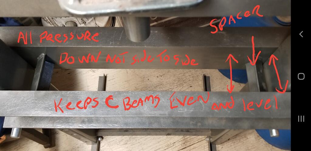

adsm08 4,749 #5 Posted October 1, 2024 I'm not sure I'm in love with that idea. I admit that press is really narrow, but I don't know how I'd feel about cutting that beam and bolting it together. I've had mine maxed a few times. 2 Share this post Link to post Share on other sites

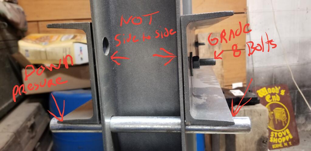

ebinmaine 79,521 #7 Posted October 1, 2024 2 hours ago, adsm08 said: I'm not sure I'm in love with that idea. I admit that press is really narrow, but I don't know how I'd feel about cutting that beam and bolting it together. I've had mine maxed a few times. I can see your logic there. In principle I'd agree.... But these presses are .... well.... cheaply made. I'd almost feel better if there was a couple USA made Gr8 bolts with correct washers and locking nuts than trust the original tiny welds on the cross beam connector. 1 Share this post Link to post Share on other sites

gt14rider 1,223 #11 Posted October 2, 2024 All the load is on the C beams, not the spacers/bolts. If you twist the beams that much, You are going to need a bigger press. 1 2 Share this post Link to post Share on other sites
