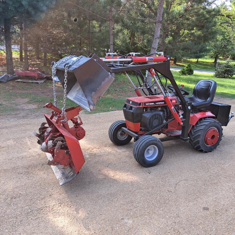

WHX?? 56,599 #9 Posted September 26, 2024 (edited) 1 hour ago, jeremi3210 said: this deck is heavy!!! Lol. of you busting yer stones trying to move it! This is why we have FELs ... Edited September 26, 2024 by WHX?? 2 Share this post Link to post Share on other sites
jeremi3210 744 #10 Posted September 26, 2024 7 minutes ago, WHX?? said: of you busting yer stones trying to move it! This is why we have FELs ... Nice tiller! Lol! I just hook it on my d and move that! Share this post Link to post Share on other sites

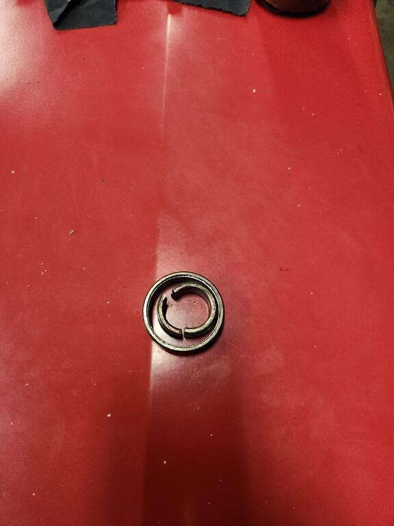

jeremi3210 744 #11 Posted September 26, 2024 Thought she was getting loud, this was the only one that felt bad but I don't piss around and they are all gunna get done. No damage on this spindle other than the bearing! Hopefully I won't find any surprises! 1 1 Share this post Link to post Share on other sites
ri702bill 12,110 #12 Posted September 26, 2024 Lower bearing, most likely?? No damage to the housing as the seals & balls did a rapid exit?? Check the spindle too for damage..... 1 Share this post Link to post Share on other sites
WHX?? 56,599 #13 Posted September 26, 2024 1 hour ago, ri702bill said: Check the spindle too for damage..... He won't but his boy will... he's a pretty good half assed mechanic and better than his old man... Say your sized lawn you should have a z turn ... i have for sale a green and ... nevermind... 1 Share this post Link to post Share on other sites
jeremi3210 744 #14 Posted September 26, 2024 (edited) 2 hours ago, ri702bill said: Lower bearing, most likely?? No damage to the housing as the seals & balls did a rapid exit?? Check the spindle too for damage..... Yes the lower bearing. Everything Looks good, the balls.and seal actually were still there, caught it just at the right time. Edited September 26, 2024 by jeremi3210 1 Share this post Link to post Share on other sites
