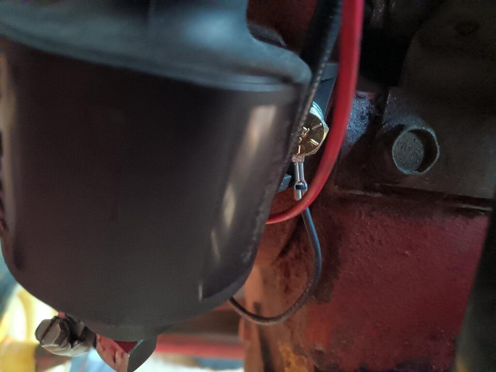

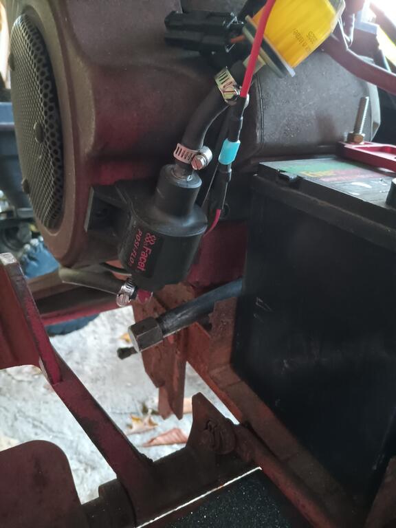

glenn27 71 #19 Posted October 22, 2024 Ok-good day again..Finally rounding back around to the Wheelhorse repair... Question now-have the electric pump in hand-looks like they want to mount it at a 45 degree angle down on a frame rail maybe, and close to the fuel tank. Options Are pretty crowded on this tractor. |Can anyone post me some pictures where they mounted theirs?? I'll go out and sit down on my stool and rattle brain on it more tomorrow. Thanks in advance- glenn Share this post Link to post Share on other sites
ebinmaine 72,267 #20 Posted October 22, 2024 I have mine bolted directly to the side of the engine. Not sure if I'm going to leave it there long-term. There are folks that say the vibration from the engine could be harmful to the fuel pump. Share this post Link to post Share on other sites
glenn27 71 #21 Posted October 22, 2024 That is what I was thinking also-about the vibrations over a long period. Also thought about on the right side-mounting down low on the belt shield-but same concern about vibrations. glenn 2 Share this post Link to post Share on other sites
