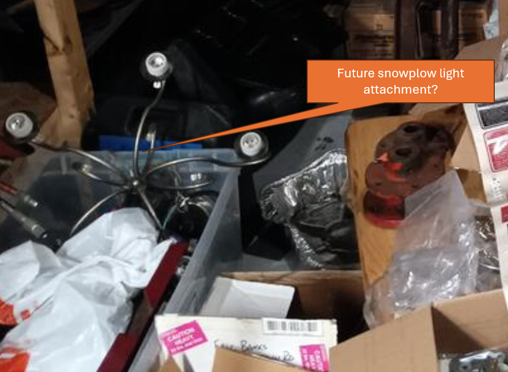

Retired Wrencher 6,989 #56 Posted October 22, 2024 On 10/14/2024 at 8:28 PM, ebinmaine said: Ya know. You'd think a guy like @WHX?? that has a BUNCH of Wheelhorses would have a parts dept. (Don't mind the mess while we move our workshops and parts storage) Man Eric you got stuff.I am sure it comes in handy tho. 1 Share this post Link to post Share on other sites
ebinmaine 80,740 #57 Posted October 22, 2024 2 minutes ago, Retired Wrencher said: Man Eric you got stuff.I am sure it comes in handy tho. And that's only one of SEVERAL areas..... 2 Share this post Link to post Share on other sites
Retired Wrencher 6,989 #58 Posted October 22, 2024 Good for you! Man and his parts. 1 Share this post Link to post Share on other sites

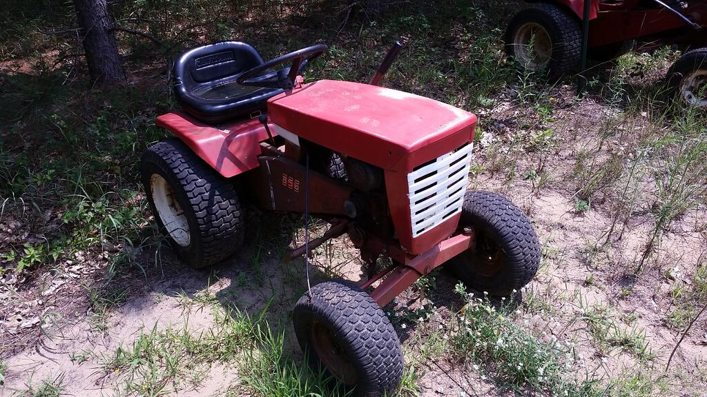

WHX?? 58,149 #59 Posted December 16, 2024 Been having problems with this girl and haven't worked on it in awhile. @Achtocome over to scrounge parts and we tinkered with it for abit. It started and ran but wouldn't throttle up and run with out choke. Carb right?? I had put an offshore on it so we just thought I got a bad one. Fuel pump checked good. Dug the original Carter out of the cleaner and put a carb kit on it. Did the same thing no throttle but idled great. Just for grins put a different condenser on it and runs great. Might just throw the offshore on it to see if indeed that's what it was. 5 2 Share this post Link to post Share on other sites
ebinmaine 80,740 #60 Posted December 16, 2024 5 hours ago, WHX?? said: Just for grins put a different condenser on it and runs great. Might just throw the offshore on it to see if indeed that's what it was. I'd bet it runs fine then too.... Share this post Link to post Share on other sites
Achto 32,729 #61 Posted December 16, 2024 8 hours ago, WHX?? said: Just for grins put a different condenser on it and runs great Nice find !!! Sometime ya get lucky when you throw darts at em. 3 1 Share this post Link to post Share on other sites
Bar Nuthin 3,246 #62 Posted December 16, 2024 On 10/14/2024 at 8:28 PM, ebinmaine said: Ya know. You'd think a guy like @WHX?? that has a BUNCH of Wheelhorses would have a parts dept. (Don't mind the mess while we move our workshops and parts storage) 5 Share this post Link to post Share on other sites
ebinmaine 80,740 #63 Posted December 16, 2024 8 minutes ago, Bar Nuthin said: Yeah. Yeah that's it. Definitely. 3 Share this post Link to post Share on other sites

Lane Ranger 12,107 #65 Posted December 16, 2024 Jim: I am glad you are saving this 856! Over the years I have bought three 856's and each one for $350. Also sold them for $350. But each one was a great tractor and in what I would call original patina condition. I really regret not keeping one of these as they were a good all around Wheel Horse model. Not sure how many of these Wheel Horse sold but it must have been a lot and they were surely prized by their owners from the ones I have seen over the years. It is a very good thing you did -not passing this one up!!! 1 1 Share this post Link to post Share on other sites
WHX?? 58,149 #66 Posted December 16, 2024 Absolutely Lane ... Bret Esse of the Portage show sold me a trailer load of horses at a real good price and there was a 856 on it. I just rolled it off the trailer and there it sat outside unloved for a couple of years. I have a 857 so gave it to Dan and he got got it running without much effort. One fine little tractor. We named it Pale Face ... 1 1 4 Share this post Link to post Share on other sites
Achto 32,729 #67 Posted December 16, 2024 And right now it's on Christmas duty. 3 1 3 Share this post Link to post Share on other sites
953 nut 69,351 #68 Posted December 17, 2024 20 hours ago, WHX?? said: Just for grins put a different condenser on it and runs great. Jim, I bet I have posted this information fifty times over the years. If an engine idles well, but runs erratically when revved up, like it hits and misses, pops and backfires, then chances are, it needs a new condenser/capacitor. And always install a condenser/capacitor with the wire facing downward so rain water and/or when washing off engine, water will not enter inside condenser/capacitor, ruining it. With water inside the condenser, this will also allow it to idle well, but cause it to run erratically when revved up. 2 1 Share this post Link to post Share on other sites
WHX?? 58,149 #69 Posted December 17, 2024 (edited) Yep and Dan told me that too moons ago ... it finally stuck ... BTW this girl sat outside with no hood. and the wire pointing up. The problem with the wire pointing down is wire length seldom allows it. Edited December 17, 2024 by WHX?? 2 Share this post Link to post Share on other sites
