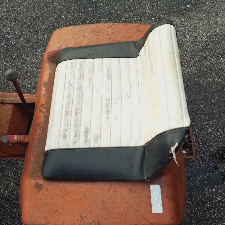

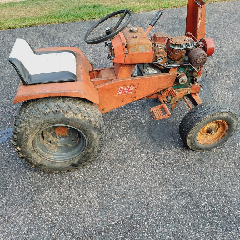

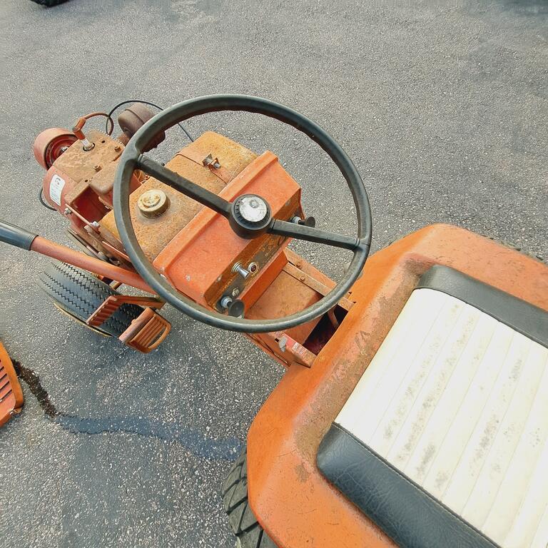

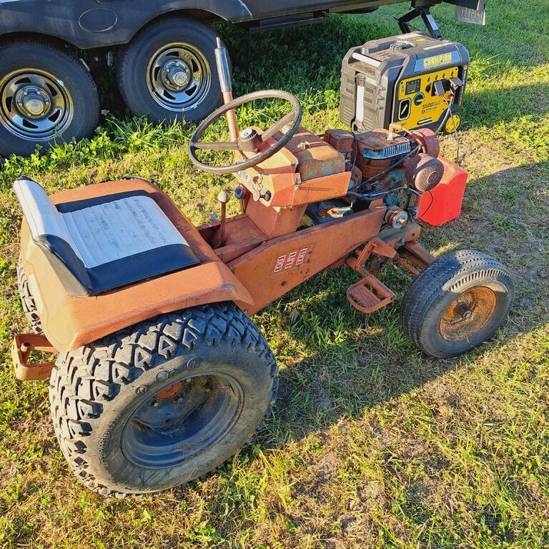

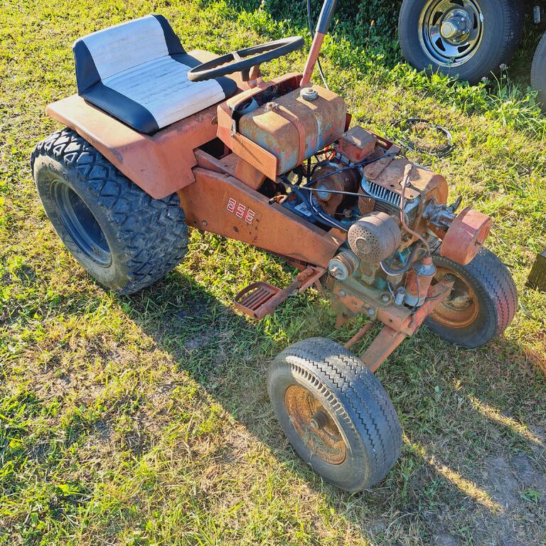

WHX?? 58,143 #1 Posted September 12, 2024 (edited) This one sitting in a field rotting away. So I rescued it. Tractor heavy and already have a 856 that needs love and I can't seem to give away. Saw it at a show several weeks ago and it was sitting there crying save me save me. I jokingly offered the owner a frankie for it and much to my surprise he took it. Motor was locked up so pulled it back to camp for a look see. @Achto @Wild Bill 633 and I commenced to wrenching to find out the motor is free but the SG is tight. Got it loosened up and messed with the points. Exhaust valve stuck open ... pop the head and free that up. Fired right off and drives. Service motor and seller says he has the original I could have but knowing him doubt I'll see it. Four year old Battery was stone cold dead... not a volt in it. Threw it on a charger and it did take a charge and seems to be holding it. Surprise surprise. Tires are abit needy but nothing serious. Best part everything is there, original cigar lighter woo hoo, and fairly unmolested. On the splash pad ready for a bath... sheet metal really straight. Seat & hitch worth the price of admission... Edited September 12, 2024 by WHX?? 4 22 Share this post Link to post Share on other sites

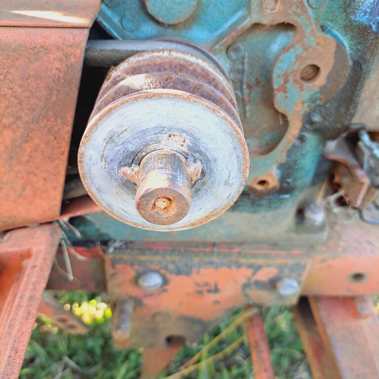

WHX?? 58,143 #2 Posted September 12, 2024 (edited) The Debby Downer ... Dan mumbled something about a set screw but doesn't appear to have a keyway??? Any thoughts on why a service motor wouldn't have one? Edited September 12, 2024 by WHX?? 2 2 1 Share this post Link to post Share on other sites

Retired Wrencher 6,989 #7 Posted September 12, 2024 Jim as fellow 856 owner that seat is the price of admission. Looks savable. Just take your time with it dry it out in a sunny room put some leather conditioner on it and re-pad if needed. I hope you put some time into this one. I did this one this year. 1 7 Share this post Link to post Share on other sites

Mike'sHorseBarn 3,681 #10 Posted September 12, 2024 Great score for a benny! If it was me I probably would get it mechanically right and leave it in the rough. 2 1 Share this post Link to post Share on other sites
WHX?? 58,143 #11 Posted September 12, 2024 2 hours ago, Retired Wrencher said: that seat is the price of admission. Seller mentioned that he has 150 in the seat. Thought is Wrencher after the EB check list is to put a eight inch plow on it and use it for a house tractor at plow day since I sold the no '73 name 8 I had set up. If that happens yah the seat will get swapped out for a beater. Either way it will probaly go on a resto or a more refined tractor. 19 minutes ago, peter lena said: splash pad or oil down It will get a gentle power washing. The tunnel is filled with dirt and crap but after that just something for the to die for patina. Fer sure leave it rough Mike. Paint has never been messed with. I shoulda got a pic before we moved it. Grass and weeds growing up thru it and filled with grass clippings. Choke and throttle froze up solid so saving those is going to be work. 5 Share this post Link to post Share on other sites

Handy Don 17,474 #13 Posted September 12, 2024 (edited) 14 hours ago, WHX?? said: Any thoughts on why a service motor wouldn't have one? Possibly a Woodruff hidden by the wide 3-gang pulley? Slop/wear caused the “hack spot weld” solution? Edited September 12, 2024 by Handy Don Share this post Link to post Share on other sites
Achto 32,715 #14 Posted September 12, 2024 (edited) I'm not usually one who likes to be wrenching while at a show, but this was a fun project. Once we knew the engine was free, I inspected the fuel system to find that it was dry & clean. Given these facts I knew that with a little "field triage" we would be able to get it running. Open cylinder head surgery is usually not recommended in the field, but in this case it was worth the risk. Was great to see the look on the PO's face when Jim drove it by him. Edited September 12, 2024 by Achto 4 2 6 Share this post Link to post Share on other sites

953 nut 69,341 #21 Posted September 13, 2024 On 9/11/2024 at 9:17 PM, WHX?? said: The Debby Downer ... Dan mumbled something about a set screw but doesn't appear to have a keyway??? Any thoughts on why a service motor wouldn't have one? Check out the Spec. Number on the engine, could be a pump/generator engine with a tapered shaft that a PO put s kit on. Looking at the end of the crank shaft in your photo it looks that way to me. 3 Share this post Link to post Share on other sites
WHX?? 58,143 #22 Posted September 13, 2024 3 hours ago, 953 nut said: Check out the Spec. Number on the engine, Have yet to run that number but will do Richard. Would like to grind off them welds and check it out as the pulley could go in another 1/8. Not serious tho and if it ain't broke don't fix it I guess. 2 Share this post Link to post Share on other sites

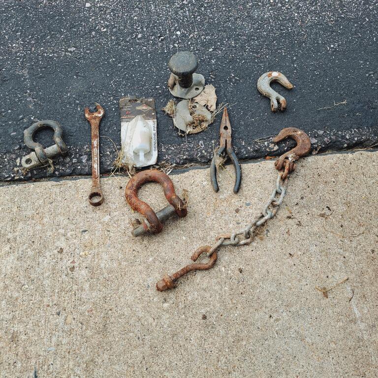

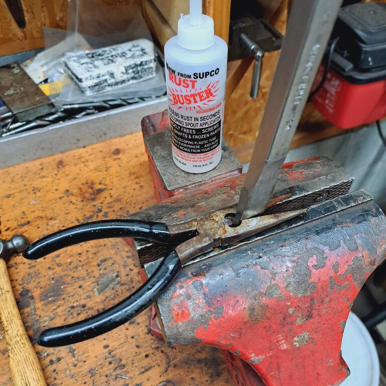

WHX?? 58,143 #23 Posted September 14, 2024 (edited) Spec # checks out as a ... they used the original shroud. Short block maybe? Just keeps gettin better... Found this under seat debris... regular freakin hardware store there... Now I gotta see if I can save the rusted tight needle nose... Whatthehellisthematta with a clown like me... Edited September 14, 2024 by WHX?? 1 2 5 Share this post Link to post Share on other sites
wallfish 20,618 #24 Posted September 14, 2024 7 minutes ago, WHX?? said: Now I gotta see if I can save the rusted tight needle nose. What's up with that rust buster? Does it work? Or just the same as oil? Share this post Link to post Share on other sites
WHX?? 58,143 #25 Posted September 14, 2024 (edited) 3 minutes ago, wallfish said: What's up with that rust buster? Does it work? Or just the same as oil? Dunno first I ever used it... fell off the truck when I was workin... It's definitely not just oil. Edited September 14, 2024 by WHX?? Share this post Link to post Share on other sites
