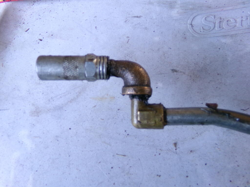

Ed Kennell 47,948 #2 Posted September 8, 2024 I find adding two 1/8" NPT street ells to my grease gun gives me a lot of options on hard to reach zerk fittings. They are just snug so I can rotate the coupler in both axis. 9 Share this post Link to post Share on other sites
