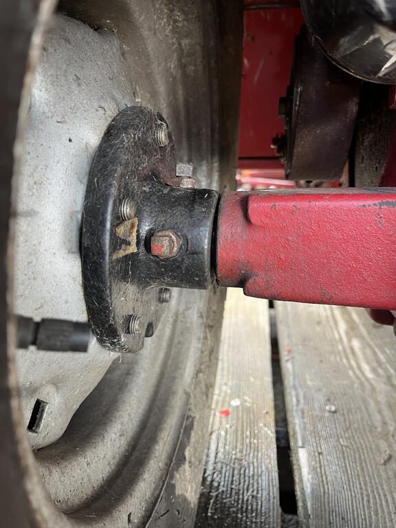

Rockcrawler69 15 #1 Posted September 7, 2024 Hello, New to the forum. Love the wealth of information here. I picked up a new to me 520H last night. Crawling around it I noticed the left hub is farther away from the axle housing than the right. I believe the left has been replaced, it’s black so different color than stock. Is this spacing ok or is there a way to tighten that up? Share this post Link to post Share on other sites
953 nut 69,401 #2 Posted September 7, 2024 There is very little space between the axle and hub on an Eaton transaxle, yours look about correct to me. 1 Share this post Link to post Share on other sites

lynnmor 9,042 #4 Posted September 8, 2024 The 520H tractors have a plastic spacer because the hub runs so close to the transmission. When you install a hub, leave a bit of clearance. I think that I see an uneven amount of clearance on your black hub, it may be just the camera angle, jack it up and see if there is some up and down movement of the tire, there should be next to nothing. 1 Share this post Link to post Share on other sites
Bill D 3,156 #5 Posted September 8, 2024 Looks like the plastic spacer is missing. 3 Share this post Link to post Share on other sites
Ed Kennell 47,384 #6 Posted September 8, 2024 to the Like Lynn noted, the black hub does appear to have an uneven gap with the axle housing. I would remove the wheel and hub and inspect the axle for damage and try to determine why the hub was replaced. 1 Share this post Link to post Share on other sites
Rockcrawler69 15 #7 Posted September 8, 2024 Thank you. Yes, the black hub is uneven. I’ll jack it up and check. 1 Share this post Link to post Share on other sites

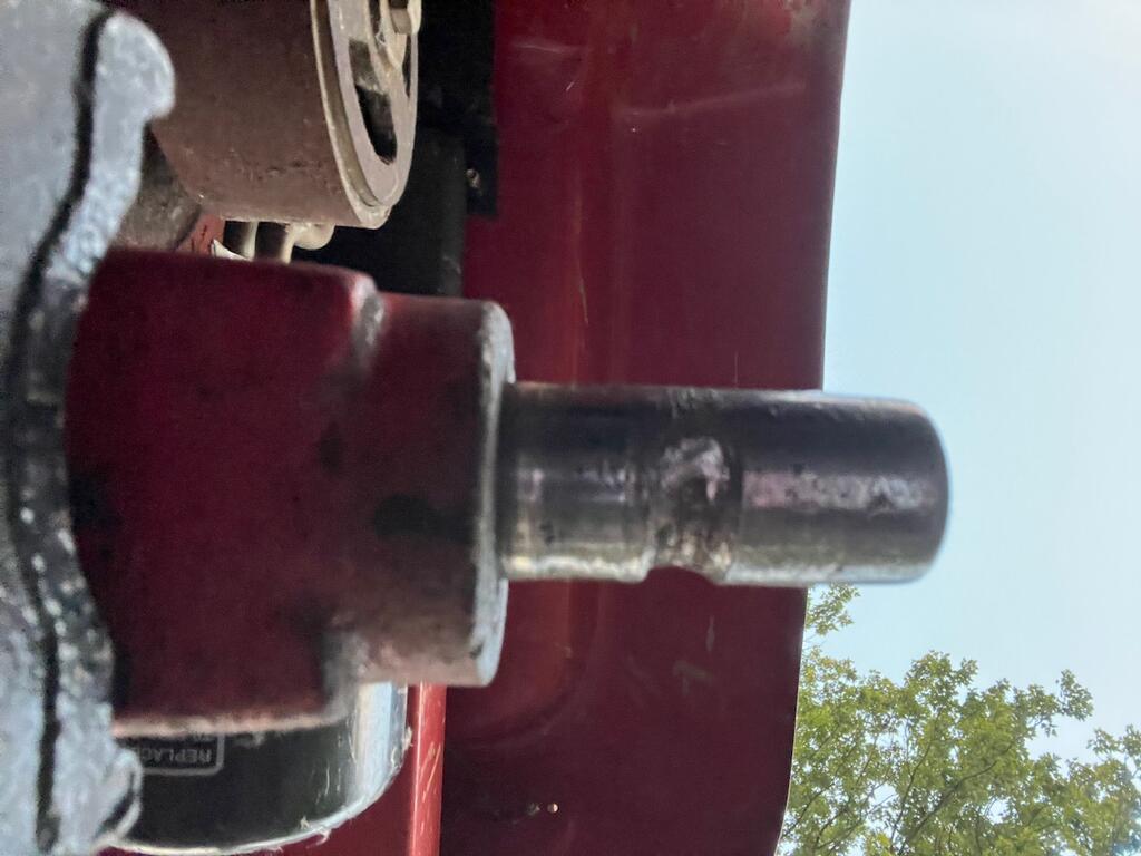

Rockcrawler69 15 #8 Posted September 8, 2024 Definitely excessive play on the black hub! IMG_8661.mov 1 Share this post Link to post Share on other sites

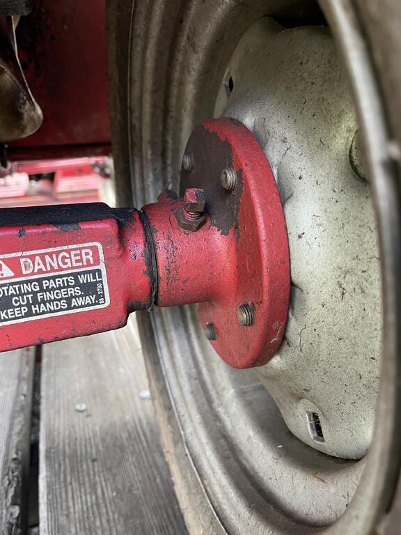

Rockcrawler69 15 #9 Posted September 8, 2024 (edited) The red one moves about half as much… Edited September 8, 2024 by Rockcrawler69 1 Share this post Link to post Share on other sites
Ed Kennell 47,384 #10 Posted September 9, 2024 (edited) Afraid you need two new hubs and or axles. Maybe you'll get lucky and find some "mechanic" installed 1 - 1/8" hubs an 1" axles and the axles are not ruined. The good news...removing the hubs should be easier than normal. Edited September 9, 2024 by Ed Kennell 1 Share this post Link to post Share on other sites

Lee1977 7,782 #14 Posted September 10, 2024 On 9/8/2024 at 8:31 PM, Ed Kennell said: Afraid you need two new hubs and or axles. Maybe you'll get lucky and find some "mechanic" installed 1 - 1/8" hubs an 1" axles and the axles are not ruined. The good news...removing the hubs should be easier than normal. Ed I believe that all 1100 Eatons came with 1 1/8" axles and eight pinon rear differential.. Share this post Link to post Share on other sites
Ed Kennell 47,384 #15 Posted September 10, 2024 5 hours ago, Lee1977 said: Ed I believe that all 1100 Eatons came with 1 1/8" axles and eight pinon rear differential.. Yes, they did. but I wonder if that is an 1100. It's just hard to imagine they can be worn enough to be that loose. I've seen and repaired some bad hubs and axles but usually the keyways are just wallowed out. Share this post Link to post Share on other sites
lynnmor 9,042 #16 Posted September 10, 2024 3 minutes ago, Ed Kennell said: Yes, they did. but I wonder if that is an 1100. It's just hard to imagine they can be worn enough to be that loose. I've seen and repaired some bad hubs and axles but usually the keyways are just wallowed out. Never underestimate the abilities of the current crop of "mechanics". 1 Share this post Link to post Share on other sites

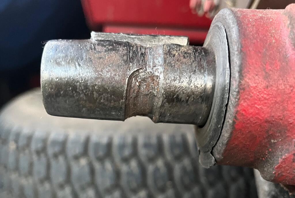

Ed Kennell 47,384 #21 Posted September 13, 2024 1 hour ago, Rockcrawler69 said: Ed Kennell how does one tell if it’s an 1100 reared, aside from measuring the axle shafts? I’m hoping to tear into it this weekend and I’ll take some pictures as I go… Like Lynn said, all 520Hs came with the Eaton 1100. Yes, we are very interested to see the condition of the hub IDs and axle ODs. 1 Share this post Link to post Share on other sites
Bill D 3,156 #22 Posted September 13, 2024 3 hours ago, Ed Kennell said: Like Lynn said, all 520Hs came with the Eaton 1100. Yes, we are very interested to see the condition of the hub IDs and axle ODs. Agreed. Hopefully any damage is limited to the hub and not the axle. Share this post Link to post Share on other sites
Rockcrawler69 15 #23 Posted September 17, 2024 Well Ed Kennell called it. 1 1/8 hub on the one inch axle. Share this post Link to post Share on other sites
