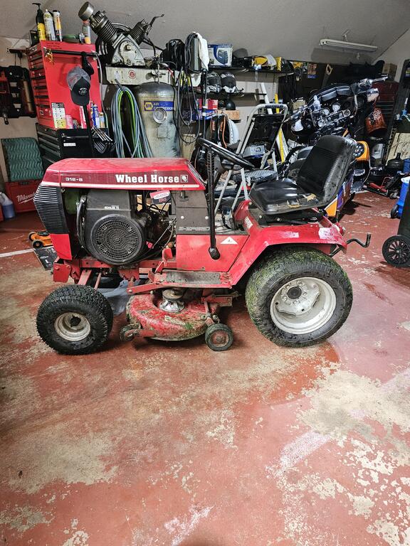

salinfantino@mail.com 2 #1 Posted September 7, 2024 Looking for a mower deck belt for my 312-8. There is a i.d. number on the deck but I can't read it worn off. By what I'm seeing after searching I have a 37" side discharge deck and I think the part number for the belt is 111178. Can someone tell me yes or no or give me the correct belt size. Thanks in advance. Share this post Link to post Share on other sites

peter lena 10,013 #4 Posted September 7, 2024 @salinfantino@mail.com those 37 inch decks are usually hooked up to a rear bagger set up ,from related picture , be a good idea to drop the deck , inspect it for build up , clean it out , let it dry , and verify how easily the belt driven pulleys move , that type of deck is known for problems , luckily other W/H decks will hook right up , your set up is known for deck cracking and rot build up , nothing sarcastic in my response , other decks are available in both side and rear discharge . pete 1 Share this post Link to post Share on other sites

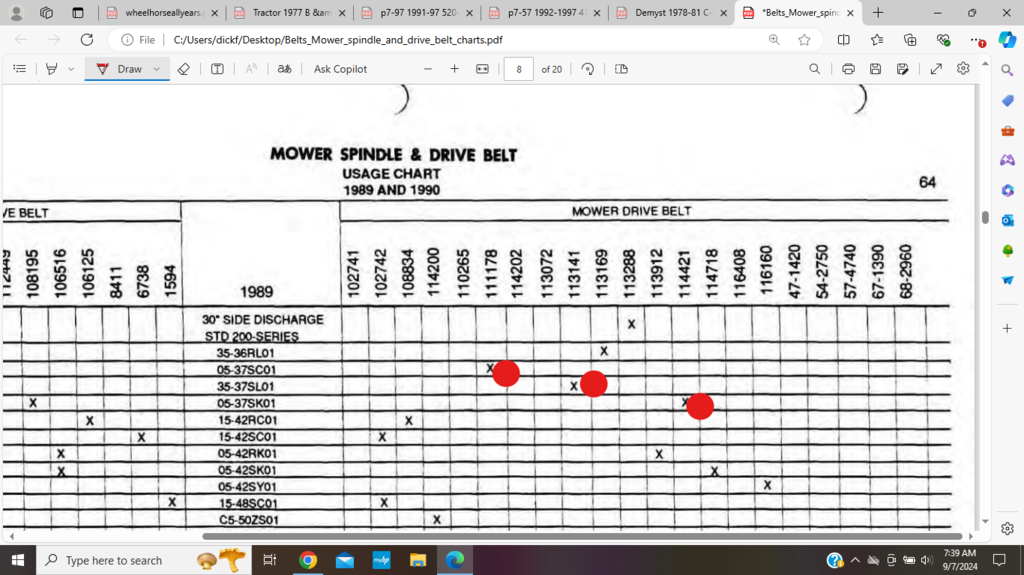

gwest_ca-(File Mod) 12,450 #5 Posted September 7, 2024 Drive belt 111178 (1/2" x 140.5") Six-sided double-V belt [265-001 Stens] Deck model 05-37sc01 The 05-37SC02 deck used a regular 4-sided belt with flat idler pulleys for the back side of the belt. Drive and spindle belt 110265 (1/2" x 141.00") 1 Share this post Link to post Share on other sites
