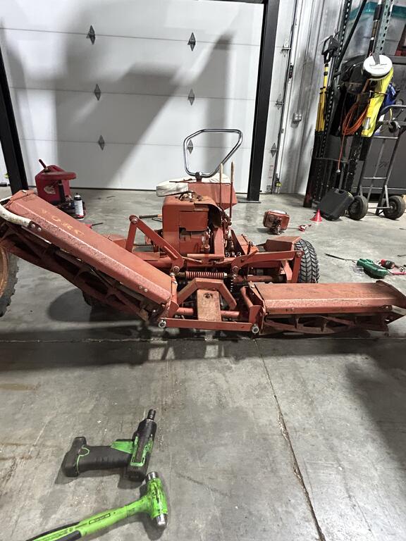

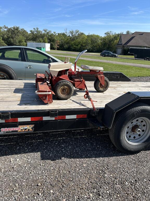

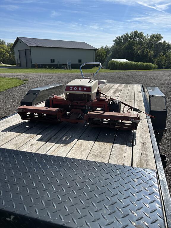

Keaton 465 #1 Posted September 3, 2024 yesterday afternoon I went to get a tractor I guess you could call it off Facebook market, and I got there and went to take a look at it and it was a lot smaller than I thought, it is a 1965 toro professional 58 in cut reel mower, it has 2 bat wing reels in the front, it runs ok, carb leaks and needs rebuild and tank has crap in it, but pretty simple, I had it running for a good 2 minutes playing with the choke. its neat looking and I got pictures of the manual because he had the toro dealer book, he only had one horse a suburban that he would not let go of and a few springfeild type toros, he had over 100 tractors in a barn down the road I have not seen them yet but I want to buy a reel mower a push one he has also. but enough of that I'll get a few pics of it and it has a big crack in the hood. its plastic so we can plastic weld it. and the back wheel folds in for a storage mode I guess, I will add pics after I get home I just have 3 now. 7 2 Share this post Link to post Share on other sites
peter lena 9,227 #2 Posted September 3, 2024 @Keaton looks good to me, lots of steel in that one , might try running that in on a seperate gallon of heavily treated gas . carb bowl is probably loaded with debris . those reel mowers were very stout , get after the , linkage ends , moving mount areas , penetrating oil first , for creeping action , then red aerosol spray grease , extension tube for detailing. neat project , pete 1 Share this post Link to post Share on other sites

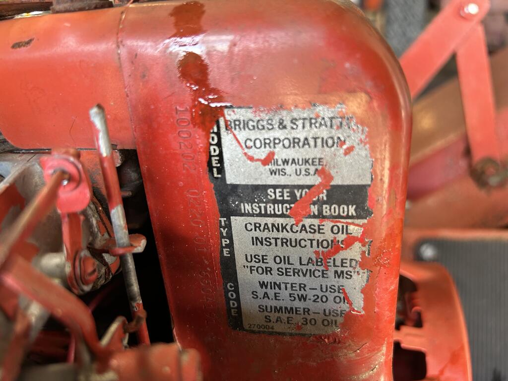

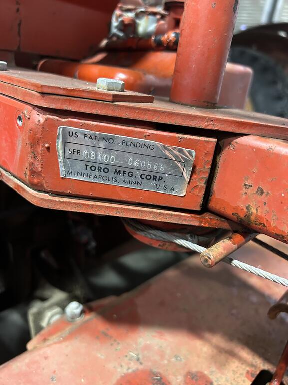

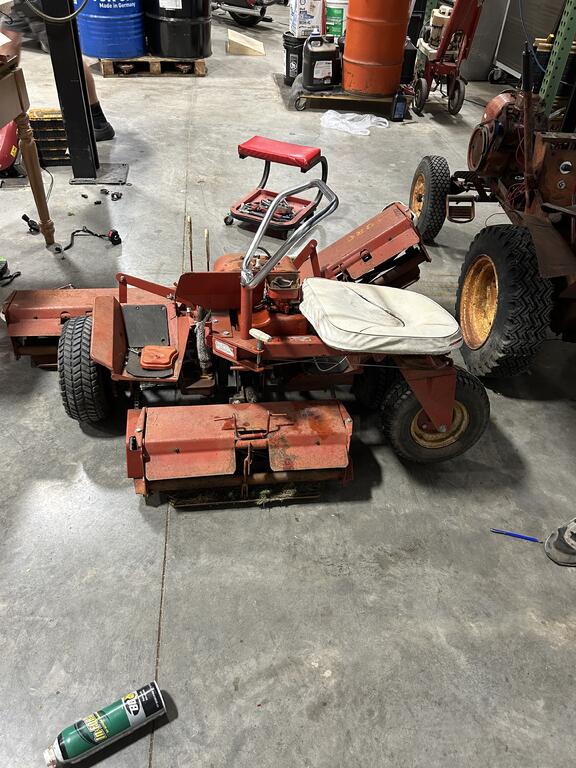

Keaton 465 #3 Posted September 3, 2024 Thanks Peter I got a few more pics and a few of it in “storage mode” and the mower ID and the engine ID 5 Share this post Link to post Share on other sites

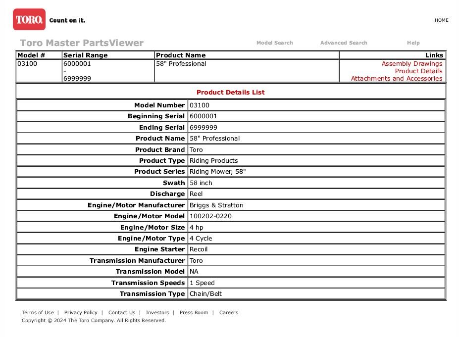

gwest_ca-(File Mod) 11,426 #4 Posted September 3, 2024 Suspect Toro uses 58" Professional as a model name. Do you have the model number? Possibly 03100? Share this post Link to post Share on other sites
Keaton 465 #5 Posted September 3, 2024 @gwest_ca I just put the tractor ID tag and engine one it may have not updated on your end yet Share this post Link to post Share on other sites

gwest_ca-(File Mod) 11,426 #7 Posted September 3, 2024 Can't find anything on the 03100 which is 4hp. Found this on the 03102 which has a larger engine. https://www.partstree.com/models/03102-toro-58-professional-reel-riding-mower-sn-007000001-007999999-1967/ 1 Share this post Link to post Share on other sites

Keaton 465 #10 Posted September 4, 2024 14 hours ago, peter lena said: NAPA has a very good chain / cable lube MACS # 1370 , would be perfect on that , like lucas chassis grease , shell rotella oil .30 wt I have a good lube and chain lube and I got some of that tacky red greese I will lube it all 15 hours ago, Joe Shmo said: That is awesome. thank you, it is pretty neat 15 hours ago, gwest_ca said: Can't find anything on the 03100 which is 4hp. I cant find anything on it, does not show the model on parts tree either. 12 hours ago, C-85 said: This is a great machine to have, I guess this is the older version of the zero turn! that was my guess alsom I need to change the oil and lube it then I should be good to go try it out. and I'm shure I'll make new friends with a flat file because I want to go buy another reel mower from the same guy that had 2 reel mowers that attach to it. so I got the tank cleaned out last night with solvent and BBs it took 4 tires but I was happy, the carb gas pickup tibe was clogged bad, I got it cleaned and put all back together, and of course my luck the recoil spring broke. and I had another engine that was parts that was all taken apart so I took the spring from that and put it in the toro second try the first time it was not wount up enough, I got it though on my first try unlike my lawn ranger recoil, I took the head off because how bad the inside of the carb was and blew the dirt and crap out, and cleaned under the head, and I did not the patience till wait to Saturday for new gaskets so I made my own, they should do for now. I'll work on it more today and I think my dad is going to plastic weld the hood for me because it was cracked down the middle pretty bad. that's all for now, thanks for the help, -Keaton Share this post Link to post Share on other sites
gwest_ca-(File Mod) 11,426 #11 Posted September 4, 2024 Looks like Toro thinks they used a 7-digit serial number Share this post Link to post Share on other sites
Keaton 465 #12 Posted September 4, 2024 @gwest_ca I found the manual and parts list so I have that now I forgot to look on the toro website, dumb of me but after school I plan to get it running Share this post Link to post Share on other sites

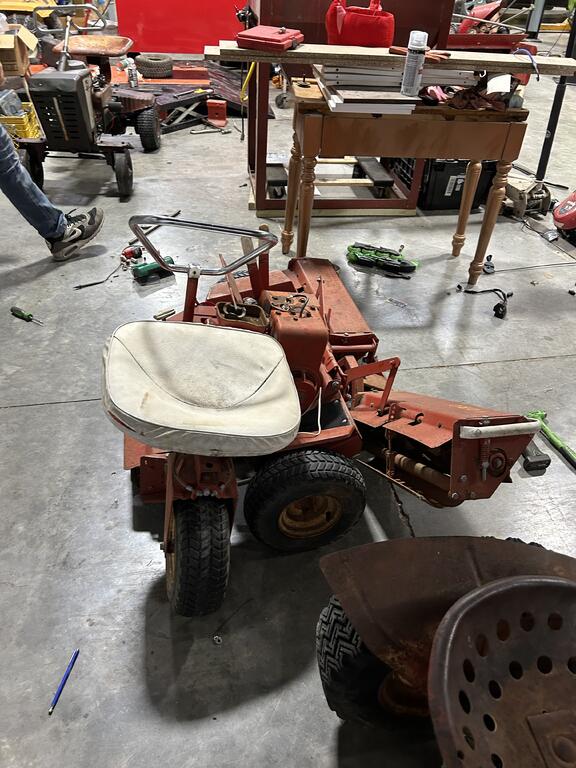

Keaton 465 #13 Posted September 5, 2024 I got myself in a pickle again, like always like a bad habit that comes back around I cant ever figure out throttle linkages, I have never been able to, I doubt anyone can really help me on here I may reach out to a few more local small engine shops after tomorrow night if I cannot figure it out. don't have any pictures that are worth a darn so, I gotta to try to figure it out, in the mean time I greesed and lubed the machine and changed oil because it was low and miky last time 1 Share this post Link to post Share on other sites
peter lena 9,227 #14 Posted September 7, 2024 @Keaton like 3-1 orange can penetrating oil , very good on cabling / throttle / choke , take advantage of any higher starting spot , letting it creep on its own , to lower areas , might even add a small extension spring to end point cable hook up , having spring constantly pull toward closure , thats like a power cable pull assist , have that on all my throttle / choke set ups . also love KROIL penetrating oil , pete Share this post Link to post Share on other sites
